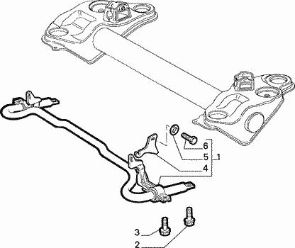

Phil R said:
Hello,
Anyone out there ever fitted a replacement kit to the rear trailing arms ?
If so was it straight forward
Regards,
Phil
Are you talking about the trailing arm pivot bush?
If so I've done two on a Tipo and the design looks very similar. You'll need various size sockets to drift out the bushes, and then to drift back in the replacement bearing cups. Remember to pack it full of grease on assembly.
