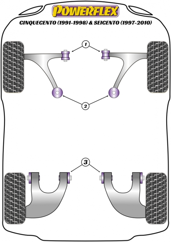

something else i have just noticed.
fitment of stock bushes is with the flanged end facing inwards, but the pic on the powerflex site seems to show the flanged ends facing outwards?
whats the concensus on the way to fit these?

Emailed powerflex and they confirmed they should be fitted as per stock bushes and will ammend their diagram
