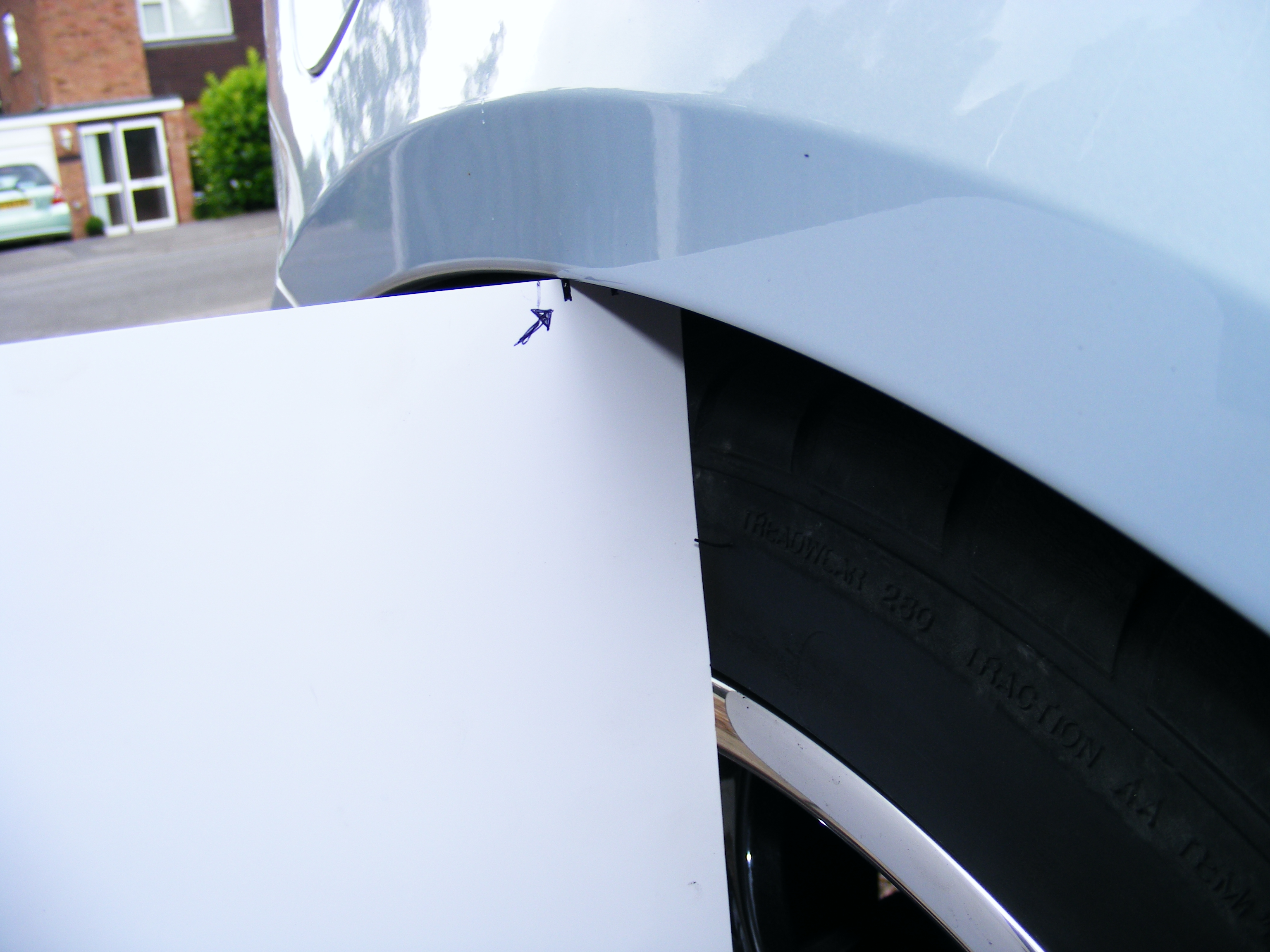

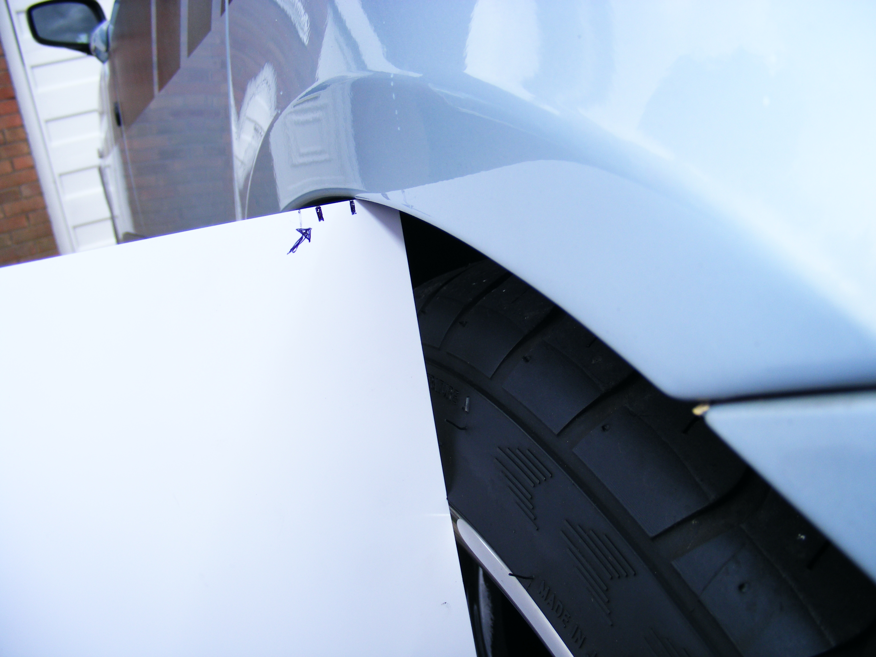

just taken a few pics for you to see.. its 10mm max difference to be honest
right wing
left wing...

Hi Steely, there is nothing to worry about wit that difference 90% of cars have that same gap the wheels (usually on the left side) are closer to the arch then the other side every car i have ever owned has been like that, i dont have a stilo but both my bravos and my van are like that.
cheers bandido! been banging my head against a brick wal all day!, :p the wheel runs dead and true , i thought it was possibly like that from new but i wasnt sure... and i didnt want to outlay money for another set of rims if the subframe was damaged.. it drives spot on.. cant fault it...
cheers for that! :) appreciated!
