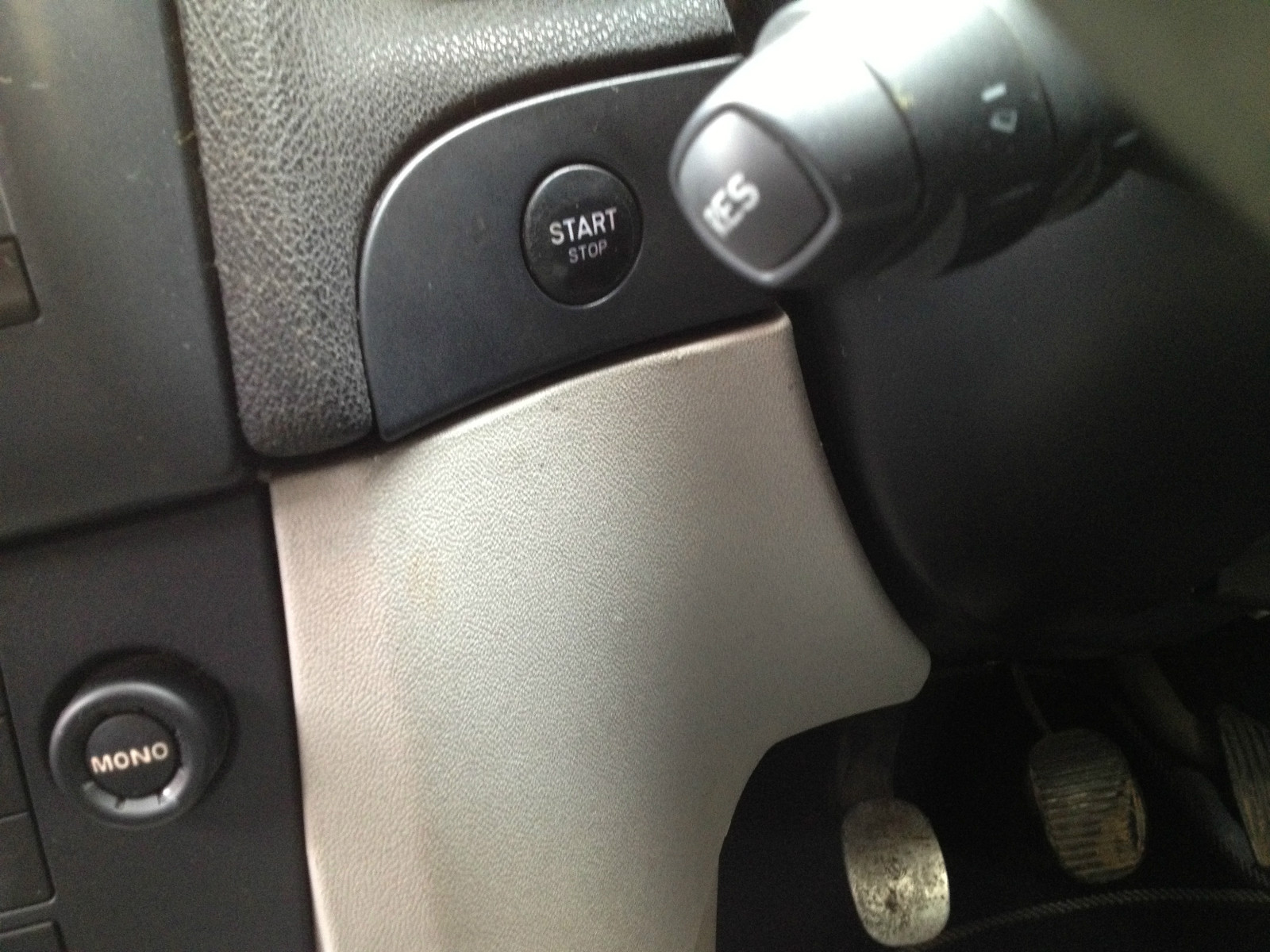

Keyless entry with Stop/Start button.

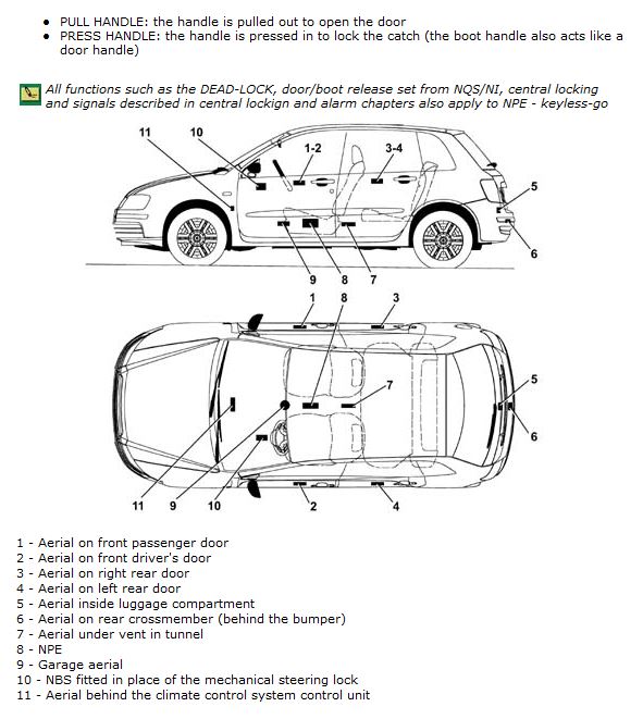

One of the many aerials for the system is in the boot or tailgate handle.
You could probably use a switch from a car with Easy/Go in a car without it, but not the other way round. The ECU would detect a missing aerial.

Do you mean retro fitting a complete EasyGo system? :eek:
It would be a nightmare.
9 additional control units, 9 aerials, electric steering lock, Stop/Start button, CID Key(s), Induction sensor to give temporary power to the CID if it's battery goes flat (fits under the panel below the handbrake lever. You can see 2 sets of curved lines moulded into the plastic where you place the CID). Vast amount of extra wiring, different side door handles and locks. I don't think you can program EasyGo into an existing body computer, so you'd need a new one.
