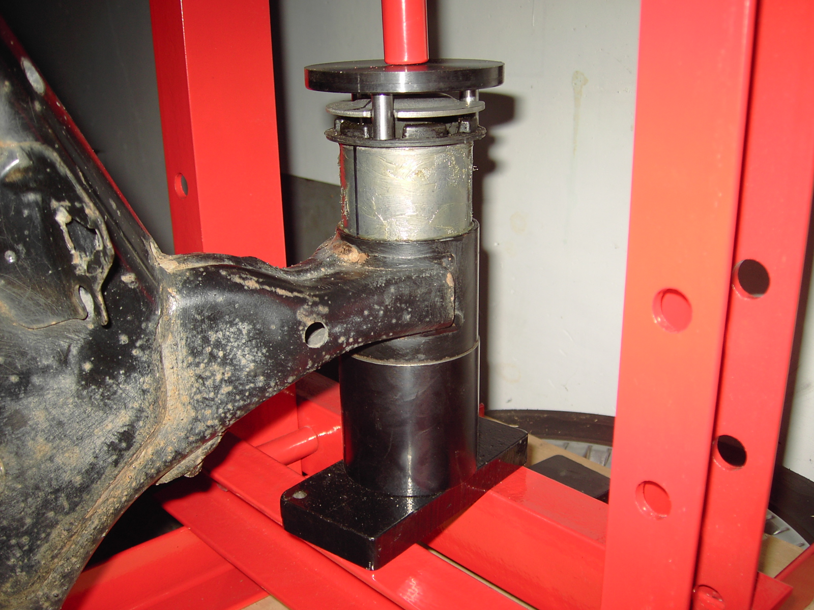

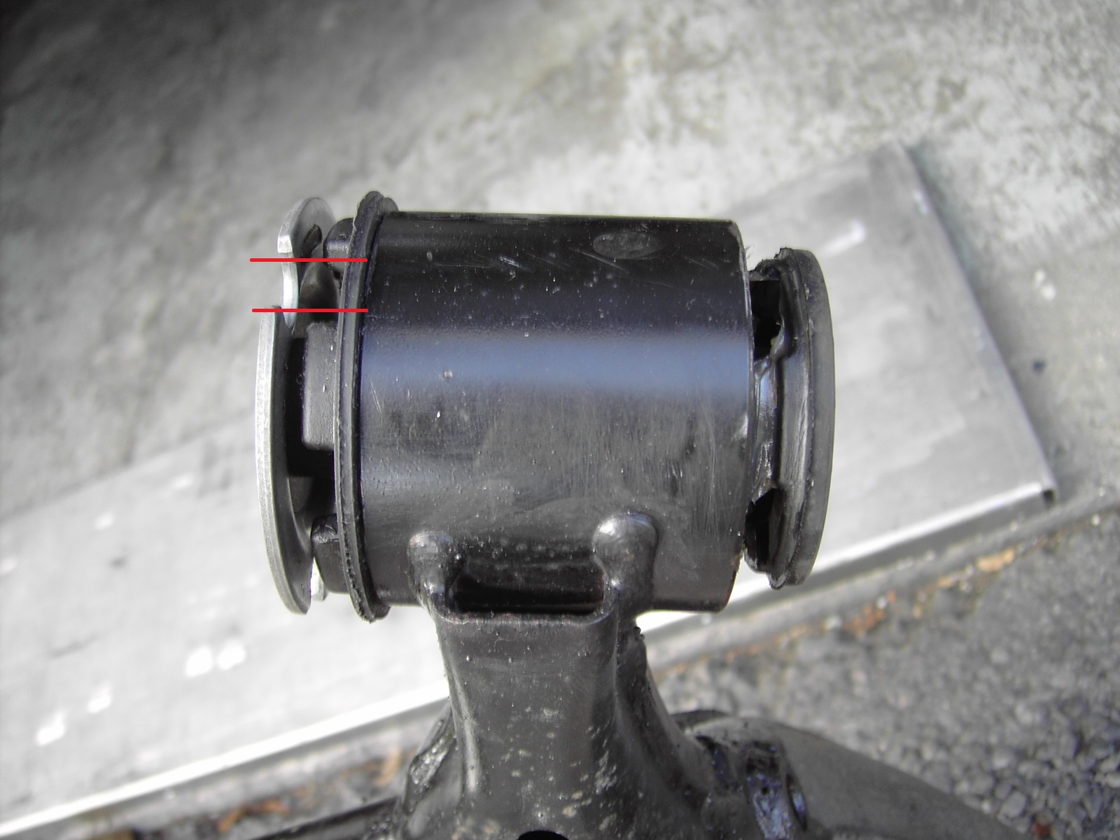

The cutouts in the end plates are for the prongs of the three pronged press piece to go through. It doesn't really matter where the end plates are fitted on the inner sleeve, providing they are aligned with the low points of the castelated bump stops on the end of the bushes. The three cutouts are not equally spaced at 120°, so it may be that they can only go in one position to satisfy the above anyway.

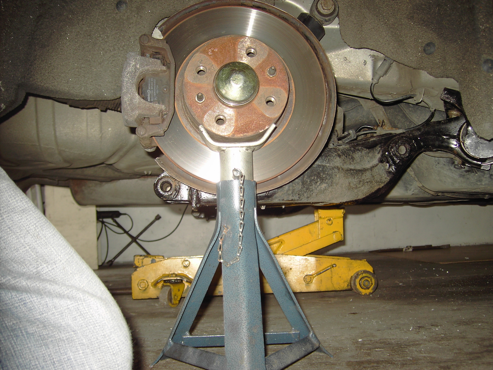

When refitting the axle beam, don't tighten the central bush bolts until the weight of the car is on its wheels, otherwise the new bushes will be under constant tension and will fail quickly. As it's difficult to get to the bolts with the wheels fitted, I always lower the car onto axle stands under the hubs to take the car's weight when tightening the bolts.
