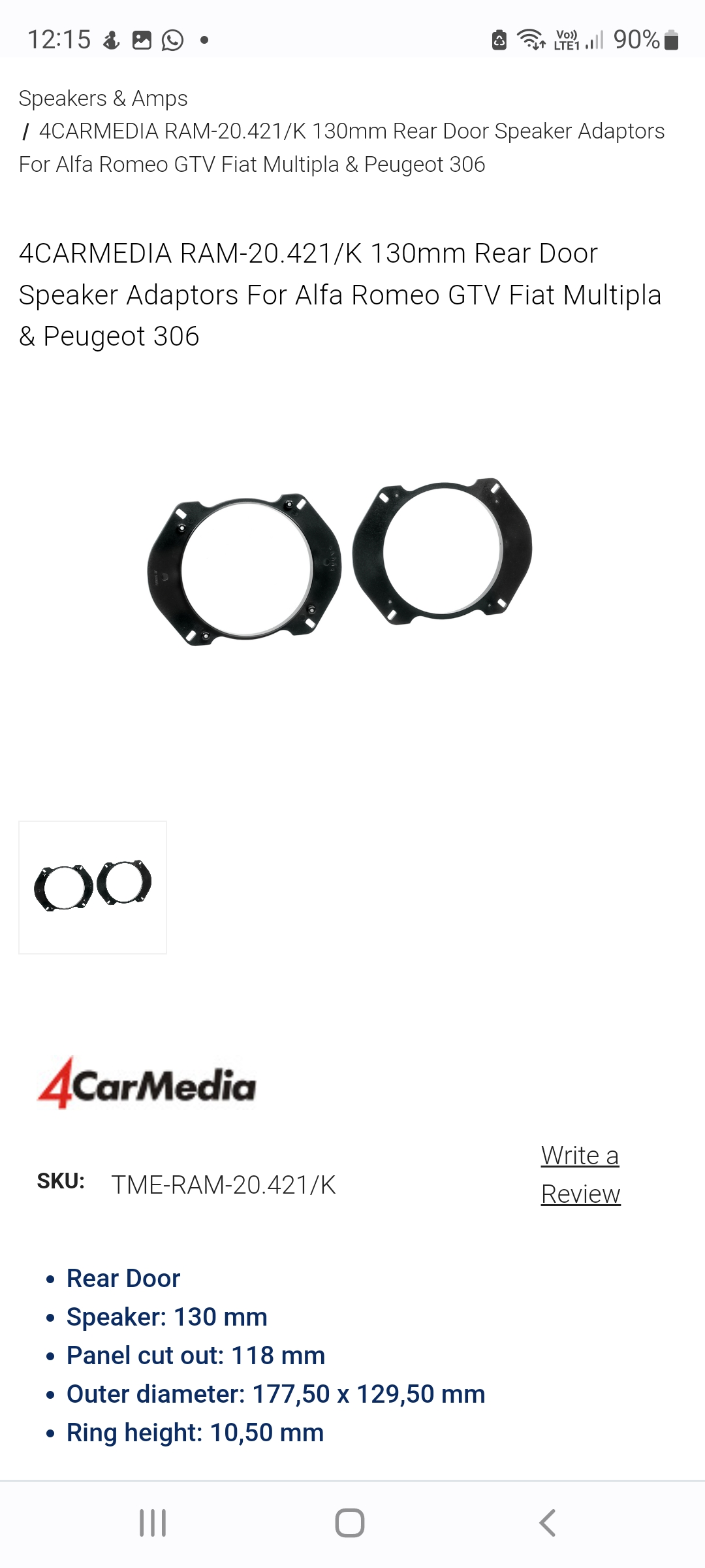

Bought the JBL Stage 2 524 speakers. Sound a damn sight better than the muffed sounding paper coned efforts that i took out. These are round abd not the oval shape that is fitted as standard so you wilk need a backplate to accommodate these. Let you know after a few more days how the new ones sound to give you some idea. Photo attached of backplate required.
