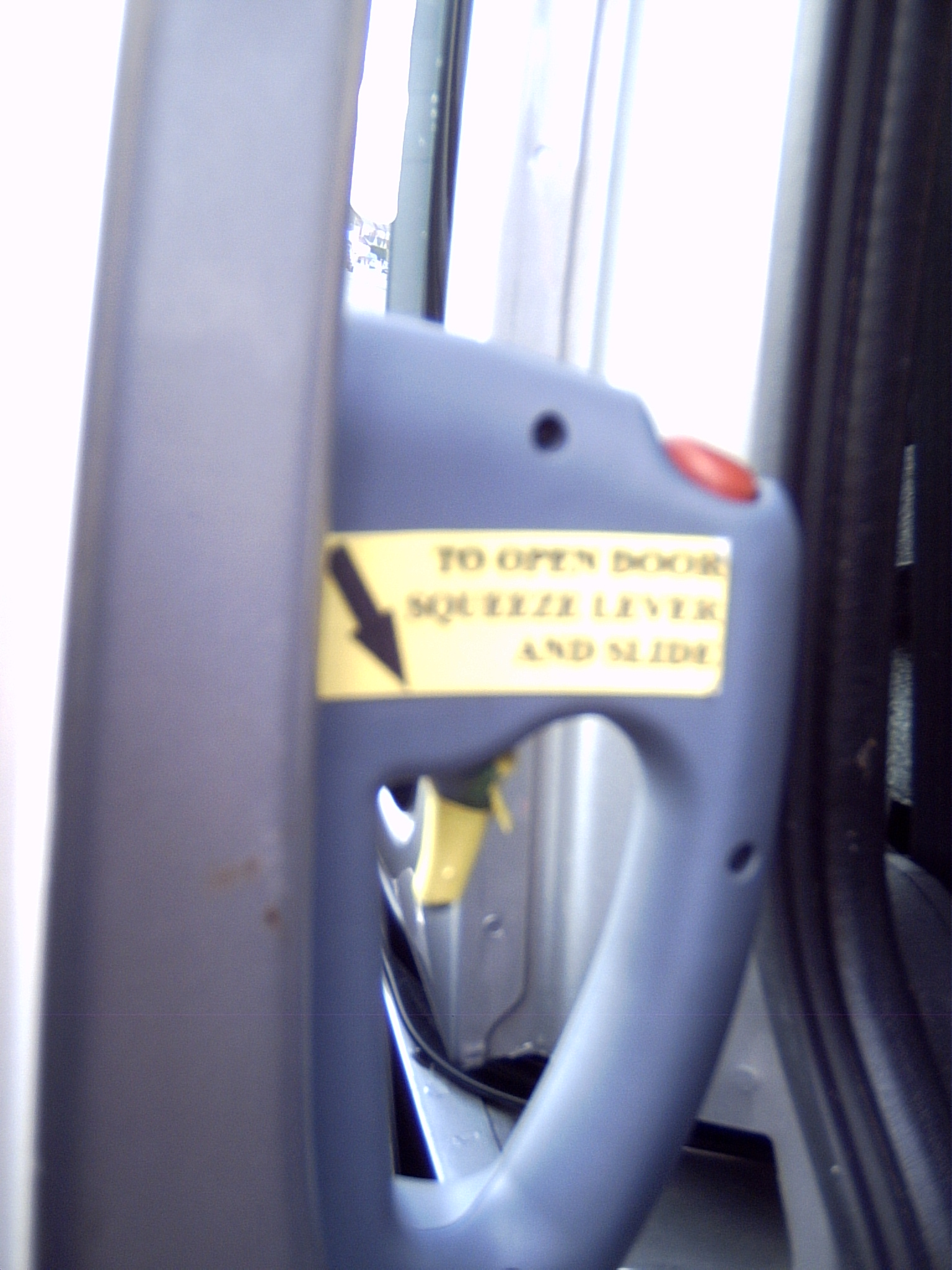

Sounds as if we have the new type, but still a problem. Passengers can see the button on the top, but not the trigger inside, so they press the button - and lock it!!
Thankx for the suggestions.

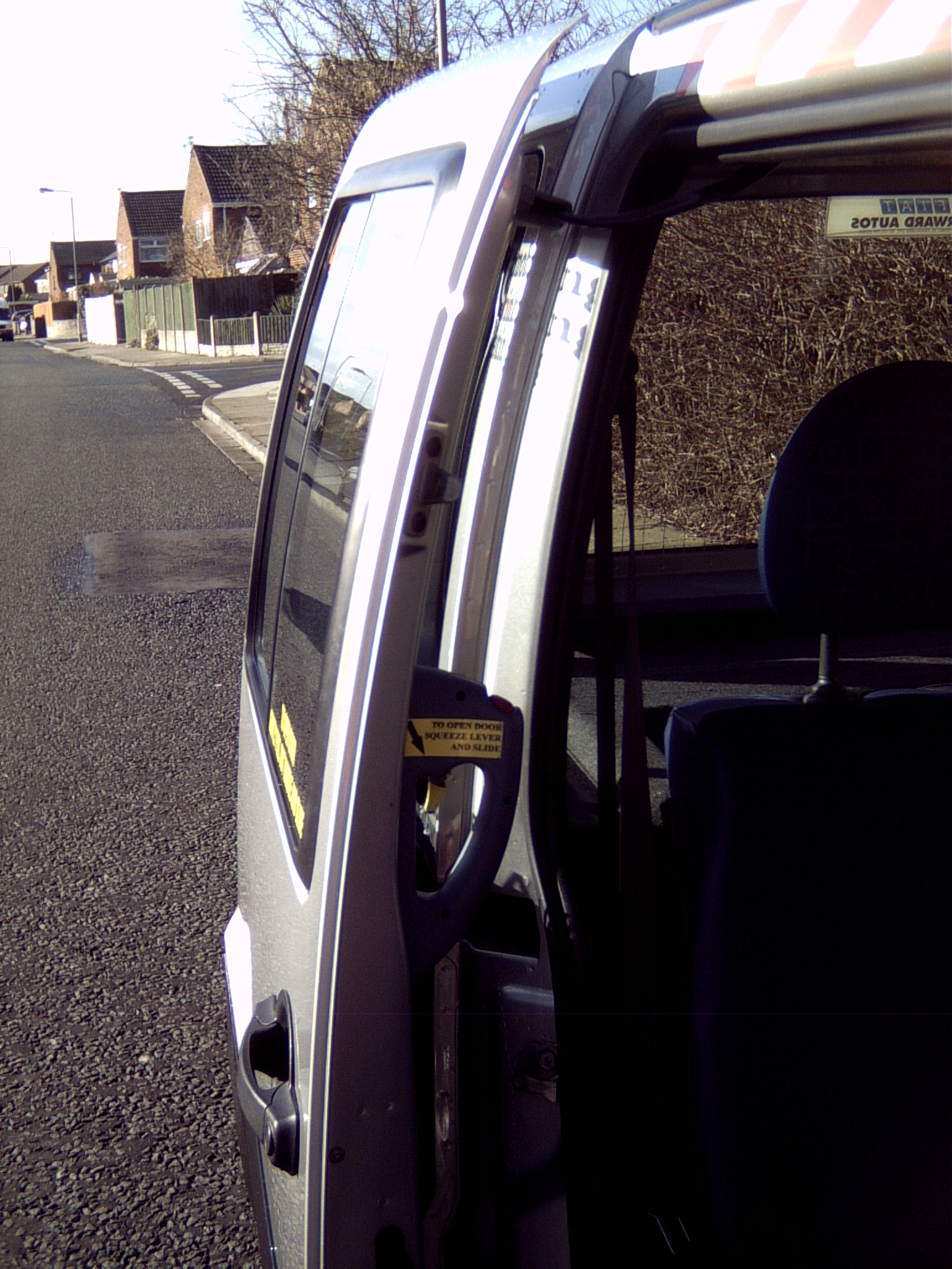

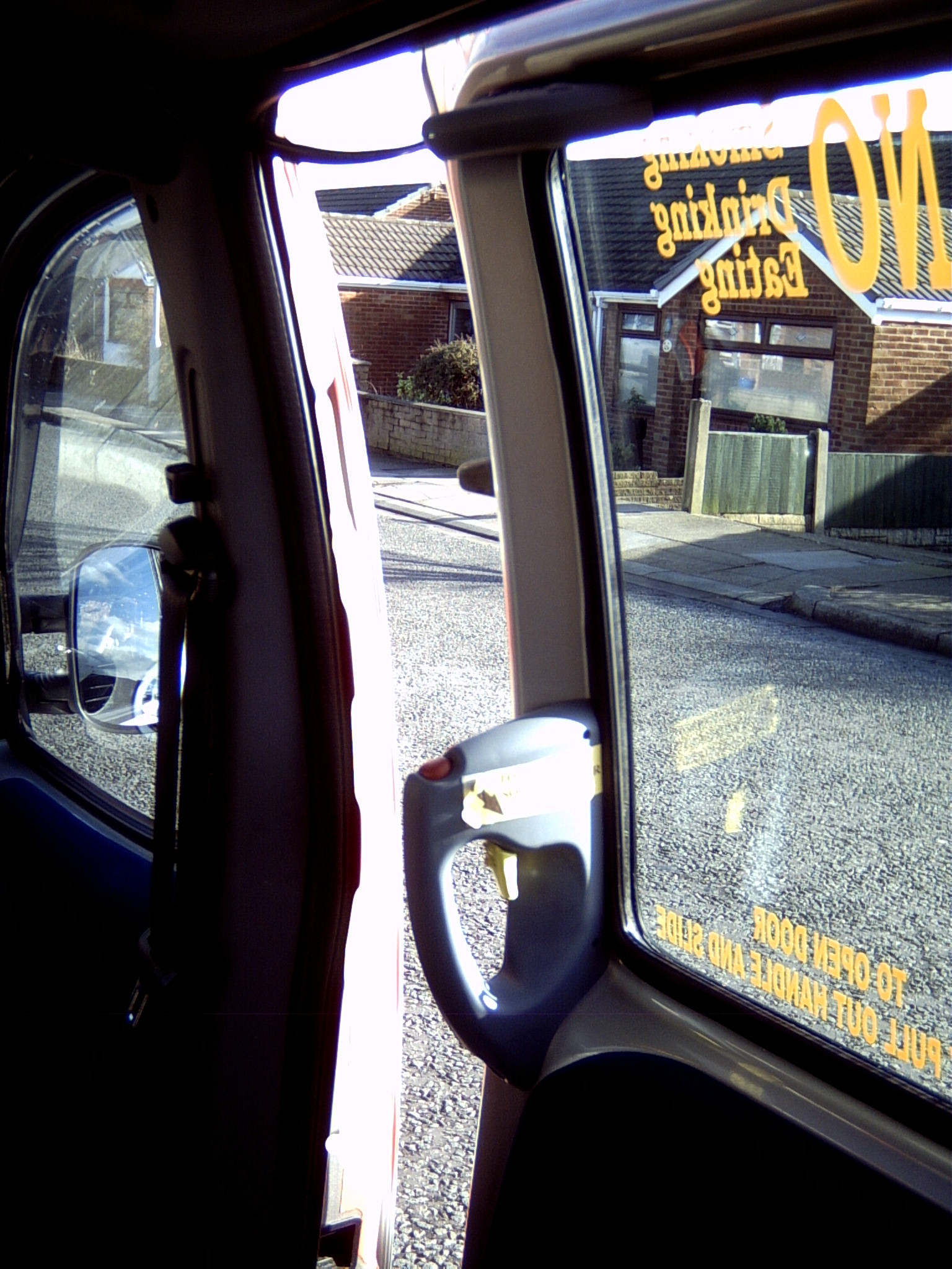

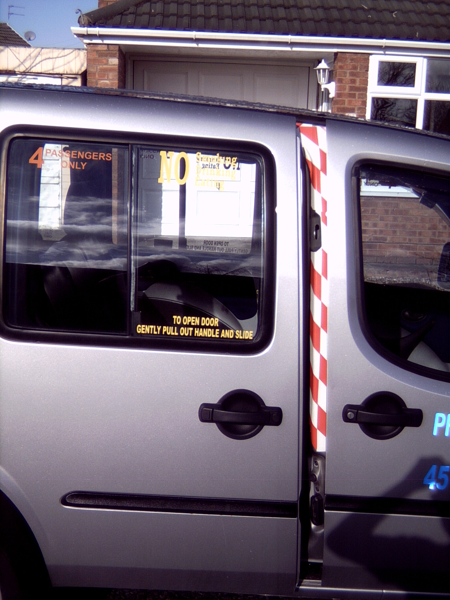

I have had made stickers made for the interior rear door handles with " To open door squeeze leaver and slide " and a big arrow pointing to the lever, which is now painted bright yellow. Red and white hazzard adhesive warning tape, stuck around the rear door openings, and 1 inch high red lettering stuck on the rear door glass " To open door pull handle and slide ".
All this to no avail, I have lost count of the number number of fingers that have been caught , the worst one though required a trip to the local A&E, at 1.30 AM on a Sunday morning , where he was detained untill the following day to under go surjury on his middle finger, he is now claiming against me for his personal injury.
If I could work out how to upload pictiures, I would post the ones I sent to my insurance company.

hello mate, wait till you have had it 6 mounths .it drove me nuts.SO WHAT I DID WAS ONLY PICK UP PEOPLE WITH A HIGH IQ. NO i put a bit of heater hose over the back pin where it locks when its open+ cable tie, and a small sticky arrow pointing to the trigger,:bang:
