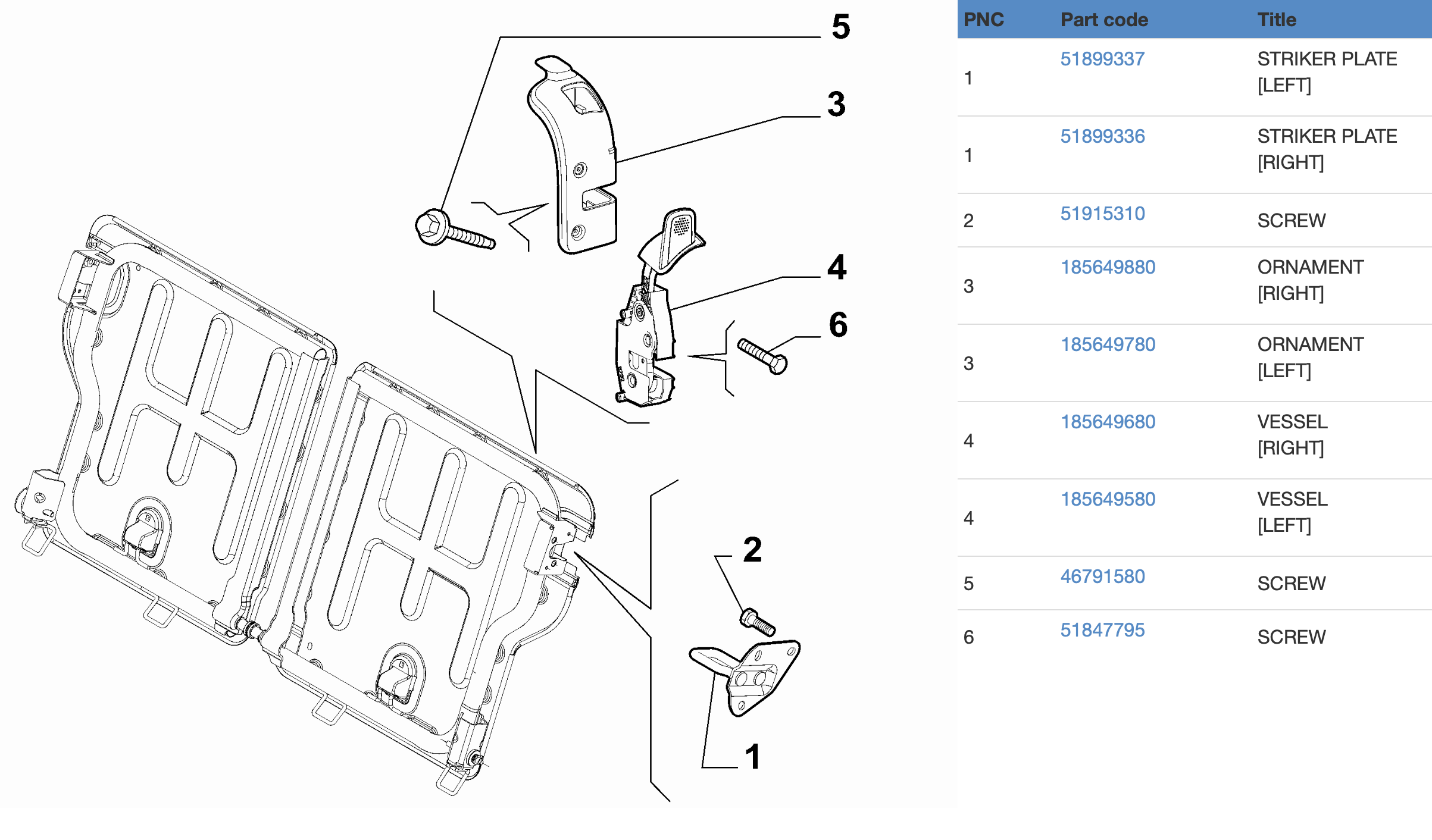

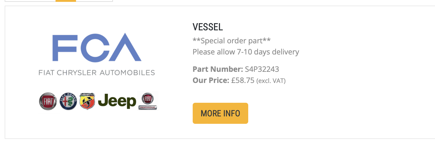

Part number might be item 4 in this diagram... note left or right
Looking at that, and looking at my own seat, you may just be able to get an angled screwdriver and a 1/4 small socket/ratchet in there!
