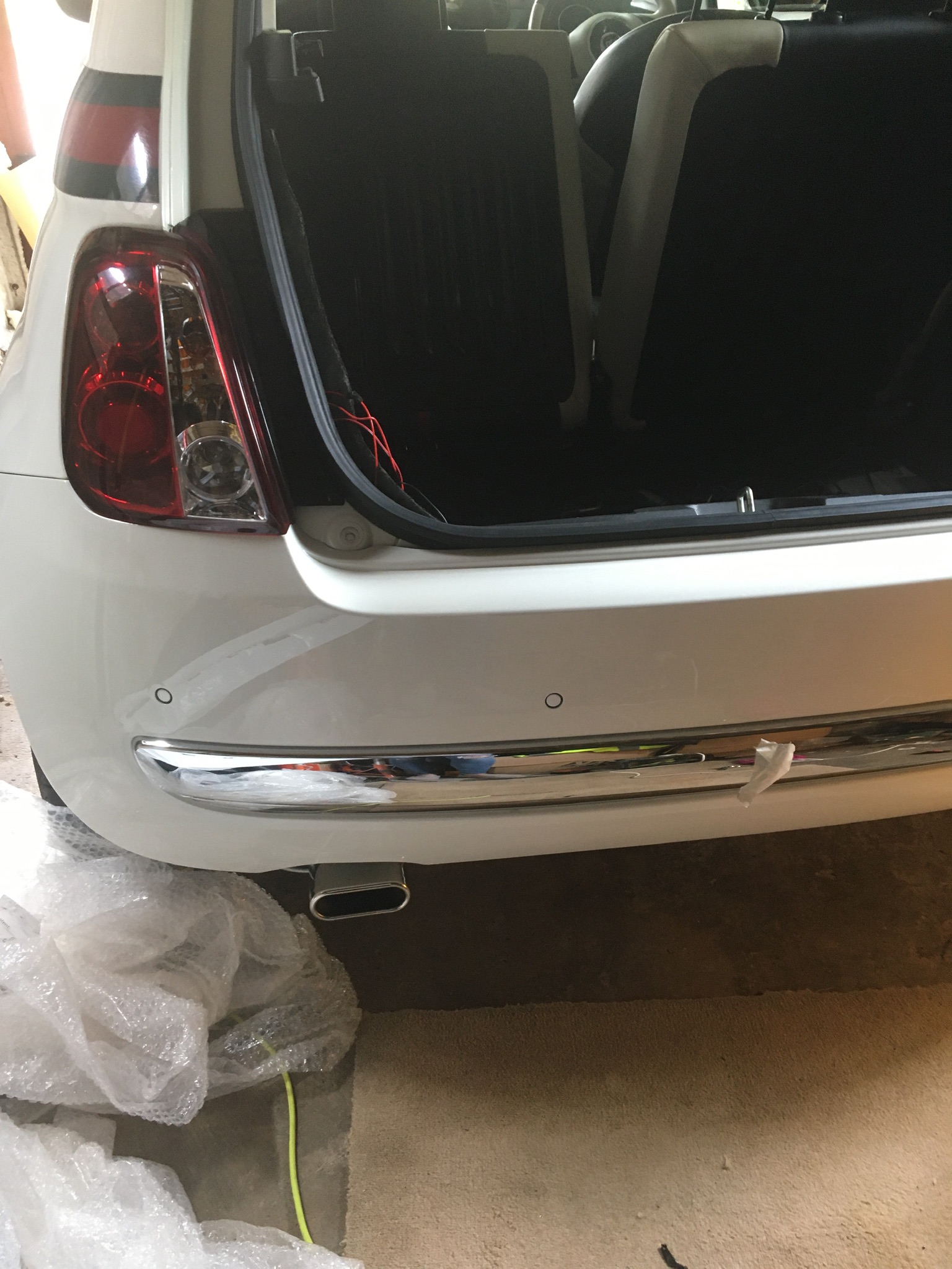

I fitted these myself! OEM looking from eBay! Cheap as chips and come with the circular cutting tool just hook up to reverse light wire & a good earthing point and job done!
