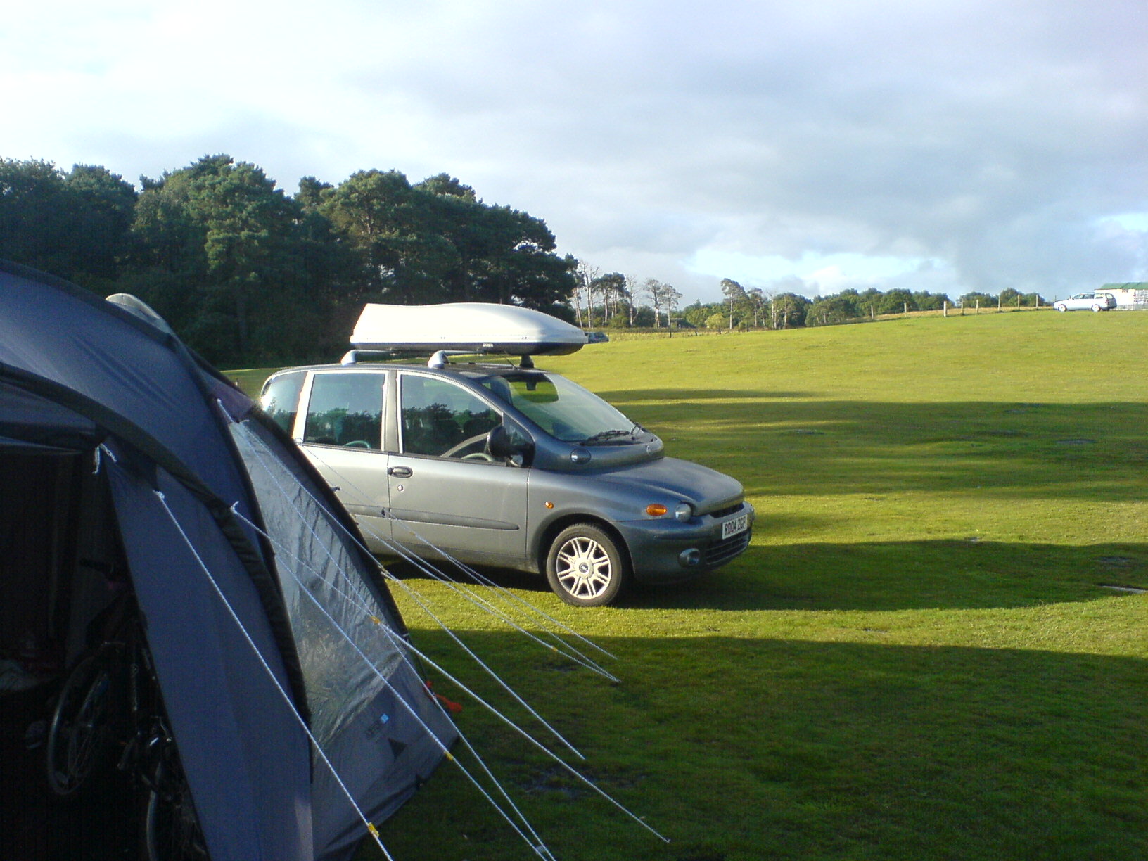

I took 5 people (me + 4 mid-teens) with a large dome tent (large enough to park the Multi completely inside the centre section and still have access to the 3 'bedrooms') and bikes for all of us on a long weekends holiday in Dorset a few years ago. I didn't think I'd have a cat-in-hells chance of getting us all in but in fact it wasn't bad at all. No bags on anyones lap, for example.
The only assistance the Multipla needed to get us there and back came in the form of a pair of the Fiat roof bars, so that I could fit my 6' roof box, and a tailgate mounted cycle carrier which I managed to get three 26" or 24"-wheeled bikes on without obscuring any rear lights and the tailgate could still be opened. I think I took the front wheels off of all three and they went in the boot with the other two bikes, also sans front wheels, but that's no great hardship. Both the roof box and the cycle carrier came from Halfords.
Three seats in the front, two in the back and a jolly good time was had by all. In fact, it was that little break that convinced me the Multi was something to keep hold of and not the stop-gap motor that I had originally intended it to be. I remember looking at our neighbours (much longer) Golf when we got back and thinking "I'd like to see you take five on holiday with their bikes in that!"

I had a 26" and 2x 24" wheeled bikes on the back and it was fine. If you've got small kids bikes, it's worth bearing in mind that with a quick strip-down they can quite easily fit in one of the 'fat' roof boxes like the one in my photo. It's also a lot quieter on the motorway without the bikes stuck out in the breeze. Back in the day, I took many bikes (and a folding bike trailer) to France in this way. We even bought bikes in France (reasonable quality ones were much cheaper there at the time. Happy days, long gone.....) to bring back to the UK. Pedals off, seat and handlebars either remove or twisted 90 degrees and they take up surprisingly little space. Ten minutes with a spanner at the other end of the journey and you're good to go.
Tighten the straps for the tailgate-type carriers gradually and evenly. Use extra tube padding in the form of plumbing pipe lagging if necessary, to stop bits hitting the car glass/bodywork. That and some duct tape works wonders. Once tensioned-up, it's all very solid. I could pull the tailgate up/open by grabbing a bike rather than the tailgate without any problem at all. If you get the bikes mounted fairly high up, they won't obscure the number plate or rear lights and the added bonus is that they tip forward of the tailgate hinges when it's open, so the gas struts don't have a hard time keeping the tailgate open. Just test it all beforehand to make sure you don't over-do it, as you can end up with the handlebars whacking the roof when the tailgate is opened.
In my photo, the roof box was mounted a long way forwards so that the bikes on the tailgate didn't clout it as the boot was opened. It was offset to one side so that we could strap some monster stunt kites to the roof bars, and make sure the car aerial didn't get bent out of shape. The twin sunroofs could still be fully opened even with all this cr*p loaded up!
