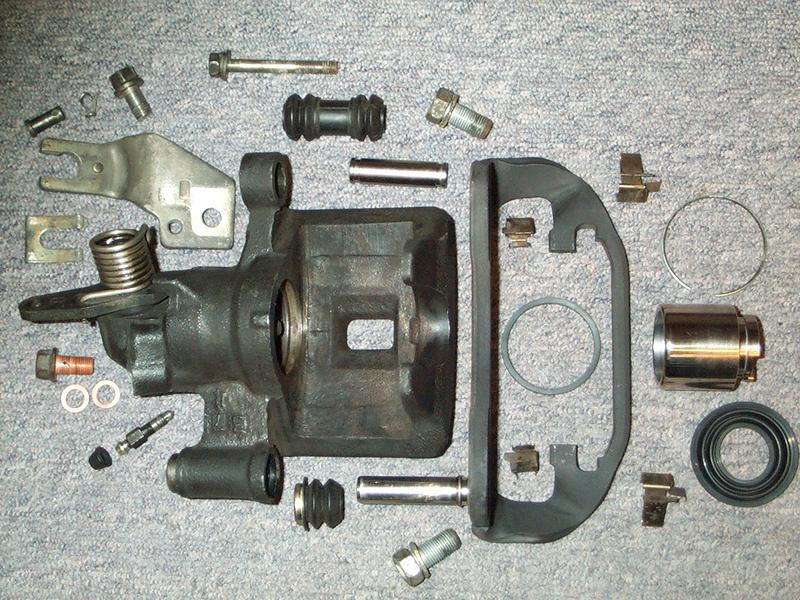

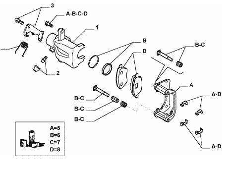

anyway, here's some pics
Caliper from an MR2
Sorry Deckchair, was rushing a bit. Thanks for the photos, certainly helps a little of my understanding....
