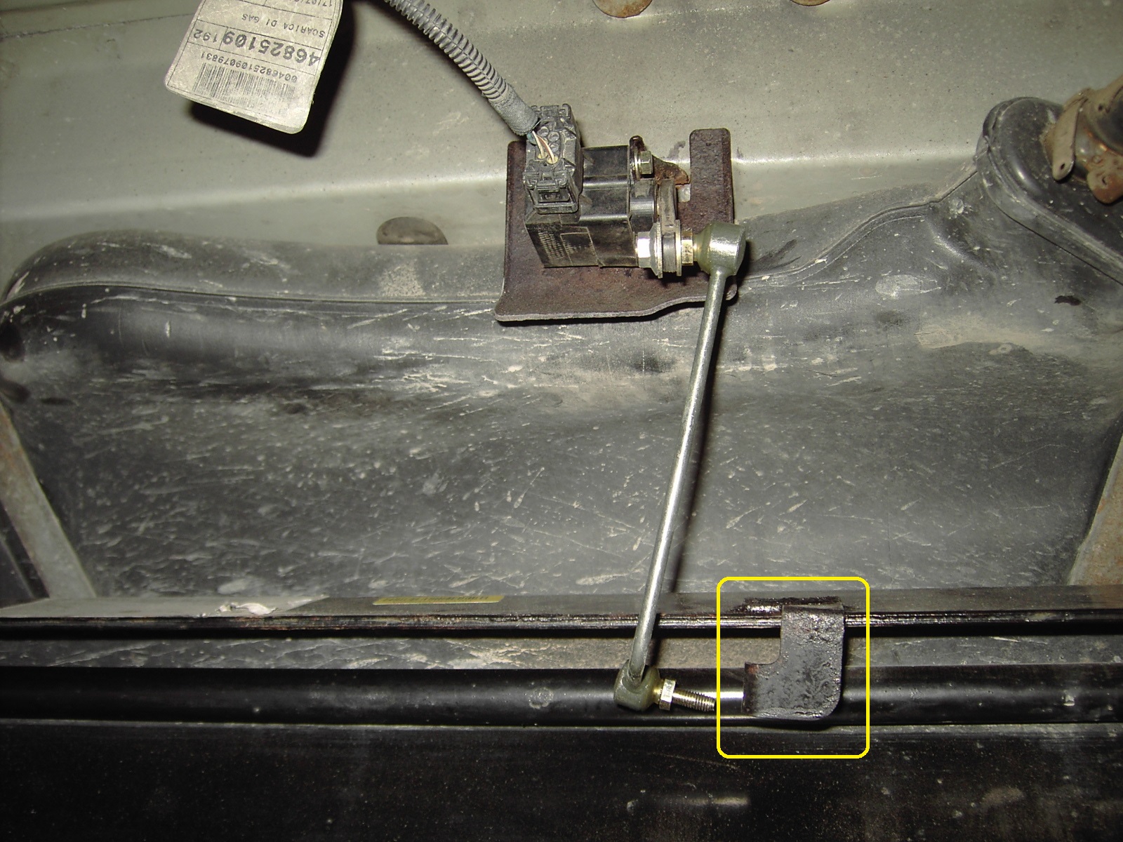

For both saloon and estate versions, there was a part number for cars with original Xenon HID headlamps, and a different part number for cars without HIDs. The only difference was a bracket welded on axles for cars with HIDs to mount the rear levelling sensor. You could obviously fit an axle with the bracket to a car without HIDs, or make and fit a bracket to an axle without one if your car has HIDs.
