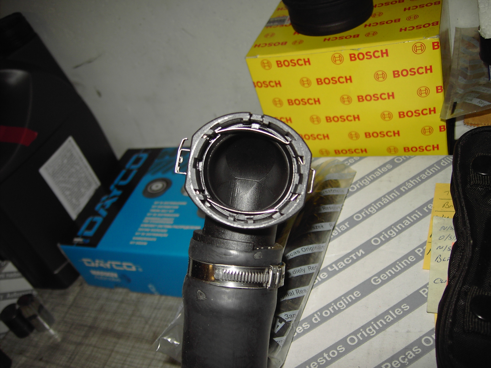

If it's like the picture below, it's a quick release connector, squeeze the raised metal parts together while pulling the hose complete with plastic elbow off the radiator.
Although they are known as quick release connectors, they are not always quick to release once the clip is full of crud. :(
