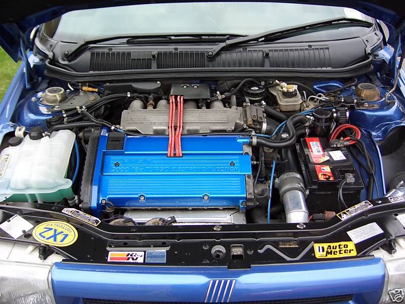

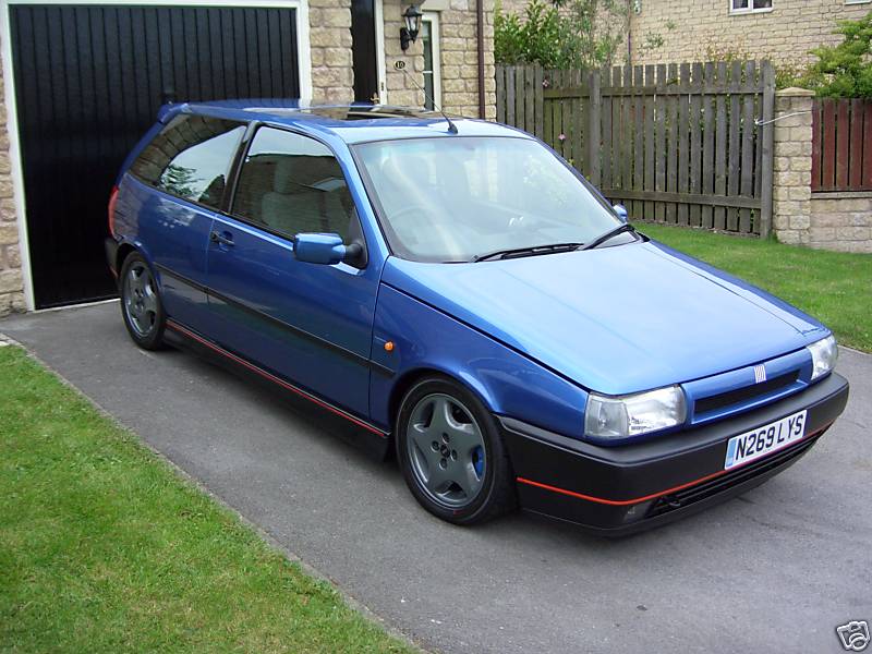

I own a fiat tipo but it has a coupe 2 litre 16v turbo engine. As its my first turbo engine is there anything i need to look out for maintenance wise etc? i know that most of it is the same as a standard 2.0 16v vut as it has a turbo i just want to know what problems if any could occur?

I have the same car in red (will post pictures under the hood)
Can you tell me where the oil cooler and intercooler are fitted in your car.
or maybe post a picture?
By the way nice looking car.
