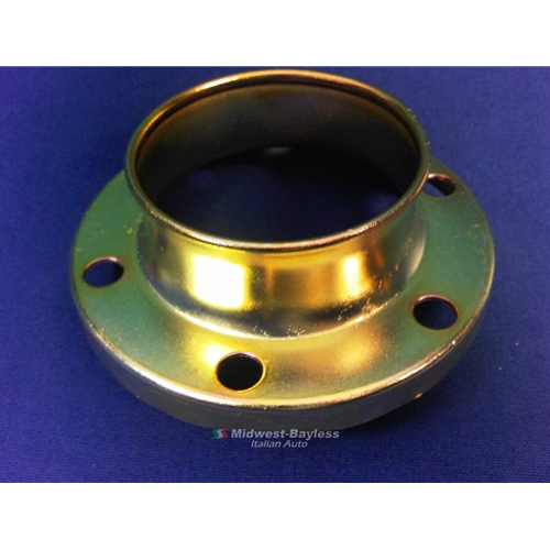

I received a new replacement CV joint for the one on my 82 X1/9. The old CV joint has what the service manual refers to as a 'Cover'. I could not get the old CV joint off of the axle (which is why I ordered axle, CV joint, and washer from Midwest Bayless). I realized I needed the 'cover' piece after I received the new parts. I ordered the cover, and now am trying to determine how to install it on the CV joint.
A sort of brass hat-shaped part (see picture) that needs to be in place for the boot to have somewhere to be clamped onto.
How should this be connected to the CV joint? Is it just a press-fit? Or do they use some form of adhesive?

Hi skilmaker
The top hat Just bolts onto the cv joint.
I guess you could put some blue hylomar / gasket sealant on it if you wanted. They are a snug fit. I didn't put anything on them.
Getting the boots to fit tightly is the main challenge. Special clips and pliers sres available but i find if all else fails a large zip tie works well at keeping the grease in.
If i recall correctly the cv joint is the same as a model of English Ford so they can be bought quite cheaply.
Thanks! I have the new CV joint, and I just ordered the cover. On the old CV joint, someone did use some form of sealant, so I was not able to determine how they were assembled.
Now that you mention it, it makes sense that the bolts passing through the cover would hold it onto the CV joint. I might be extra cautious and use some sealant, depending on how tight the fitment is.
