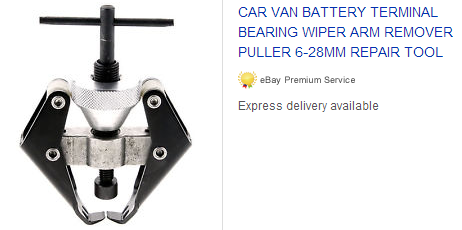

Can anyone help, my qubo passenger wiper stopped working. I remember this happened to a Punto I had and I couldn't buy the linkage bars separate. I have just seen linage bars on ebay for £29. the question I have is when I try to get my wiper arms off to get to the linkage they wont budge. I have undone the nuts but they wont come off. I can see what looks like a serrated washer which might be holding them. I don't want to force them off. Any ideas?
Halfords or most tool places will have them..............or to save cash, try a tool hire dealer, though that can be as dear as buying one.............and if you buy it you have it for next time................

Just type in wiper arm puller on ebay
This is the same i bought.
