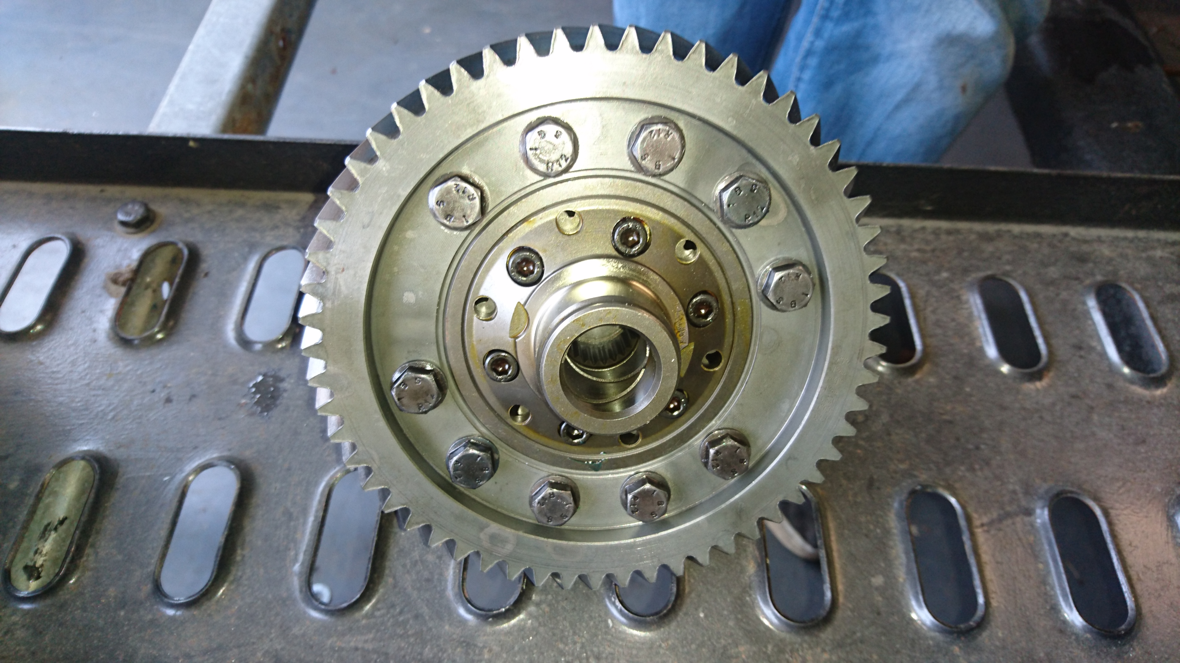

Hi all, just wondering if anybody from one of the QDH3K Quaife Group Buys can answer a quick question.
I am just about to bite the bullet and buy one but I am finding it difficult to get an answer from Quaife on one aspect.
My crown wheel has 10 bolts and a PCD of 115mm, which is fine. But the bolts are not evenly spaced. They are in 2 sets of 5. I have 2 crown wheels here and both are identical....1 from a 6 speed Stilo and another from an 1108 Panda 5 speed.
Can anybody remember if this is the bolt pattern on their crown wheel?
I don't want to purchase a Diff and find out it's wrong as I live in Ireland and don't fancy paying for return carriage, getting told 'no returns', etc.
Thanks in advance,
John.
Hi, I'm running a Quaife diff in my Sprint & Hillclimb Cinquecento.
You're correct in that the hole pattern to bolt the crownwheel to the diff is 2 sets of 5, i had to use a bolted crownwheel from a blown up Punto Grande gearbox and fitted it to the Quaife diff which then went into a Mk2 Punto Sporting gearbox.
