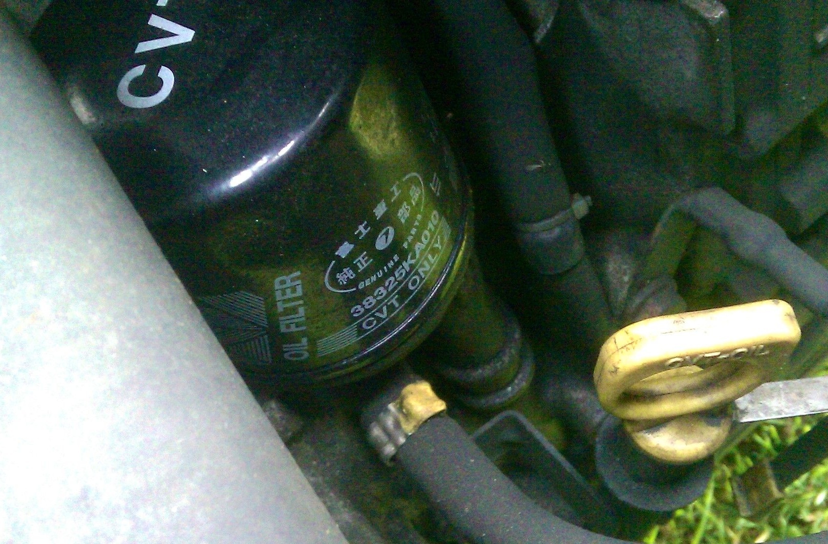

This should be what you found... -- and I'm sure it is...! :D
It should be clear, and between the max and min marks. :)

I have just checked and it looks exactly like that but I am at work so cant run the oil around to check the levels currently. My that filter looks hard to change in that position

The filter (as I'm sure you've spotted) is the big black think next to the dipstick, labelled 'CVT'. ;)

...and the filter can be a bit of a pain to remove: as it can feel like it's welded on. (There are a couple of threads on here, somewhere, about it. Searching for the words "speedgear" and "filter" should find... -- sorry, but I'm just on my way out....) Being such a small object, and with such relatively tight access, means that you need the right tool, really, to get at it. :mad:
