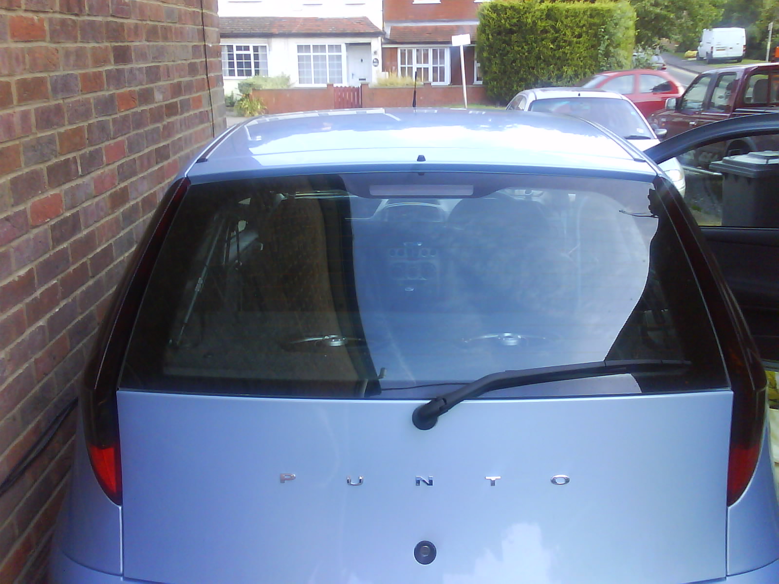

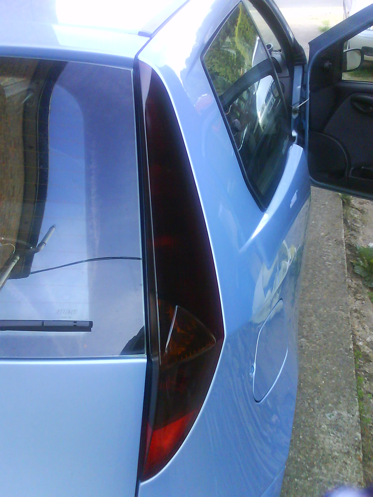

Just Thought i'd add mine as im pleased with them lol :D:D
i thought the mk2b had the rear fog and reverse on the smaller tailgate lights that the mk2 doesnt have on its tailgate, so that means fitting mk2b lights will leave you with no rear fog light or reverse light unless you fit a mk2b tailgate. without a foglight you cant pass MOT.
