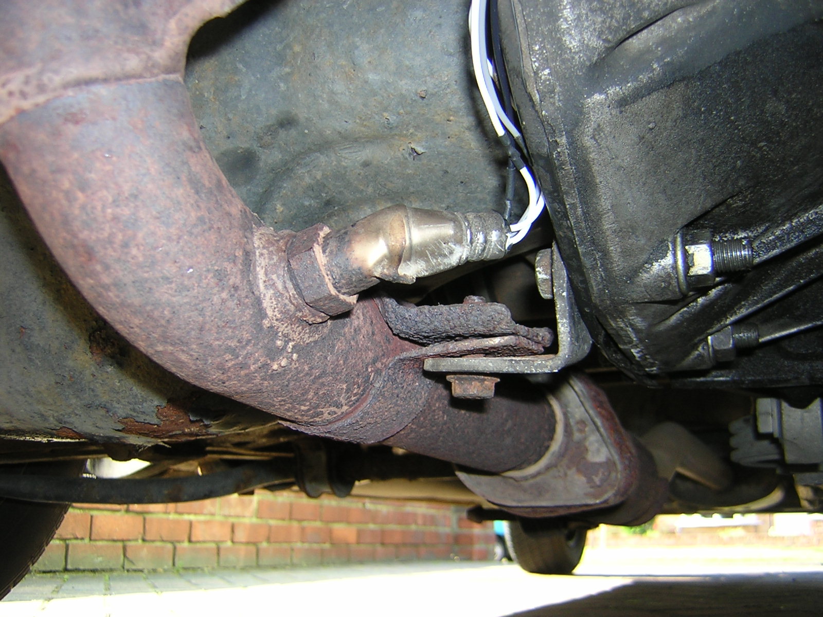

will post a pic of it to show why I think it's fcuk'd
here's a pic
had the sensor out to resolder wires. Haven't recovered them as I wanted to see if it was working OK, but it doesn't
anyway I can check the item @ home?
Can get a new 'copy' lambda sensor for under £40. Are they OK or is it best to go for Fiat item @ around £70 ish?

4 wire lambda is all you need (they are all the same), however non fiat ones dont have the plug to attach to the loom.
You can buy a new plug from ebay "4 wire amp superseal" or splice into the old plug and use that.

I'll have a look on ebay but will probably just splice and tape it all up.
