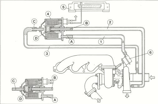

And for your info, there is a pierburg valve that controls boost if its stock - its not just got a vac line from one side of the turbo to the wastegate ;) Its located on the bulkhead under that funny plastic square cover. People take them off and replace them with bleed valves quite often - 17psi is slightly higher than stock, which normally levels out at 0.8bar iirc (11psi) so this is probably worth a little investigation on your part. If the pierburg is setting the boost at that level its not working properly basically.
Here is a few pics to help you ;)
