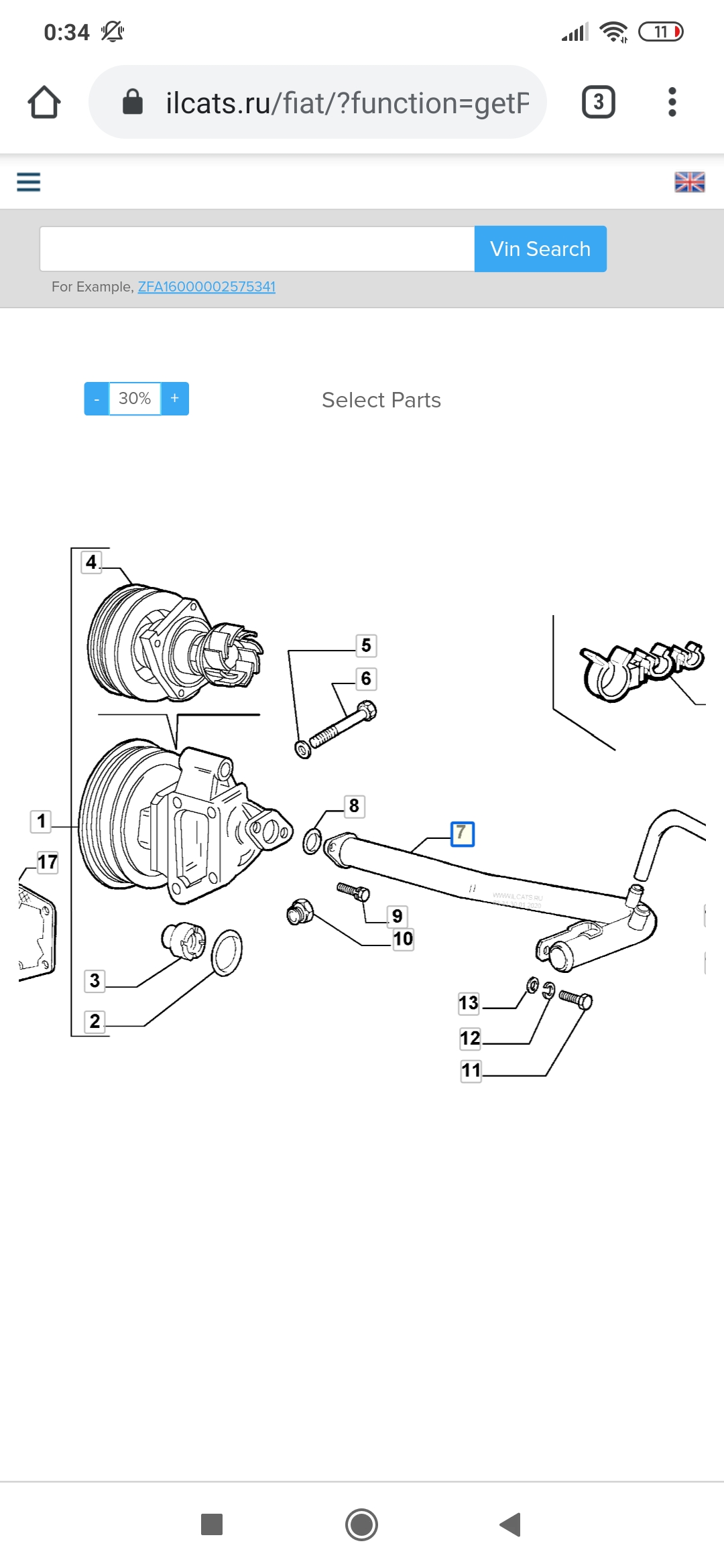

Hi guys, I found a leal on my GT. Its the metal water pipe that comes from the water Pump and comes around the back of the engine. I have the part number but I cant find One for sale anywhere.
Its the number 7 part, with the number 46401066. I went to the Fiat dealer here in Portugal and they told me that its a discontinued part, só they dont have it.
Do you guys know how to get One?

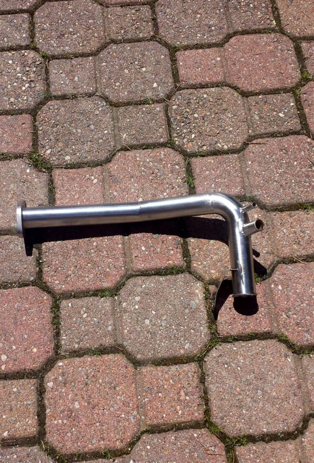

Unfortunately, you won't find this pipe (new) anywhere.
There's a guy on facebook called "Simone Filippone" who can make you a new pipe from aluminium.
Try to contact him or give your old pipe to a workshop to try and make one.
Does anyone know if the tipe of pipe matters?
My car has this tipe of pipe
But if found someone who makes this tipe
Does it matter? Can I use either one?
I didn't even noticed the flange.
But I don't think the hoses can fit on the take offs with thoses angles.
