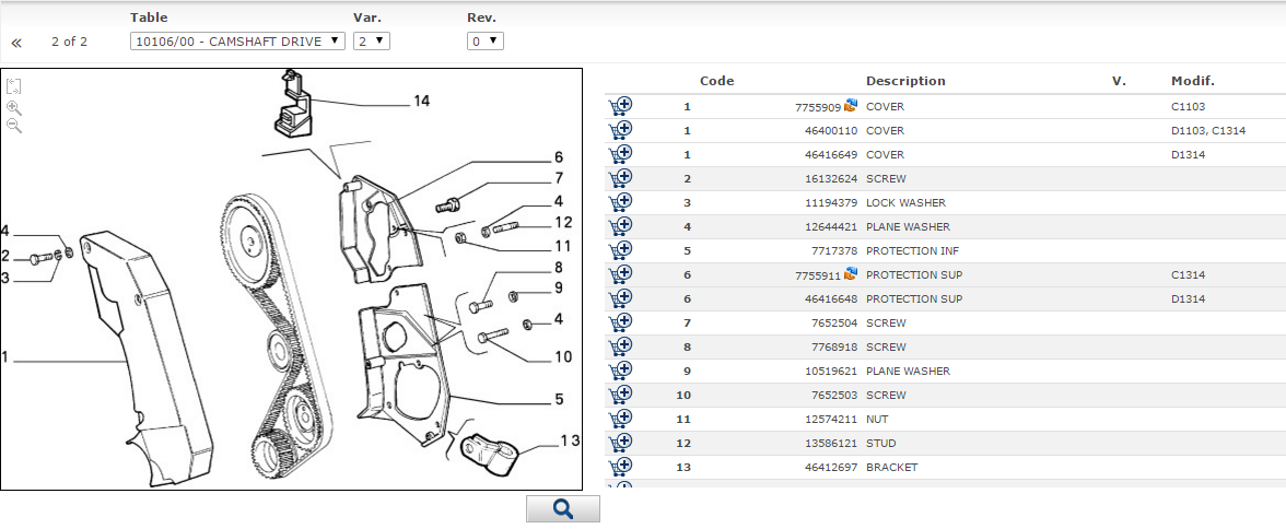

belt covers, i would either search ebay for cars being broken OR I am pretty sure them parts are available from fiat new still - see attached screenshot of the eper with part numbers - ring them and ask, stuff like this is sometimes pretty cheap compared to what you expect - my eper is a few years old but its saying the outer cover is about £18 inc. taxes. and the inner parts are cheaper still.

I did contact fiat regarding the cambelt covers... And rather annoyingly they do still make one cambelt cover... The outer... The inner ones have now been discontinued....

Tell me... You mention you took a screen shot from the "eper"
What is eper and where can I find it ?
Those pictures are really good.
Many thanks.
its not openly available the one i use, you need username and password which i am not authorised to give out. You can find quite new versions for download via torrent pretty easily though and run them locally on your computer.
There is an old eper available on the forum, links in the top bar if using coomputer - can't remember if its accessible via the app or not but i suspect not. Few parts of it have stopped working properly and clearly its not accurate on price or whether stuff is still being made, but still handy for part numbers.
