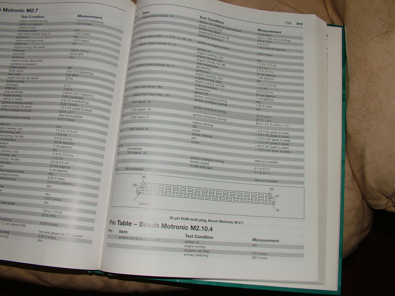

Nothing impossible, but I have never found an ECU to be the cause although many get blamed, often when a sensor or poor connection is the cause.
Can you get good diagnostics on it.
Another thought what is engine code? Is it 176A4.000 age 94-97 with Bosch MotronicM2.7 ECU?
If so I may have pin tables and readings to expect.:)
I think I need to confirm there is 12v at the injectors rather than just the noid light test, that's a job for tomorrow I guess.
Yes its a 1997 punto gt3 I think 176 is the engine code!

Apparently the bosch motronic 2.7 it runs ( thanks for the data lol ) can suffer from the injector drivers failing... 🥲

I suppose it depend where the injectors get their signal from.:)
