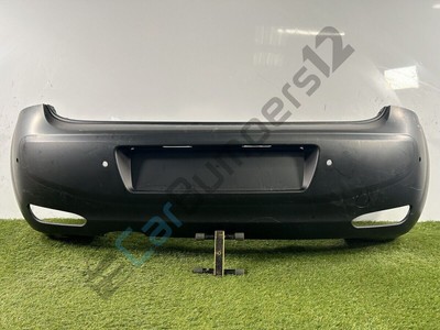

Or this one with the parking sensor holes
@PuntoHowTo
Thanks, I had seen the plain one when I was looking the other day but not the one with the parking sensor holes. £129 delivered is very reasonable for brand new. I need to get fitting quotes next week, if I can't get cheaper in the scrapper in good nick I think I will go for this. How much do you think is reasonable for just fitting? Upto £100 or more?
So, the bumper saga just got weirder. I decided on a purchase that was from a salvage place on eBay. I got the bumper for £115 delivered complete with parking sensors, fog lights / rear lights / reversing lights all in situ and the attached wiring - made sense as I need some of those lights due to mine being broken.
Now, my car is a 2014 Fiat Punto Easy 1.4l - the donor car is identical year, model etc. When the bumper arrived today, I immediately thought: "hang on.. these lights look different" - and they are. I then started thinking.. what if my existing bumper is already WRONG because, before my time, it was rear ended previously. So, maybe I already have the "older" or different style bumper fitted and it's just been painted to match. That's possibly why I'm looking at mine, looking at ones off the EVO etc and wondering why they look identical.
But, then I took to eBay and looked specifically at 2014 Fiat Puntos for sale.
I have found so far, SEVEN different style rear bumpers now, many on the exact same model 🤣 I am hoping / thinking this will indeed fit my car fine but what the hell was with Fiat during these years? Where they just pick and mixing parts or have the majority of Puntos all had the rear bumper swapped at some point for fun?

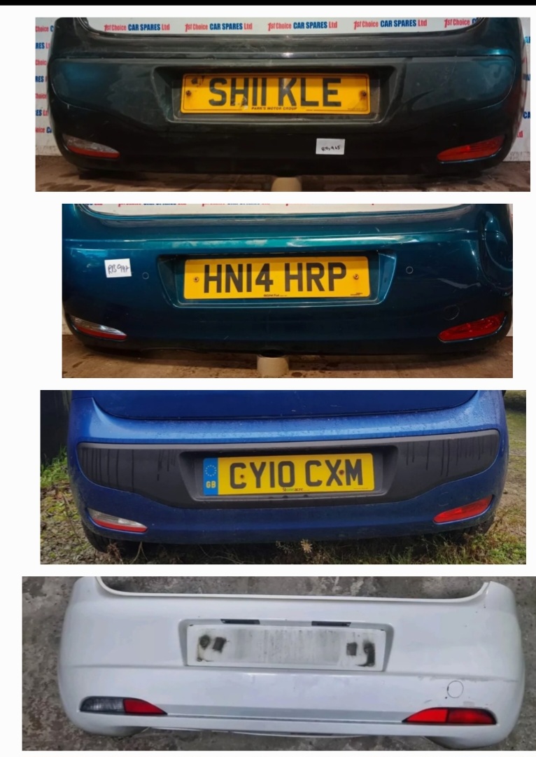

It's all pretty interesting - I like continuity problems 😏 I was looking at these pictures for example... so, the top one is 'based' on the third one down, possibly used the same tooling in the factory but rather than the meaty plastic bit, it's just a embossed version of what used to be. The second one is the same as my 'current' bumper where there is no embossed shape at all, this possibly uses the 'older' plain black plastic tool as a template. The bottom picture is the same as what arrived with me today, different design and different lights, this is possibly off or based upon the bumper for the Grande.
All a bit strange..
I'm not sure if my existing bumper has been filled or not. It does seem that it has / had some kind of thick coating of something over the black plastic toward the top but this isn't present by the broken light were the bumper is a clean split. I'll have to have a proper prod when it comes off..
All a bit strange..
SH11 and CY10 are both Evo bumpers, the reg alone indicate they are both pre 2012 but the black centre is the Evo bumper.
HN14 is a post 2012 Punto bumper, the sort you need.
the final white bumper is a grande bumper
I agree with this but it looks like we can't always trust the reg now as this is now clearly what I know as the 'Grande' bumper but aquired from a 2014 Punto Easy 😵‍💫

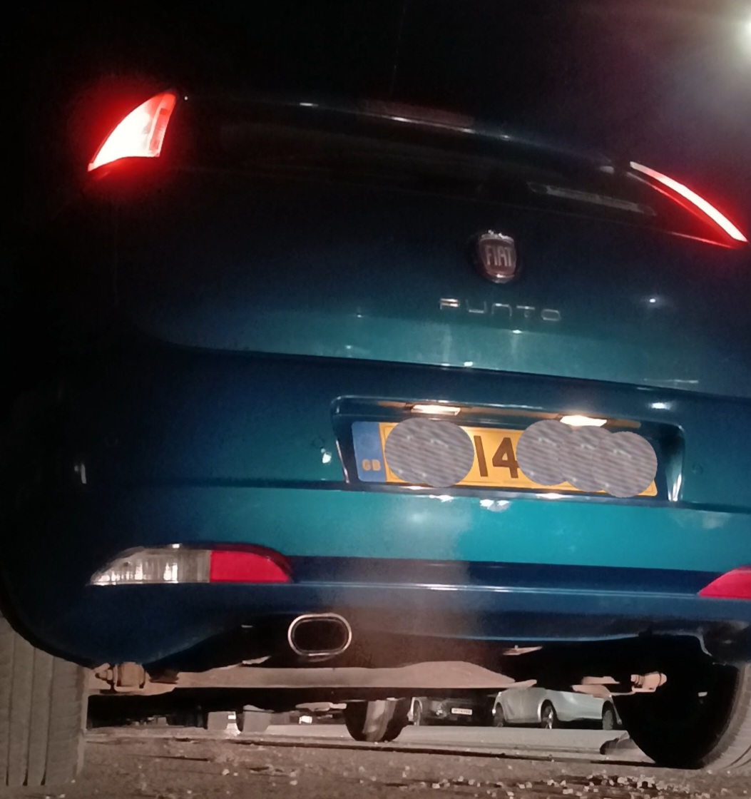

Sorry for no update on this saga bit I've been waiting to get bumper fitted etc. I've collected tonight - day time pictures to follow but we can, now, once an for all, confirm that the Grande Punto rear bumper 100% fits the later Evo model.
Sorry for no update on this saga bit I've been waiting to get bumper fitted etc. I've collected tonight - day time pictures to follow but we can, now, once and for all, confirm that the Grande Punto rear bumper 100% fits the later Evo model.
Told ya so.
Looks good.
