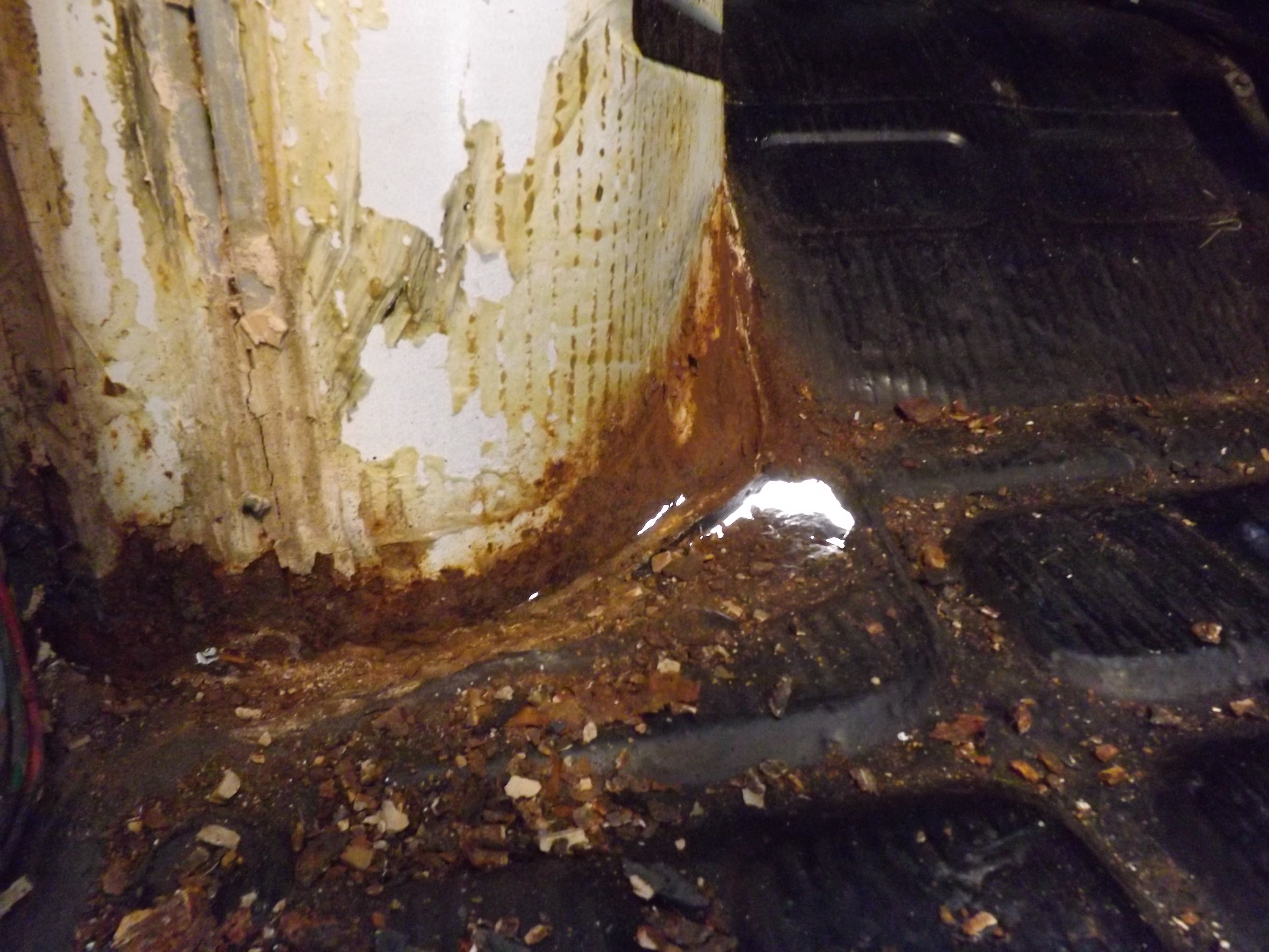

Just to give you a bit of background leading up to this restoration we bought Paolo about 18 months ago in as original condition. He'd had a respray at some point (I don't know his original colour it's missing from the chassis plate) which was adequate but not amazing. We changed to a 650 engine and syncro gearbox last year and to be fair we were really happy in him and he didn't really let us down. On this years MOT however he failed on excessive corrosion. Left hand floor pan was particularly bad with a hole right through. Right hand was not much better and the panel which houses the battery bay had a repair on it which was basically filler!
As gutting as the news was we decided to bite the bullet and go for a full resto. I didn't want to repair a couple of panels and have the same situation in a couple of years time.

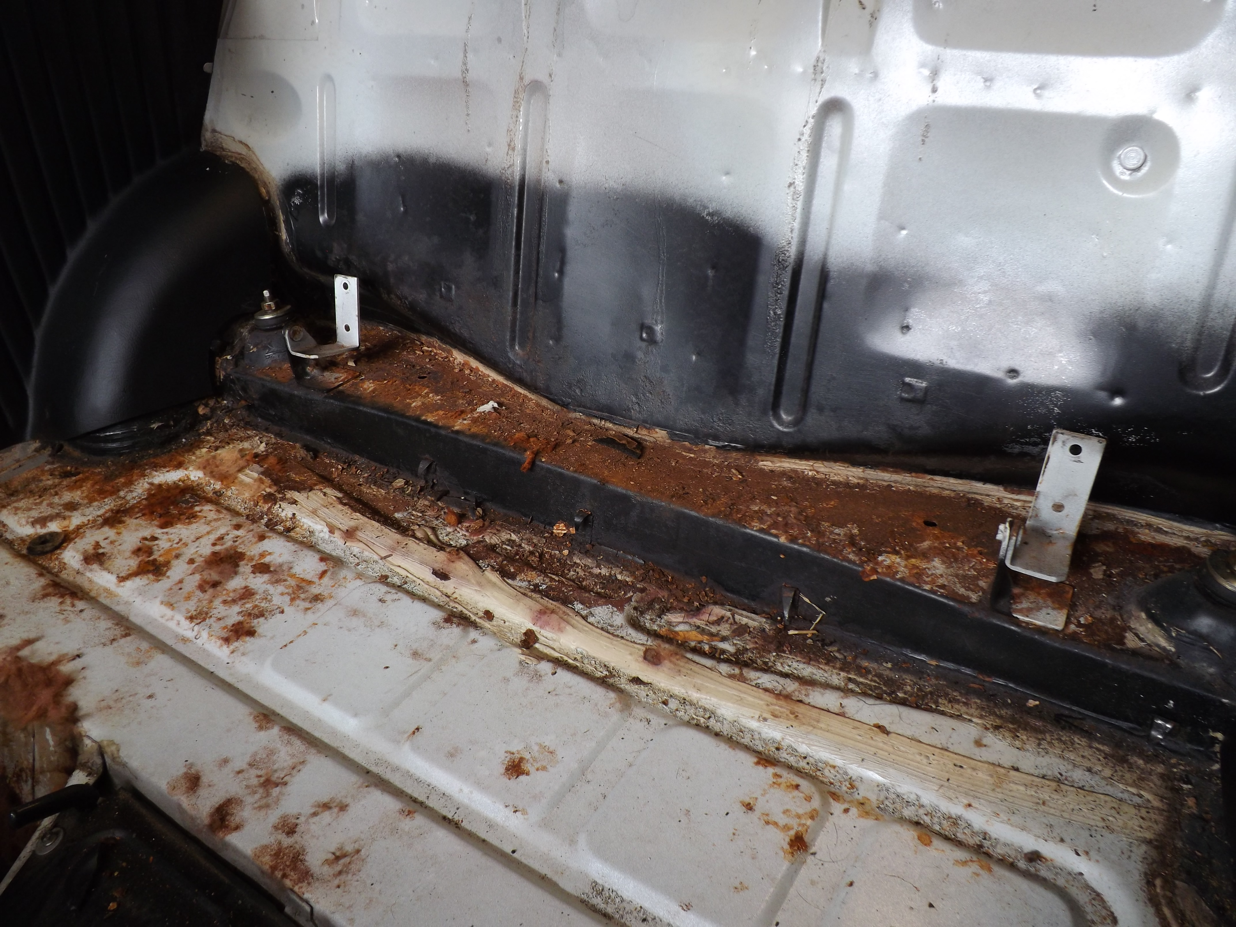

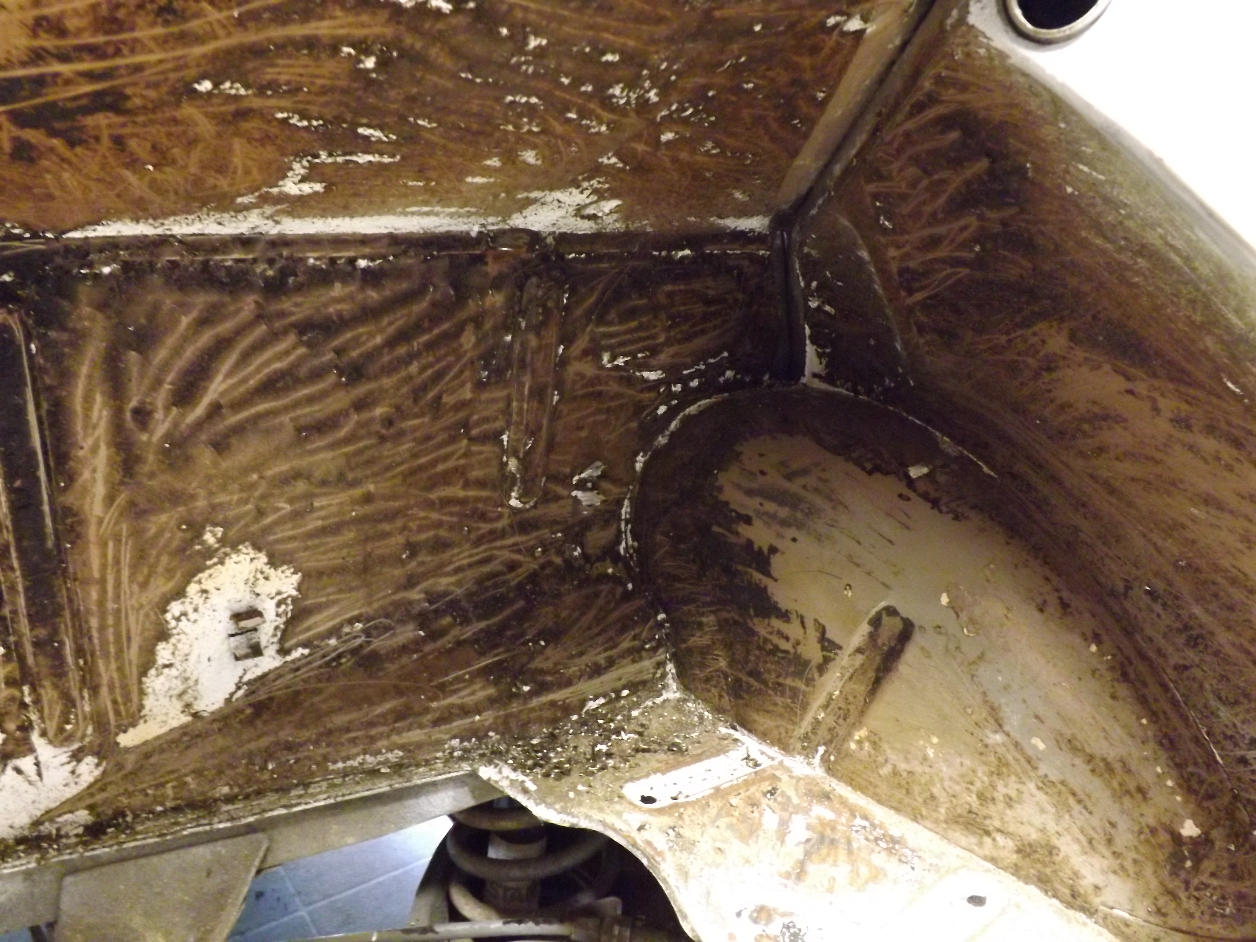

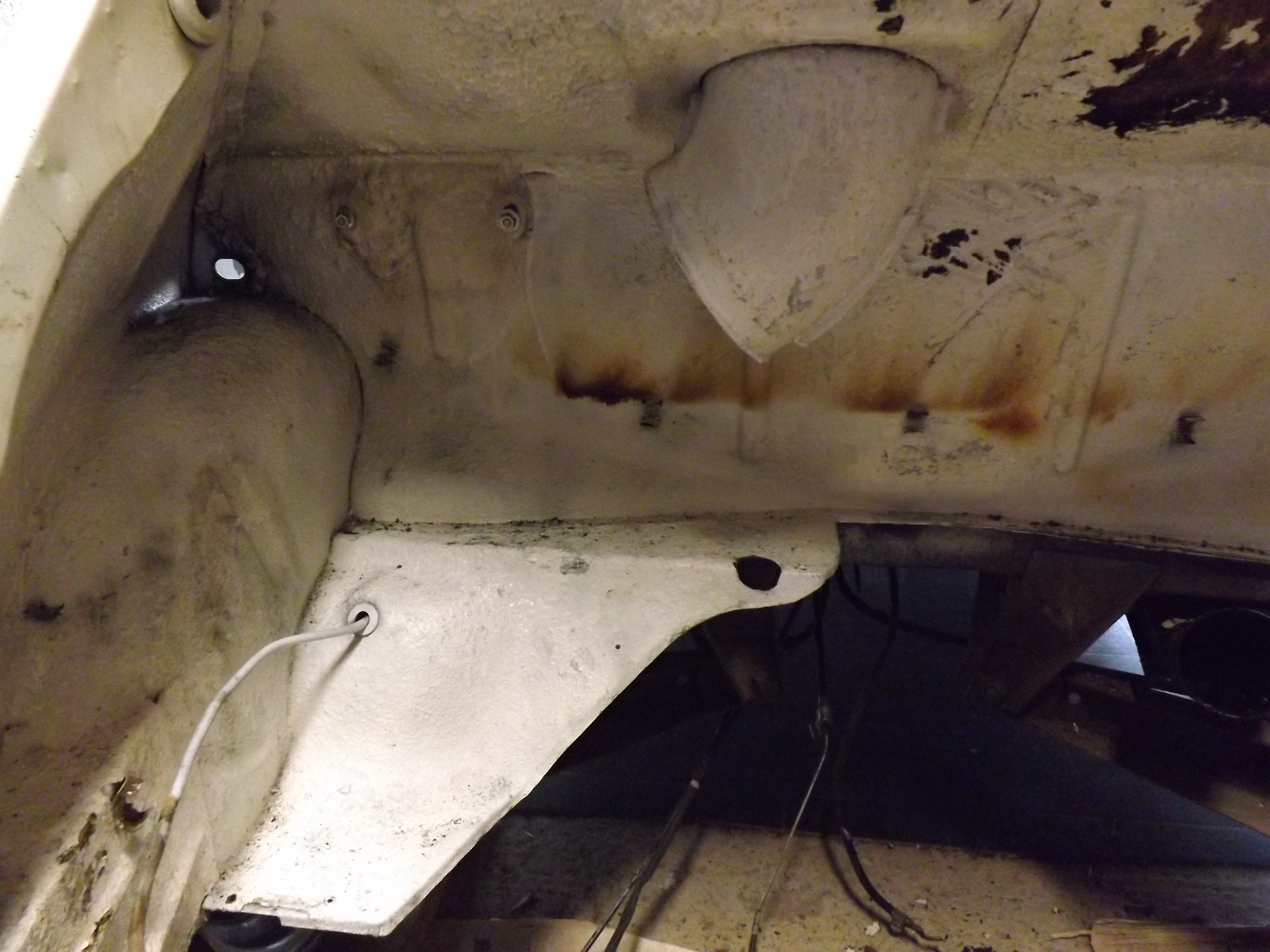

So a little bit more progress over the weekend. Got the engine and gearbox out and then thought I'd start stripping from the rear going forwards. My engine bay is covered in that protective gunk that makes the surface really rough. I can see the advantages to having a coating but I'm in favour of a nice clean metal finish. So the arduous task of scrapping it all off begins! Some areas just scrape off and others have to have some heat applied. A bit of a pain of a job but needs must. Also took all electrical bits from the rear and threaded the loom back into the car. A before and after picture of the engine bay.

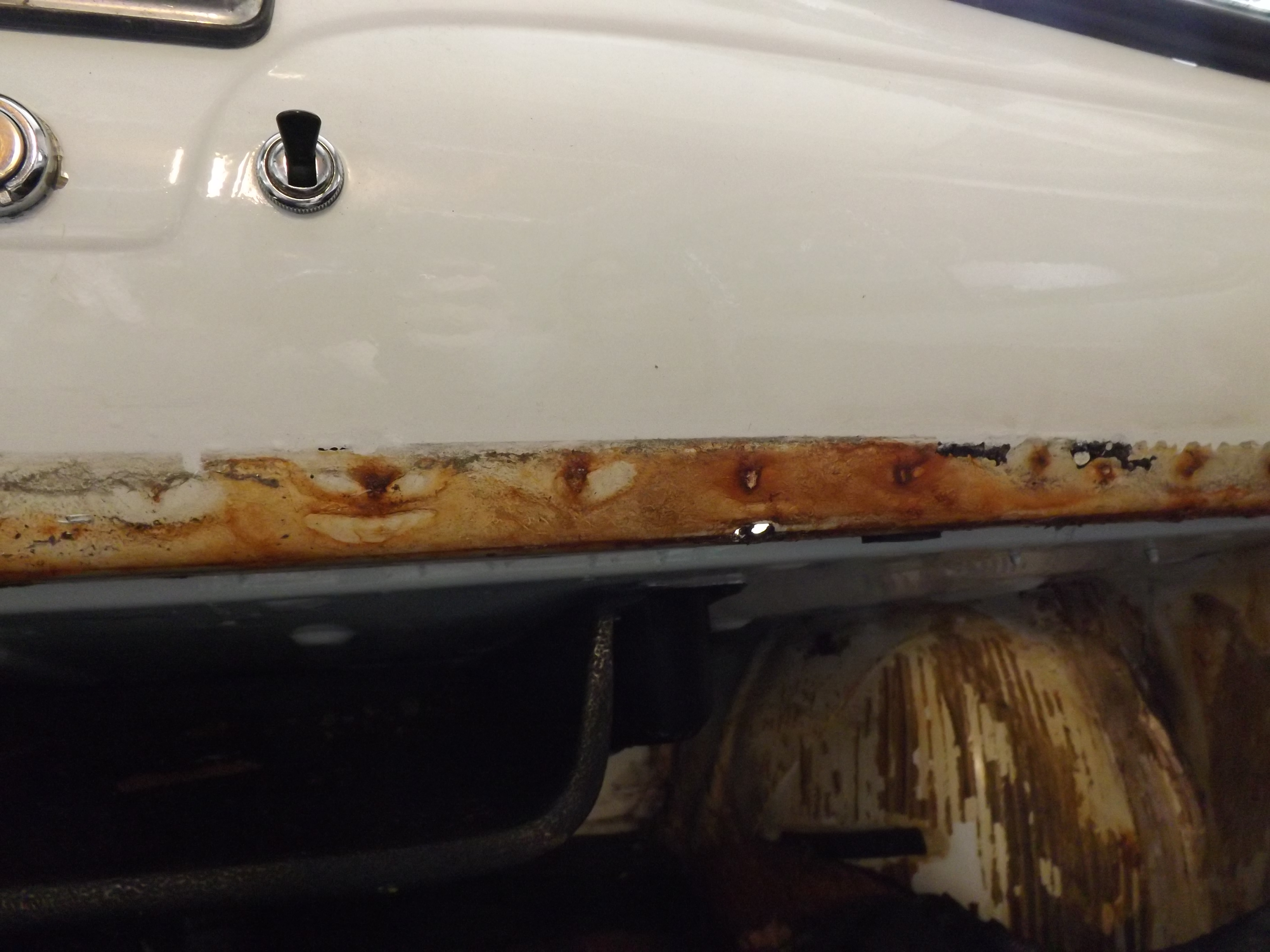

Also got around to removing the knee pads only to discover that they were completely rotten. The last spray job had taken place with the knee pads in situ and masked off. Pictures show the damaged knee pads and the dashboard surface corrosion.
So I'm plodding along at a leisurely pace and so far I'm quite enjoying it. I'm glad we decided to go down this route and although it seems like we've got a mountain to climb at the moment I know the end result is going to be worth it (I hope)

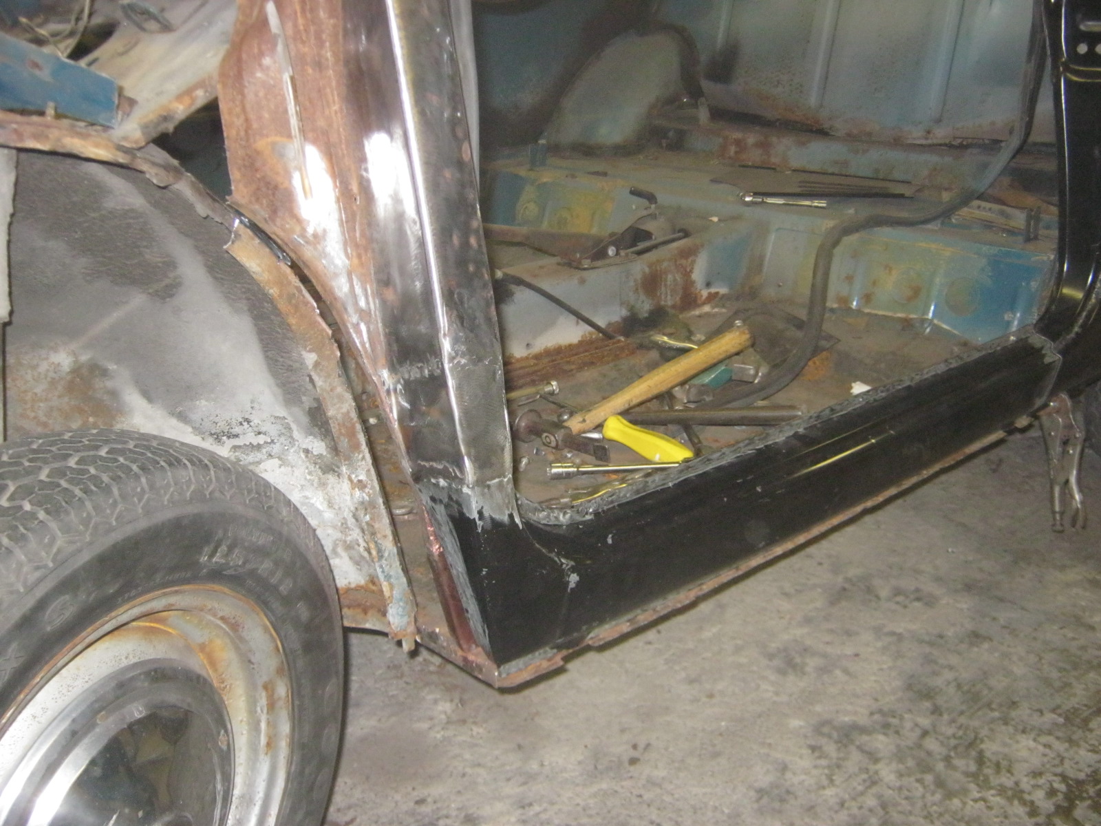

After more stripping and prodding I've now discovered I need to add replacing inner and outer sills to the list. No point cutting corners and I guess if I'm replacing the floors I may as well. Not that I have much option with the holes in them!
Damian,
I have just done that job. It's a great feeling when you get the new ones in and everything starts looking whole again instead of just holes!

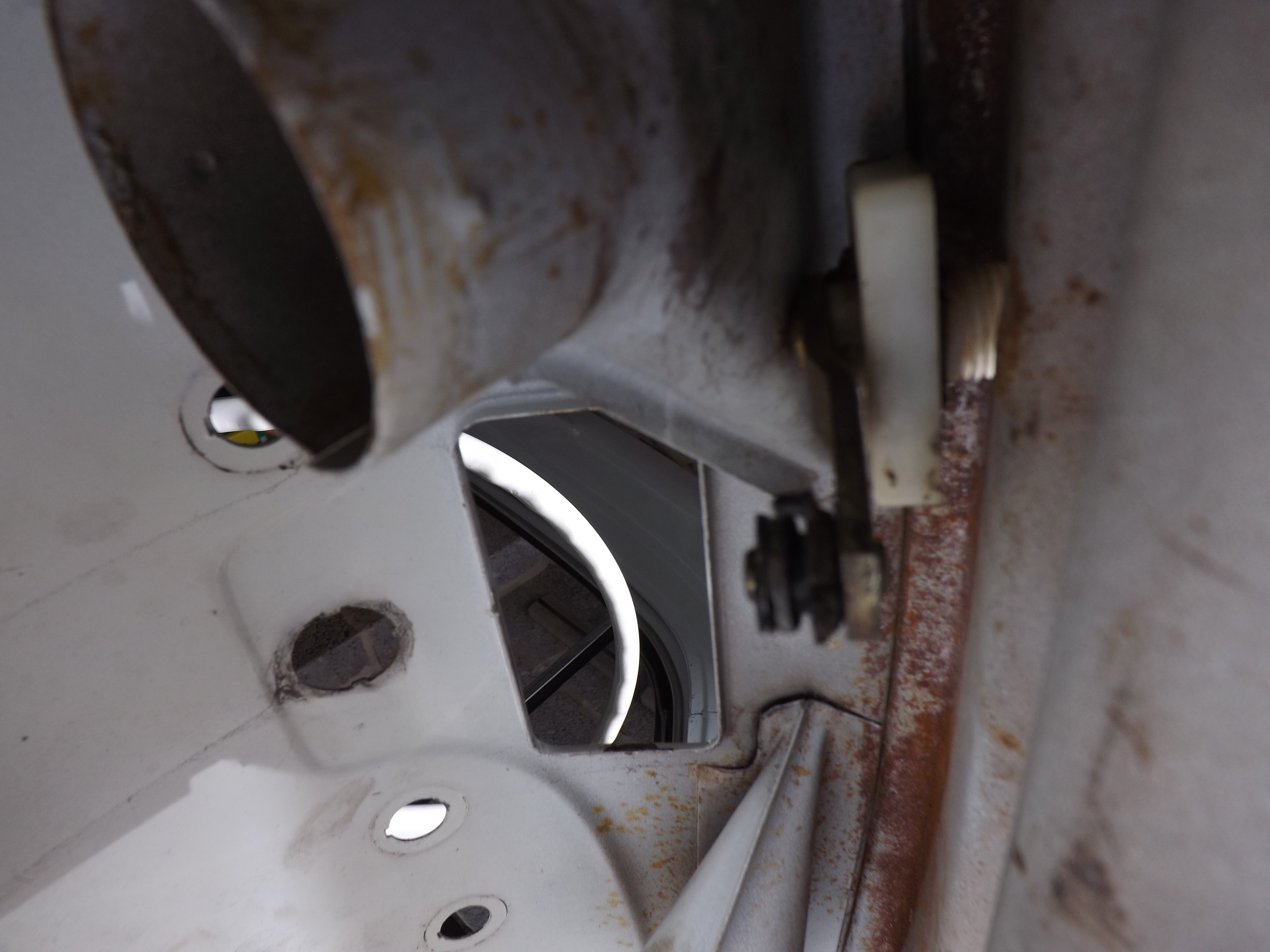

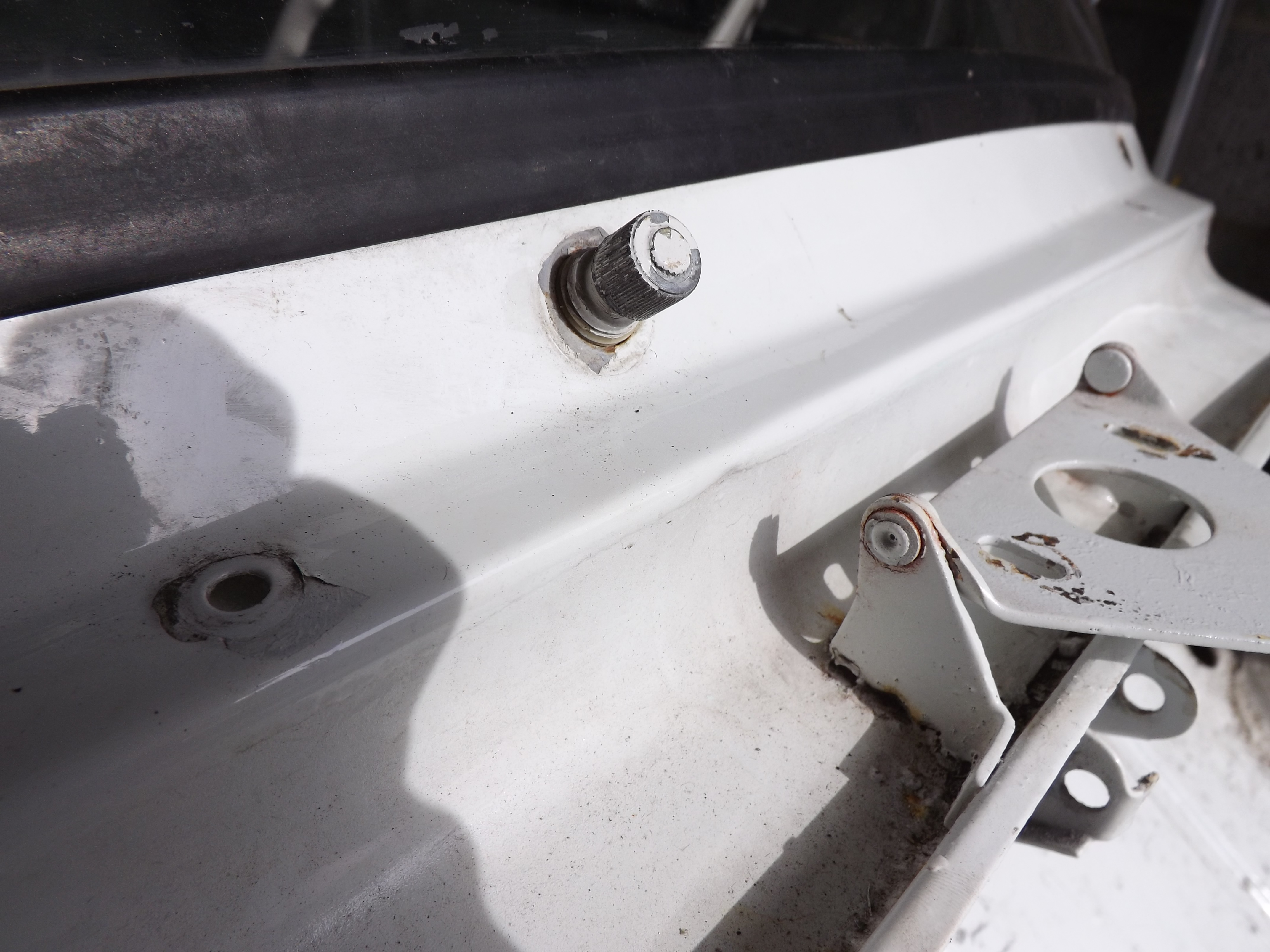

Still stuck on a couple of issues which I hope you guys can help me out with. First is getting the passenger side wiper splined shaft off the car. Get's half way and then get's stuck on vent cowling as you can see in the photos
Don't mind doing some damage to get it out as this can then be fixed but it needs to go back in nice and smooth as I can't damage the new paint work. Anybody had a similar problem or am I missing something blindingly obvious?
Still can't see how to get the front panel off without doing some damage to the front wing flanges. Anybody who's removed theirs, how did you do it please?
Damian, it looks like you might have an adaptor on the wiper spline which I haven't seen before. If you can extract that you will have a very dainty spline and the idler mechanism should wiggle out.
