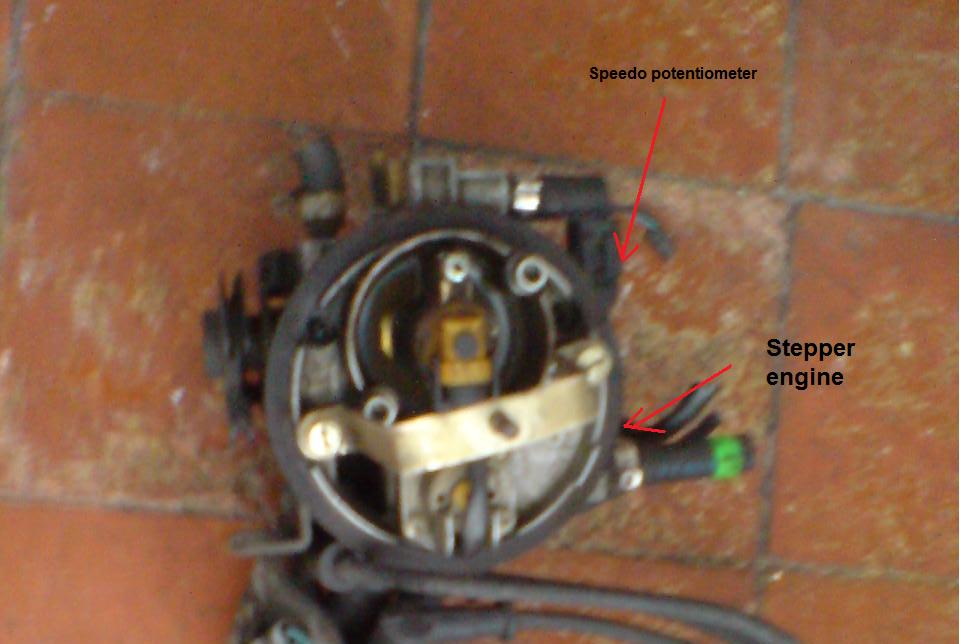

My suggestion with this new evidence is that this has been rigged to allow the car to run and mask the problem a little bit. Perhaps that guy was right when he guessed that the idle control valve had stuck. In this case, it looks like it is stuck closed.
To help you find it, I am re-using Jangcy's picture from earlier this year where the idle control valve is marked as "stepper engine".

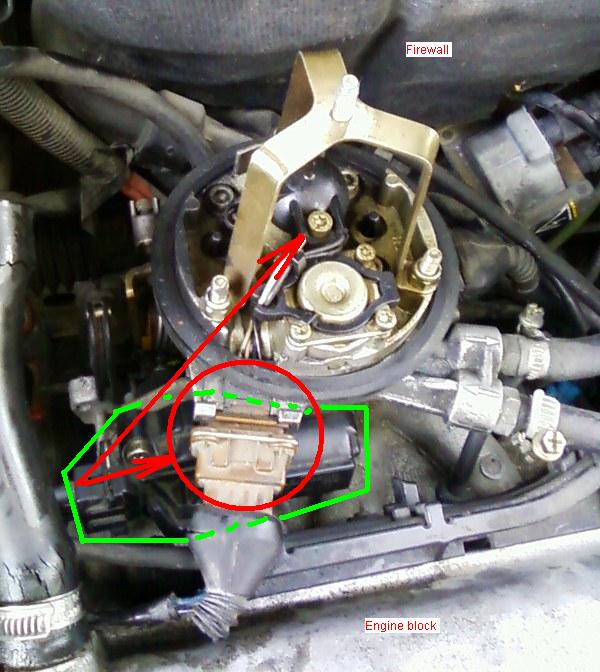

After yesterday's smuggling around car there is some baaaddd info. It is about idle servo (n) so if admin think that the quote should go on in "Idle problems" then it is free to move.
What I figured so far (Manuals are still somewhere on royal mail :cry:) is that the main problem with high revs is not in but on carb.
I removed the idle servo and opened it. The thing is build very simple for the price of new one (210€ :bang:). Anyway I discovered that the servo drives OK (forw/back) but I noticed that just one pair of connector contact is working. I measured the resistance on all four contacts and it seems that the second pair is dead. Is this right?
I didn't measure the car connector because I don't know if it is safe -> I am not keen on flashing under bonnet :D
If you look pictures there are two circles. The green one is servo...this expensive thing was removed and checked. Two connectors are dead, two aren't (I drove the servo by changing the polarity on the "healthy" pair). Why are the "dead" connectors for I don't know.
The red circle and arrow stands for "Does anybody know what is this and how it works?"
OK, this is only one part of problem. The other part is the understanding of the first part :eek:. When I put back the servo and turned the ignition on it stucks in the half open position (see the pic) also after the 10min driving.
So pals where do you think the solution is? In dead cables, dead contacts, Bosch unit, red circled part,...?
BTW sorry for novel length of the post :D
