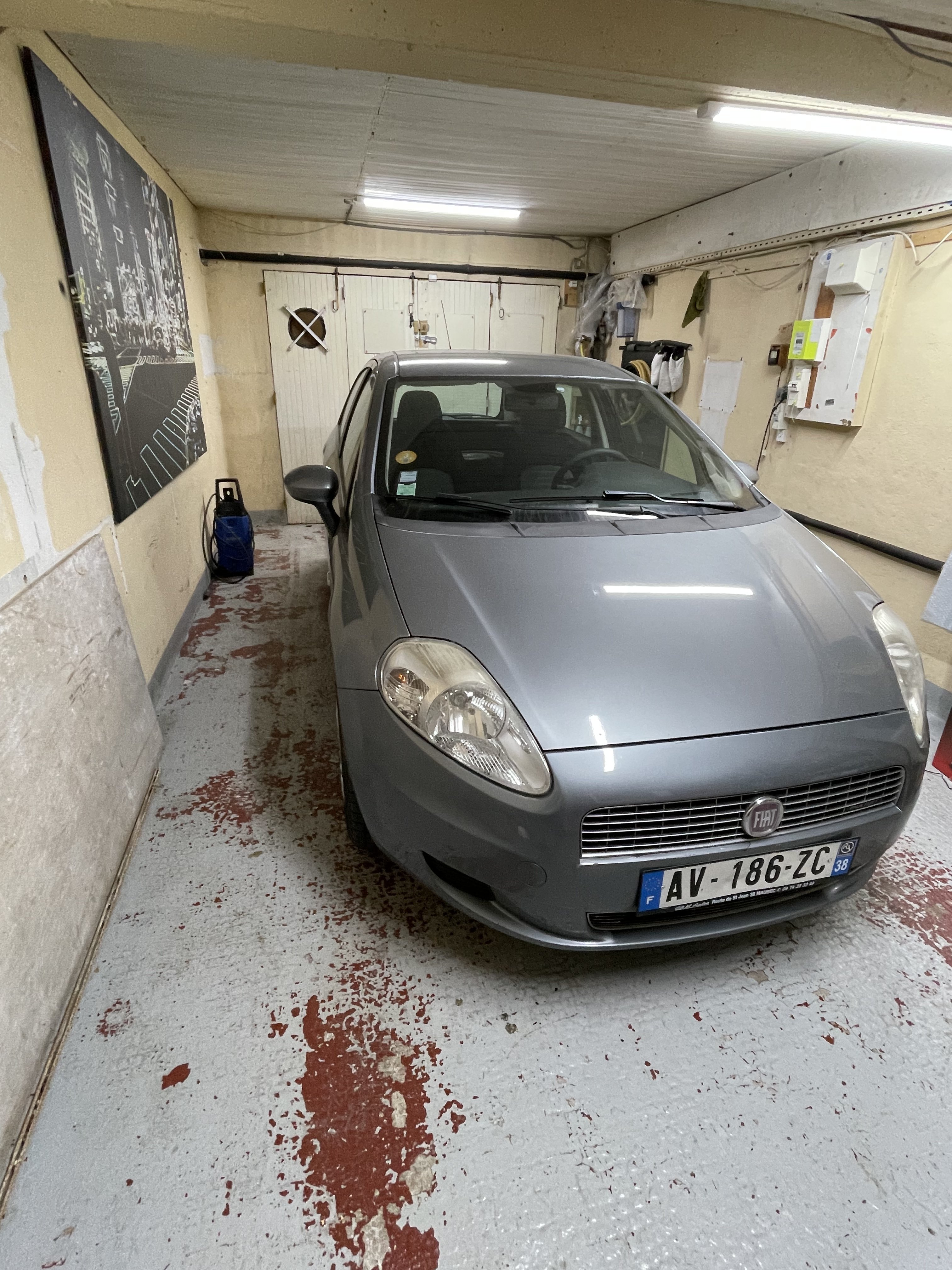

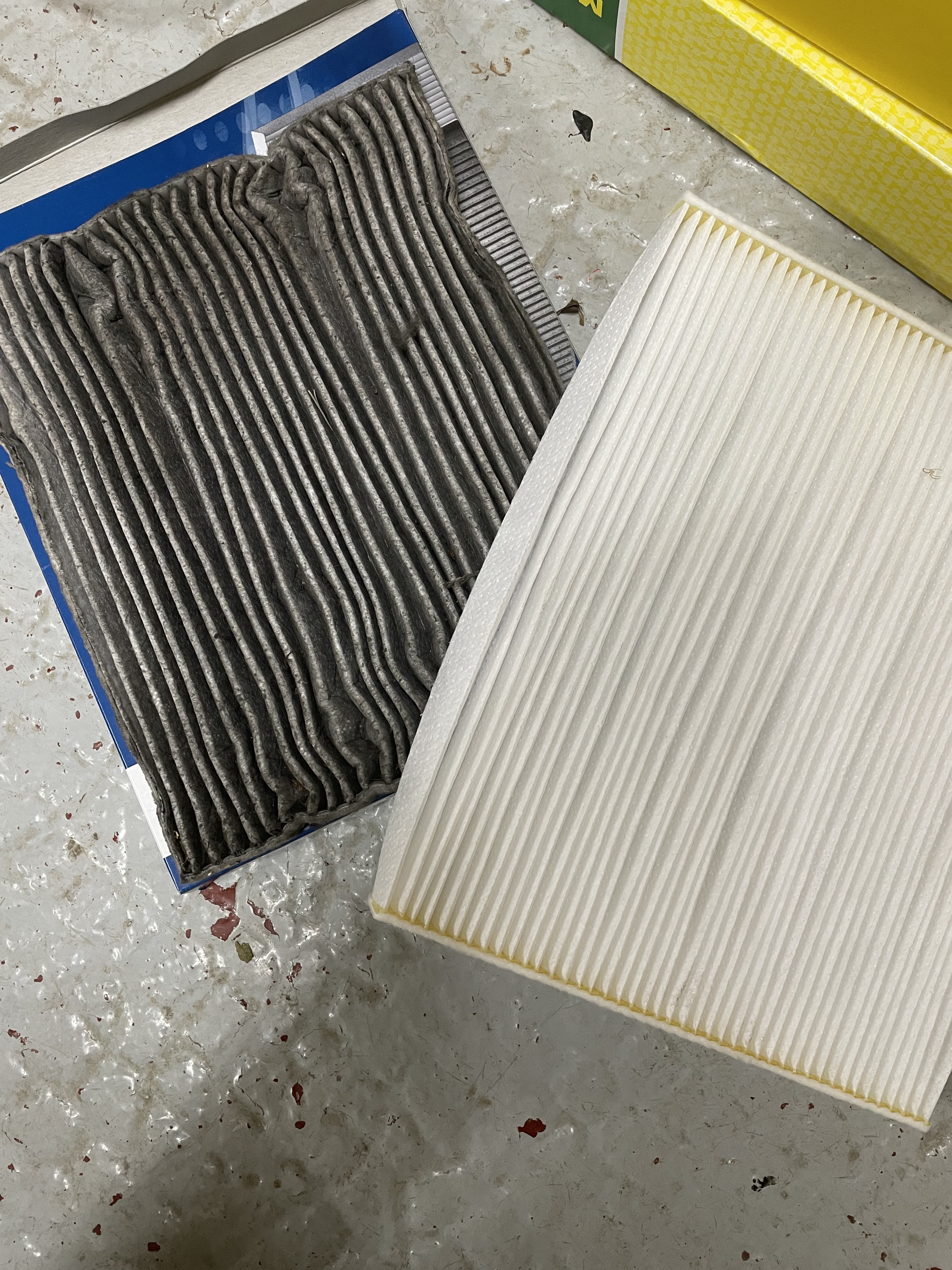

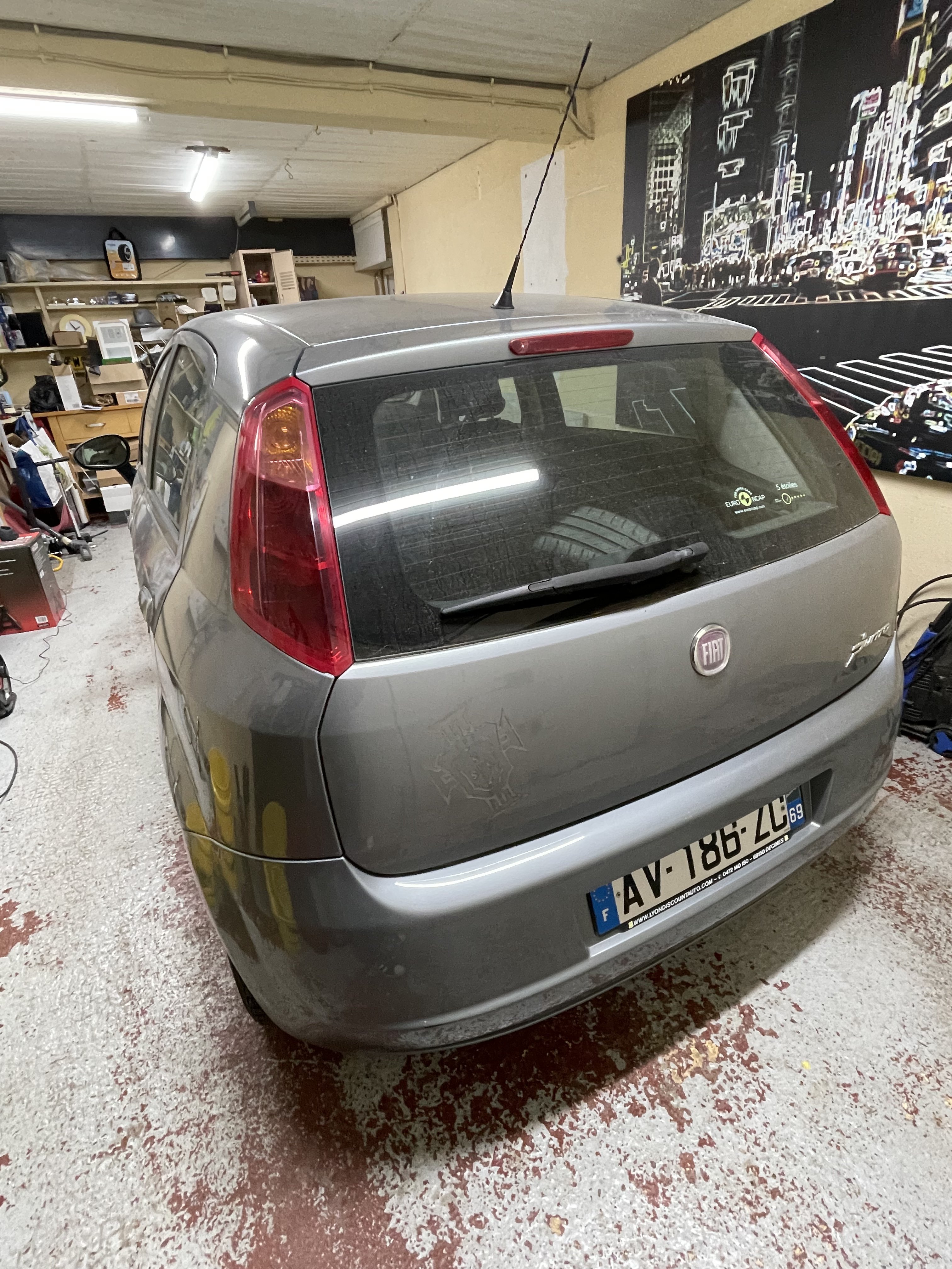

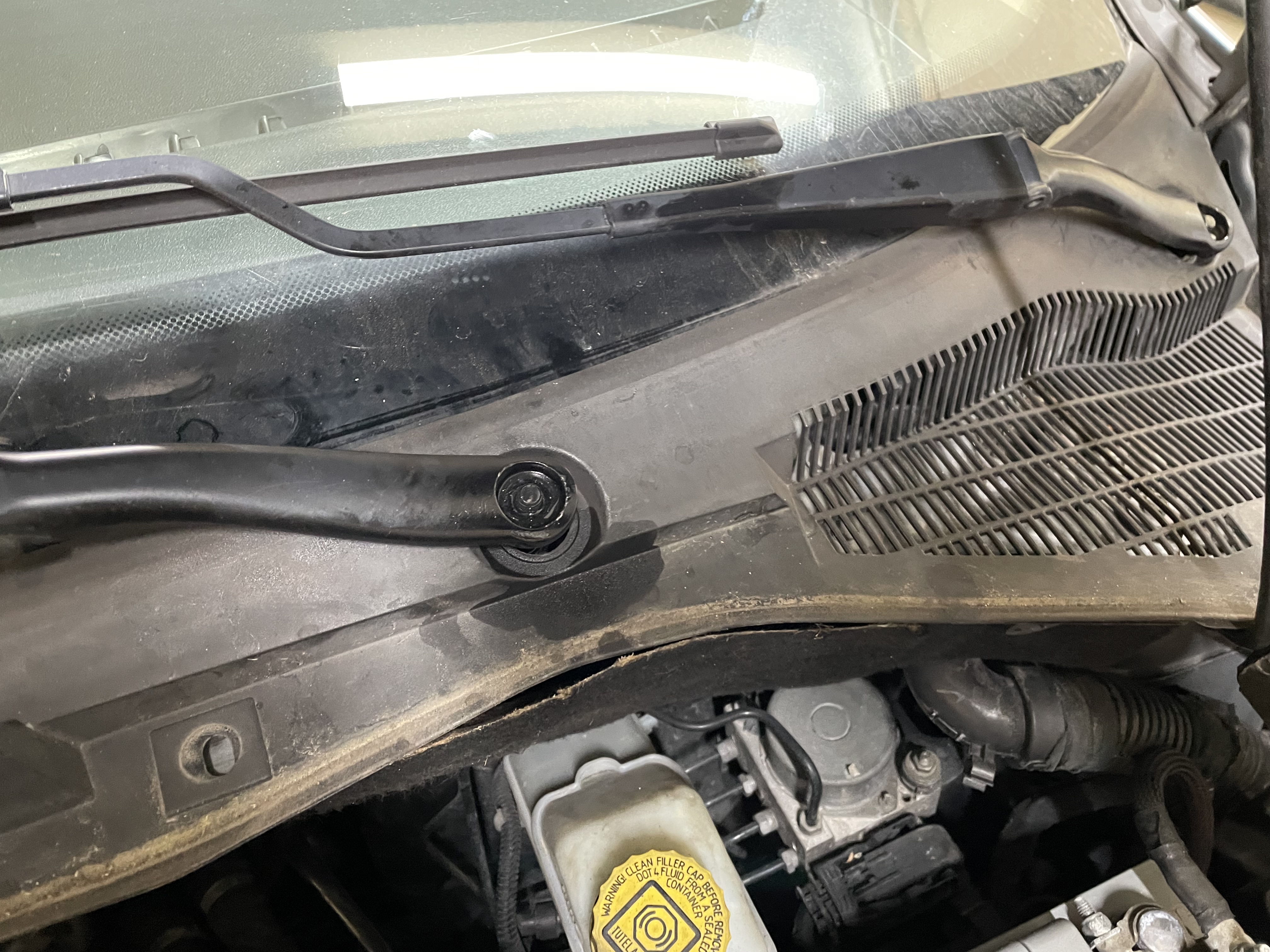

So it arrived Tuesday… a lot of cleaning going on. My first task was cleaning out the scuttle - can I get the wipers off!!!! Can I f&@£& I have pooled in wd40 since Tuesday. Not budging…. Pollen filter filthy but the coolant very pink/red and the brake fluid looks ok but the clutch biting point is low and a judder when it drives off. Receipts show a new clutch in 2014 - so I am hoping not. The juddering could it be a engine or gearbox mount?

When I had the scuttle cover off my 2012 .. to gain access to the Shock towers..
I had to use a puller to get the wipers off ( I actually had to make one.. as Ive NEVER had to do this before.. my 2008 Gp wipers came off ok.. but may have been disturbed before I owned it..)
My guess is they are fitted dry in Italy.. and 10+ years of 'sitting in a puddle' gets the corrosion going a treat.. :-(
