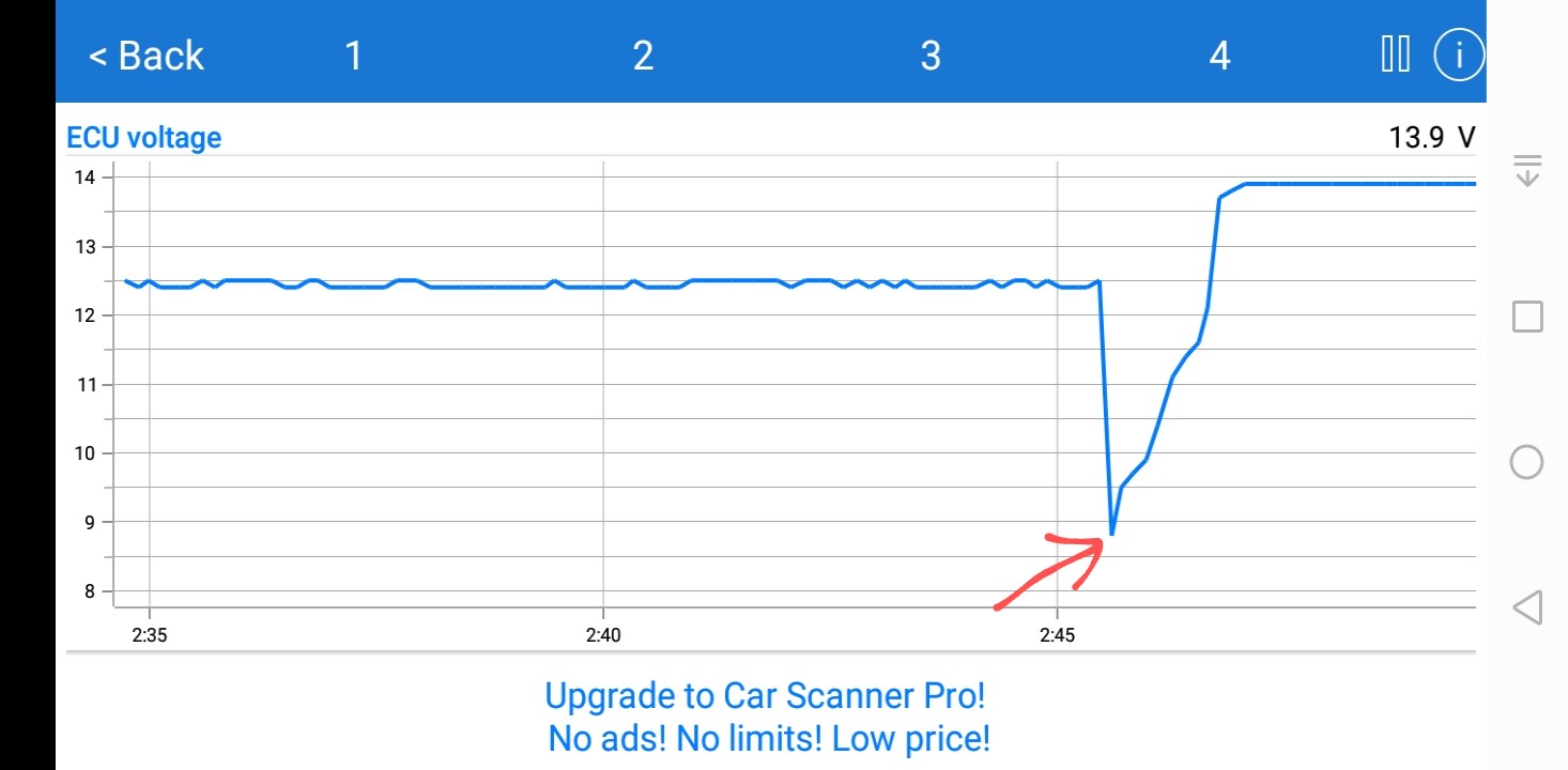

Use your scantool plot the battery voltage as you crank the car
Here's my old tried battery
I do not have a beautiful graph as above, but the battery got 12.11 Volt in rest, drops to around 7 Volt when starting and when the engine is running it shows a quite healthy 14.3 Volt ..... is this battery in healthy condition or is it going a bit worn out already?

They do sag quite considerably as soon as the key is turned and before the starter starts turning about 8V would be normal
At this time of year in the UK I would expect the resting voltage to be between 12.4V and 12.6V
I wouldn't expect it to drop as low as 7V on a petrol panda at 6.5V the body computer will reset and the clock will loose its time
To me it's looking like the battery is past it's best
Correct 14.3V is healthy charging

Sounds spot on
Dropping to 10.5v is correct
Resting voltage of 12.4V is correct
Charging voltage of 14V is normal
The amount of charge is controlled both by the internal regulator and the body computer
Voltage is normally around 14.1V give or take a small percentage, also depends what electrics are on and how charged the battery and if there is a high load also the revs
My three pandas have read 14.1V when measured with a fluke meter across the battery and no electrics on, and a bit less when measure via the obd elm327 in fact if you look at the one I posted earlier it shows 13.9V and that's a fully functional alternator that ran for another 2 years
