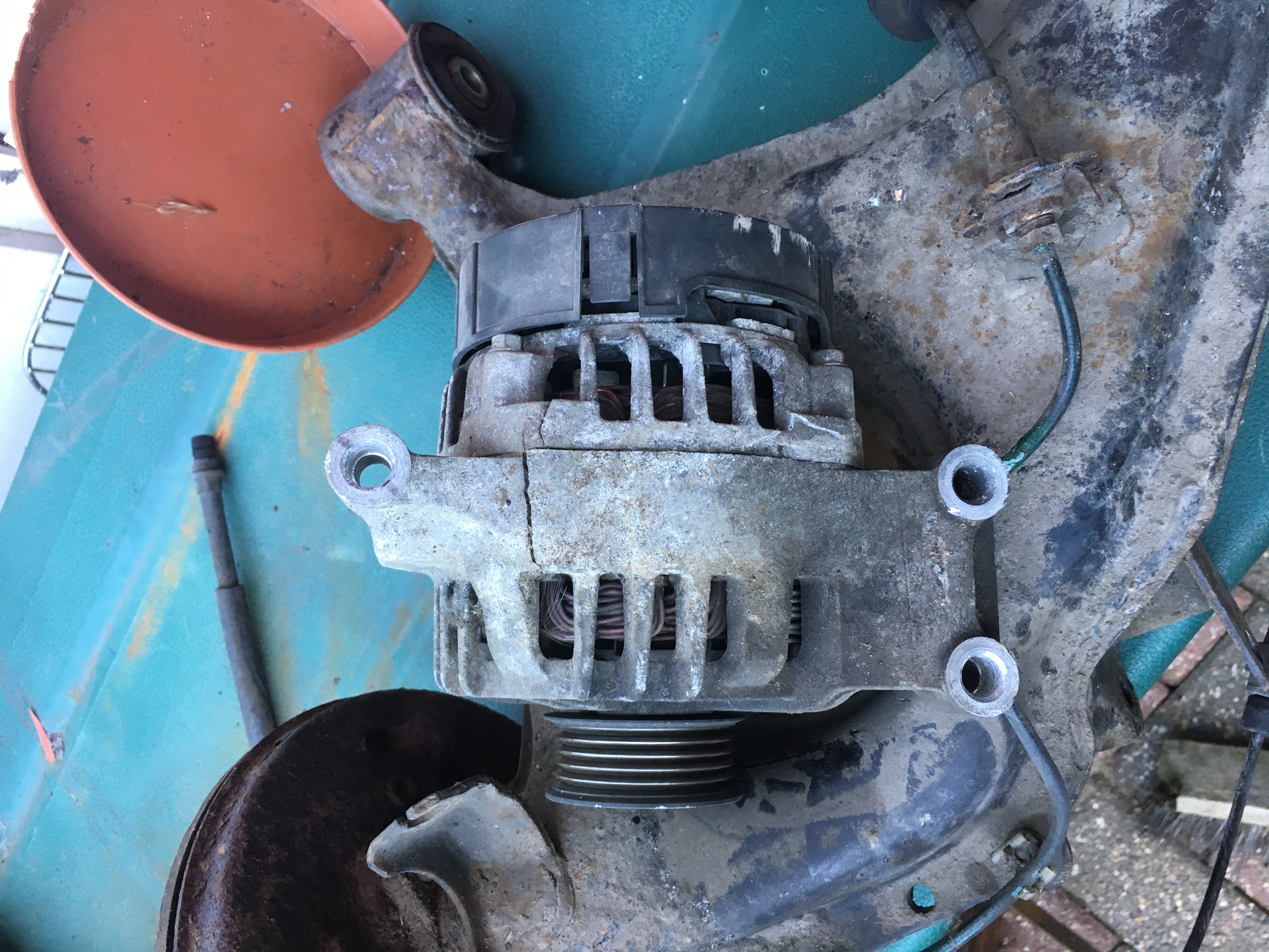

Hi people, I have the same problem with the power steering light on and off but the battery light is always off. Somethimes the ABS and yellow triangle are on along with the message "fuel cut off unavailable".
I checked the alternator today and it outputs 14.16 V. The battery has 12.02 V when engine is off but the internal resistance is quite high. The electrician said that is still good but is worn out.
Do you think this is the problem? Thank you
