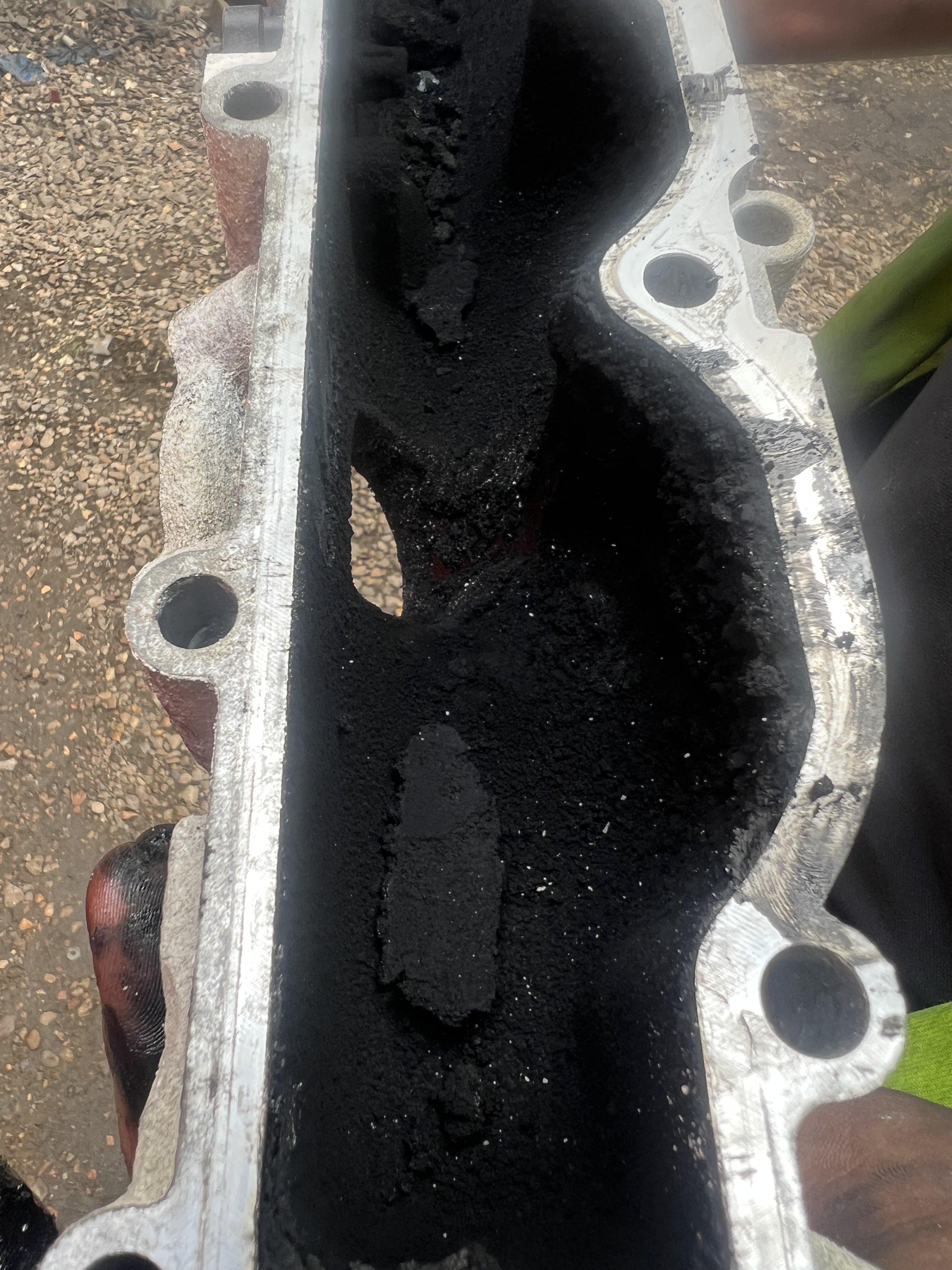

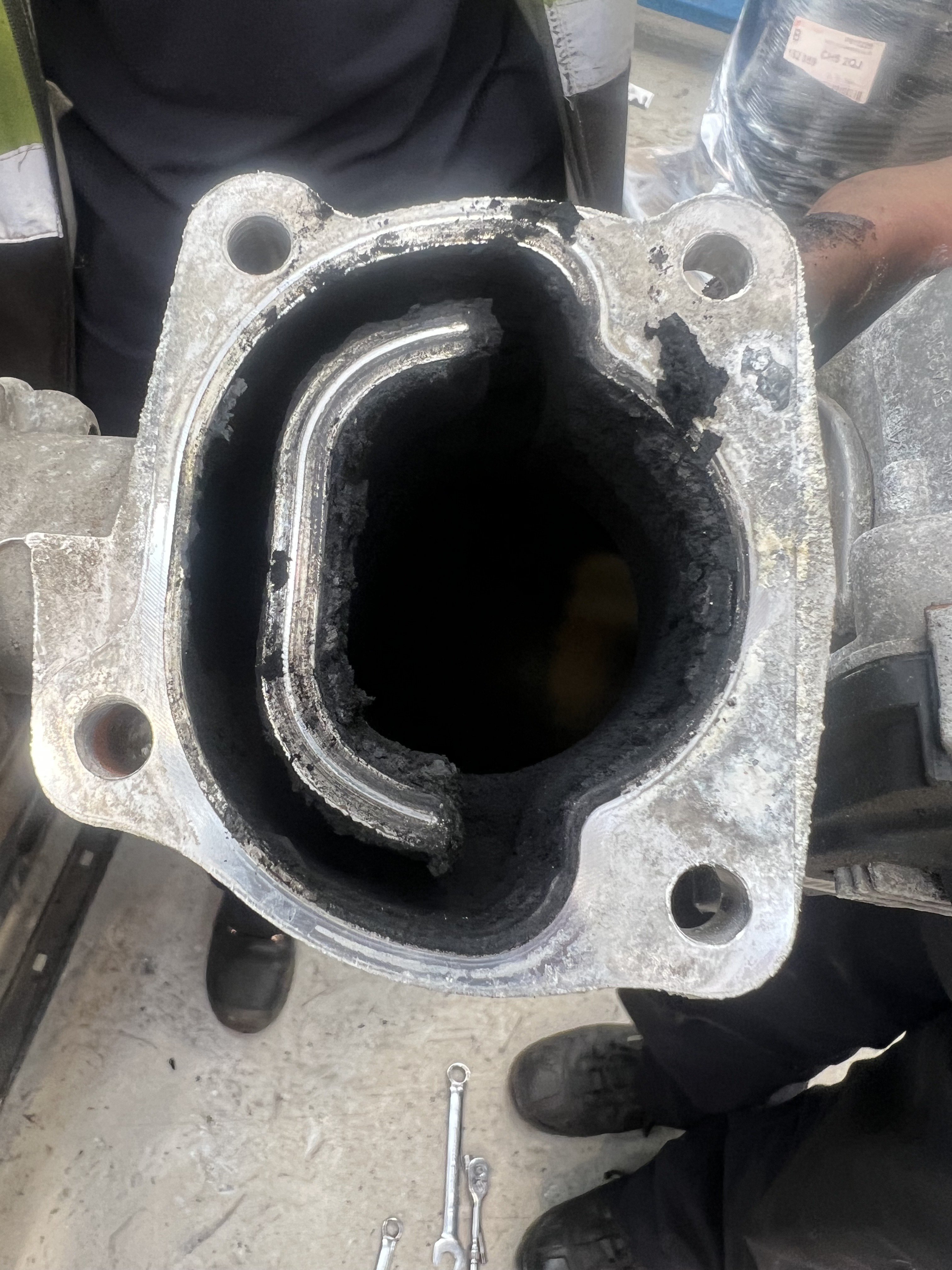

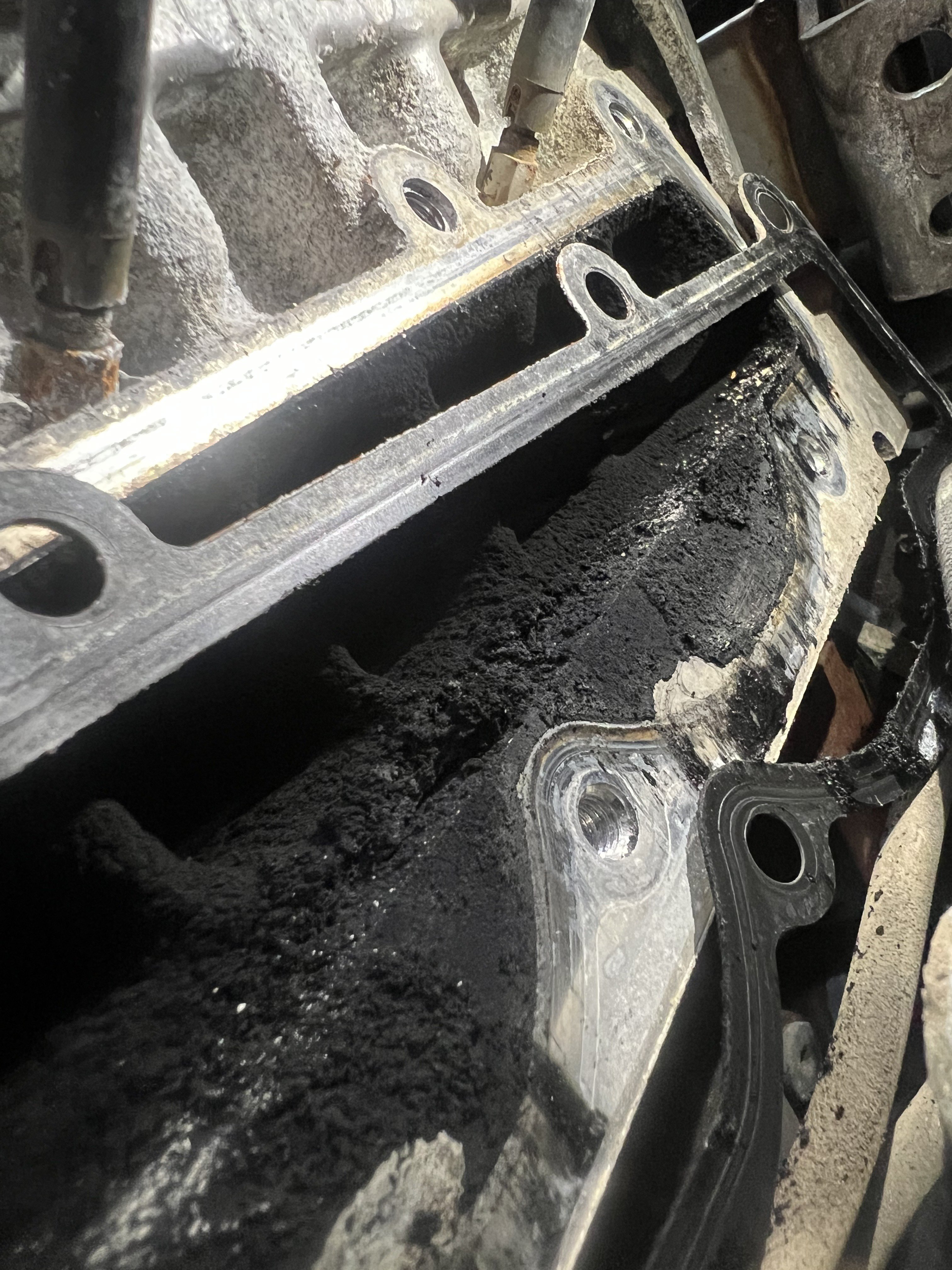

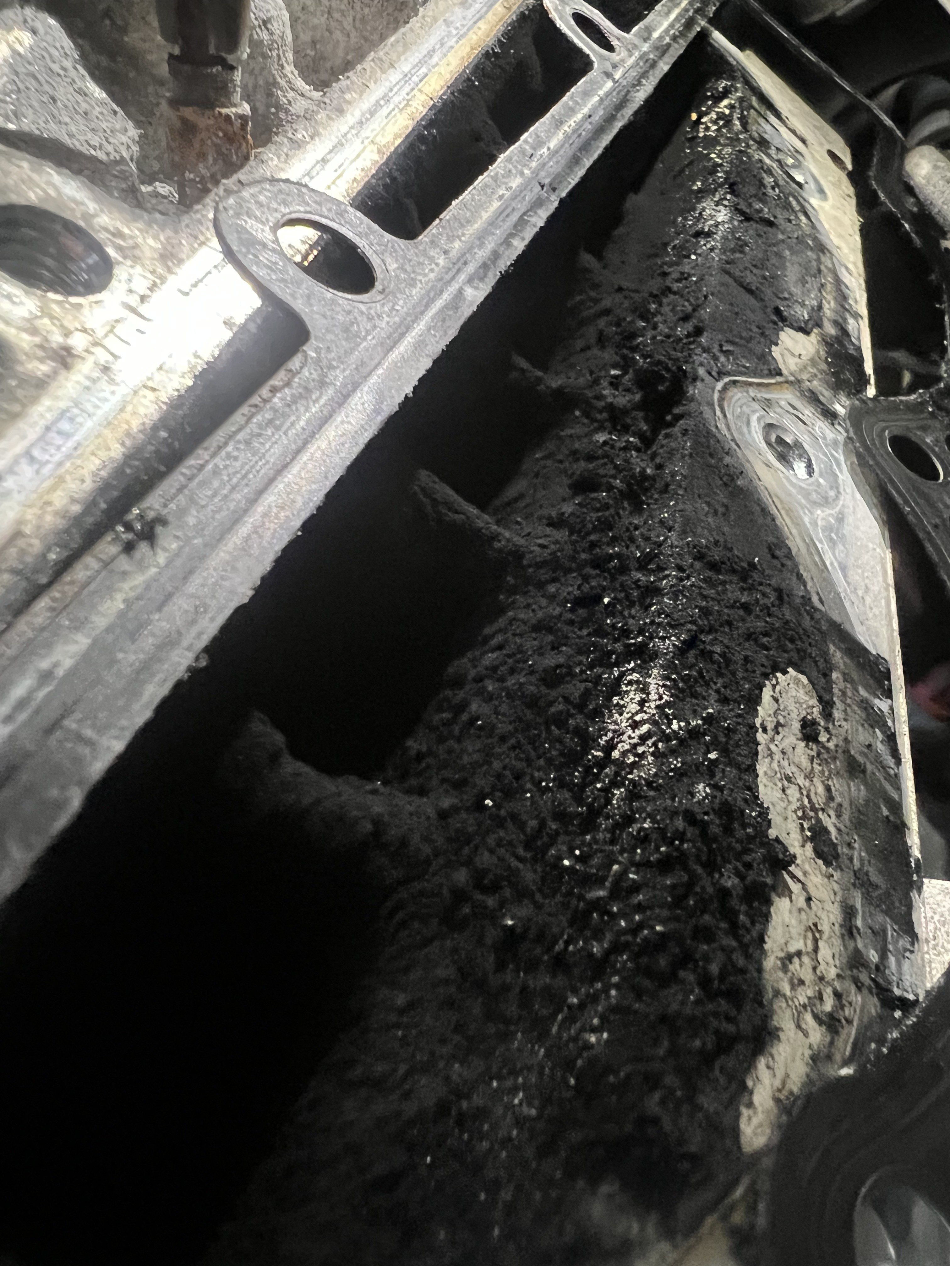

Hi , posting as really fed up at the moment! Our 2011 nexxo t660 amber engine light came on about 7 weeks ago now and had no power. Okish on the flat but any hills I needed to change down to 2nd! Took it to our local garage who did diagnostics and said it pointed to EGR issue. I had a warranty provided when i bought it so thought great go ahead. They checked the EGR and it was clean so wasn’t causing the issue apparently. The warranty wouldn’t cover this as wasn’t faulty. £250 down. The garage then said it would be best if I took it to a Fiat dealer who have a specific diagnostic machine. Took it to one 45 minutes away at £110 an hour . Couple of weeks later said they needed to take manifold off and they found it caked with carbon-see pics. Said they cleaned it and took it gor a test drive and sorted -£700. Also told me as van was 2011 the Fiat diagnostic machine didn’t work on ours so used snap on which I think my original garage use but only charge half the price per hour!
