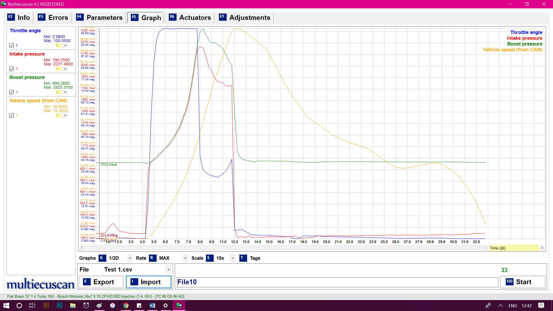

About graphs, I have made two runs - first at 3 gear , and second at 4 gear. Just not have been sure which is right.

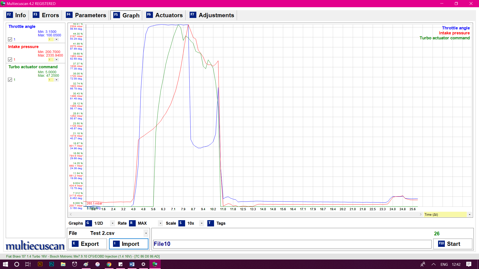

I have some other questions now.
This graph is made at 3 gear from 1000rpm.
1.Is not the boost pressure too high? It goes up to 1.5 Bars. Were are the boost pressure sensor located, maybe at the pipe before hose that going to diverter valve?
2. When changing gears at 3000rpm or higher a hear this whistle noise from air going through turbo charger. That mean the compressed air can't goes fast enough through diverter valve. Is that normal or what?

You need to compare "desired boost pressure" with "intake manifold pressure" (which are close enough to each other.)
The "boost pressure" value is the value of the boost before the throttle plate... basically the pipes from turbo to just before intake manifold.
I'd be interested in seeing another graph with desired boost, intake manifold pressure throttle %, and rpm. ("boost pressure" seems a bit to much...maybe throttle isn't 100% opened or there's another problem .... on the wastegate side.. solenoid.. or boost lines... or something there).
Play with the scale..and make the graph as big as possible. (now it's set at 10X).... not sure if you need to select 100x or 1x. Give it a try and make the graph show up wider on the page.

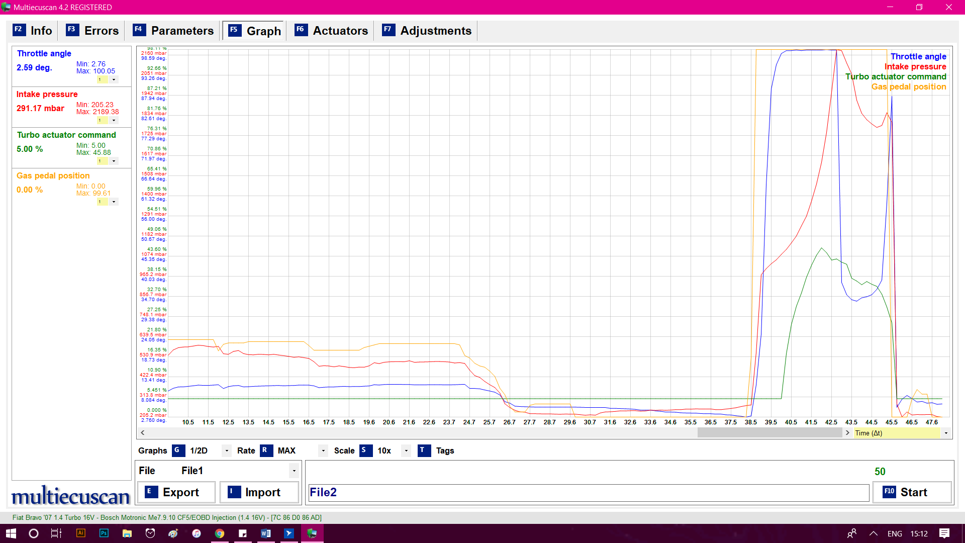

Hi! I just want to confirm situation with boost cut. I had the same problem with my T-jet. Car was producing woooosshh nosie when throttle was fully pressed. Acceleration was poor after woooshh noise. I was thinking that some clamp is loose or something, but it wasnt. After running MES i saw that throttle is closing after boost rises to high. I have changed three way waste gate actuator and problems were solved!
Here is the graph:
http://uploadslika.eu/image/gmXas
I would like to put some tags for people with same problems, because i spend a lot amount of time to find this thread
Tags: boost cut, boost problems, wastegate, waste gate, differential valve, T-jet, tjet, 1.4 T-Jet, turbo noise, pressure converter, 46813571, bad acceleration, poor performace
Here is graph when three way waste gate actuator was changed, i think it looks ok, any comment is appreciated. I think that graph should look like this when everything is working as it should.

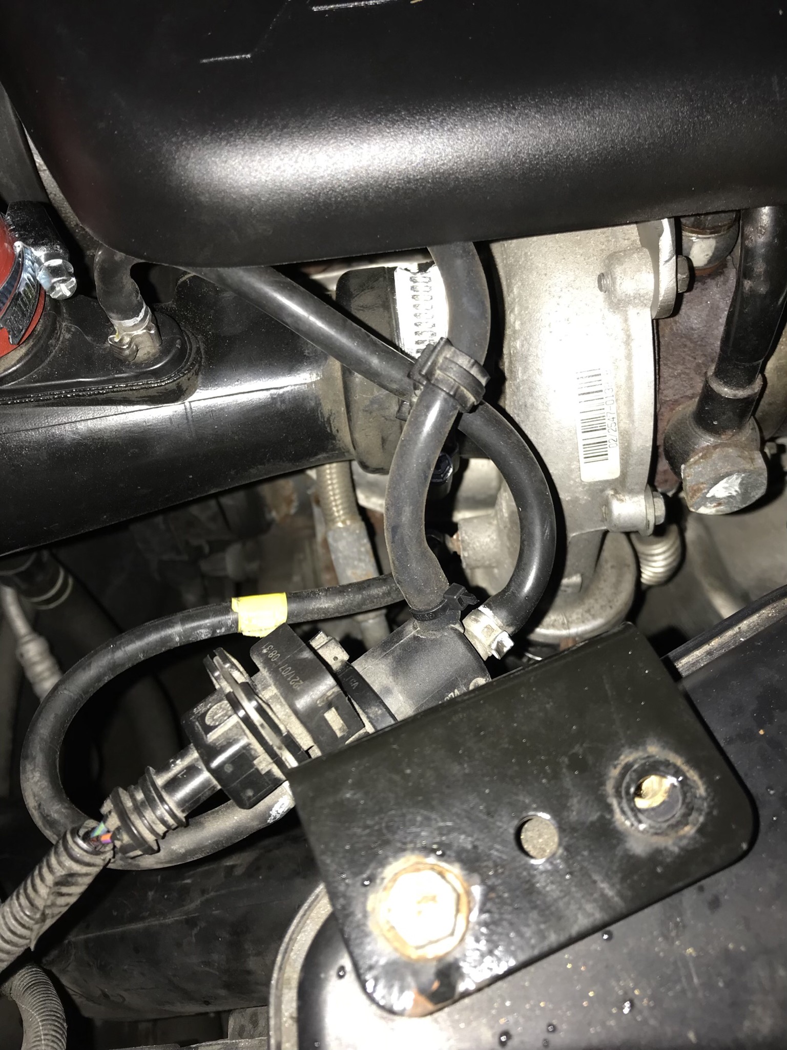

Hello, i have some problems with my bravo 1.6 multijet. I’ve changed 2 weeks ago intake manifold to new magneti marelli original one.
I ask mechanic to clean throttle body and egr After 400-500 km or one week later i feel like my car wants to stall on idle. I saw several videos around internet and groups on facebook fiat bravo italia and i changed throttle because as i saw on my cheap obd the vacuum was -5.1 to 9.5 psi.
I changed throttle and now don’t have more isues with idle but calculated boost show me always -1 to -2.8 psi. Car speed same and no problem with turbo or something but my problem now is the car on idle feels like doesn’t work good. Like two engines are working both. I think it’s wacuum leak and i don’t know where 🤦🏻
I saw today
Turbo Pressure Solenoid Valve and
Exhaust Control Pressure Converter i think they are working good because no errors on professional computer of mechanic.
I don’t know how to fix because mechanic tell me i don’t know what happened
