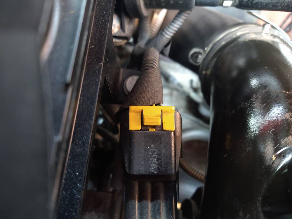

Hey guys,
1.4 Grande Punto tjet
I have a hate hate relationship with plug connectors that no matter how gentle I am they choose to explode lol. Before I attempt the connector I want to make sure it is as easy as it t looks.
Push back yellow piece > Press down & pull back.
Confirmation much appreciated [emoji16][emoji16][emoji16] IMG_20210812_160441527.jpeg
That looks like a lambda connector. Well, press the yellow part and pull the yellow plastic retainer clip upwards. Then wiggle the black part while still pressing its side and it should open fairly easily but these are quite stuck. Don't use much force. I've broken the yellow part of the connector myself and it still works though. :D
