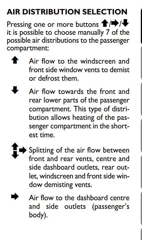

I have a very bad problem which makes me all time angry with the AIR DISTRIBUTION SELECTION .
Somtimes Air flow only to the windscreen and
front side window, and the Air does not flow towards to the dashboard centre and side outlets + a very noisy whistle . This happens from time to time
Can anyone help please.

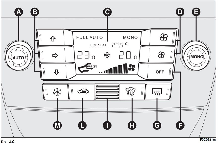

Try the self learn procedure.
CLIMATE CONTROL SELF-LEARNING PROCEDURE
The AUTO and MONO buttons must be pressed simultaneously within 40 seconds of the ignition being turned to the ON position in order to active this procedure. A few seconds later a figure will appear on the display (in place of the driver's side set temperature) which will count down to indicate the time remaining before the start of the procedure. At the same time (i.e. whilst the count down is taking place) the previous self-learning status is signalled on the passenger temperature setting:
'1' flashes if the previous self-learning procedure failed
'0' indicates that the previous self-learning procedure was successful
This procedure is not carried out if at least one of the above mentioned buttons is released whilst the figure on the left hand side is not zero (this is designed to check the outcome of the previous self-learning procedure).
Exiting the procedure zeroes the 40 second counting period from when the ignition is switched ON, to allow the procedure to be repeated without having to switch the ignition OFF.

Well, that all sounded interesting so I thought I would try it on mine to clear any prior codes.
Following your guide It started with the left hand side showing 03, 02, 01 then 00. I kept the buttons pressed in but nothing more happened, and as both sided were reading 00 I released the buttons. Immediately the right hand side then showed 02, whereas the left hand side stayed at 00.
When the engine was restarted the Heater seems to work fine, but there again it did beforehand. So I'm not sure what if any, benefit it all was :confused:.
Automatic climate control unit has common problem with broken plasic wheels. You can get repair set for them, but you need to remove dash board. (Or break your arm in two spots to reach everywhere). Or it could be bad electric motor controling the flaps.
Look for 46723463
