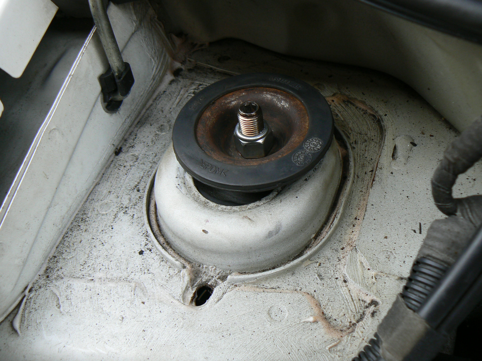

I remember being somewhat mystified by this when I first ran into it. In my younger days I was used to working on McPherson Strut suspension which had the top mounts securely bolted to the inner wing towers (Ford Cortina Mk1 and 2 for instance). Ours are not like that. The top mounts are not bolted in place and stay in place due to the weight of the vehicle bearing down on them. When you jack the car up so it's wheels come off the ground the struts and their top mounts drop down but are restrained from dropping right out of the towers by the large retaining washer which is held to the strut by the big nut on the damper rod. you can see this setup here in this picture I took of one of Becky's top mounts after I'd done a suspension rebuild:
These pictures were taken with the weight on the wheels. If I jacked it up the strut would drop until the washer rests on the top of the tower and performs it's function of stopping the strut damper rod actually just dropping out of the inner wing. When i first came across this way of doing it I found it very strange FIAT are not the only ones who do it this way and it seems to work fine.

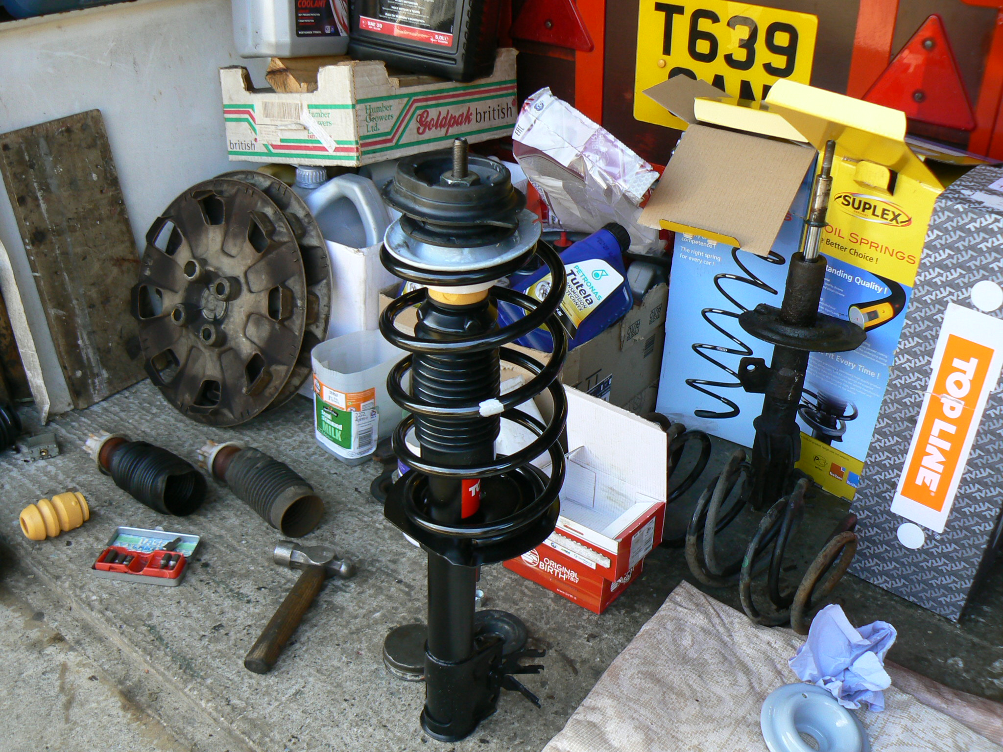

Here's what the strut assembly looks like and you can see there's no fixing nuts/studs on the rubber top mount. The top mounts can and do degrade and the springs can loose tension which will result in the vehicle staring to look a bit down at the nose. Mine was like that but after I'd replaced springs, struts and top mounts she now sits nicely level.
Even with all the new parts though, if tou jack her up the top mounts drop in the inner wings until those big washers limit the travel. That's just how it's made! By the way, slaister some grease or other anti seize on the exposed damper threads above the nut to stop corrosion - make undoing it much easier if you ever have to do it again.
