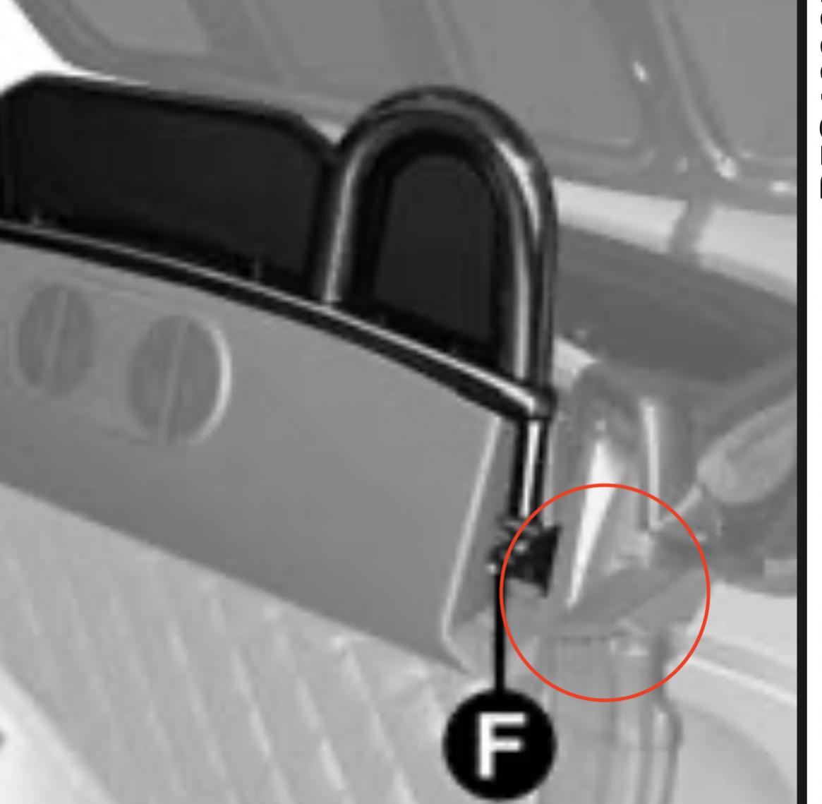

However I will probably need a full new top in the future, as it needs the rubber gasket seals all around the car's roof top replaced, and also it needs a left plastic doodad for the part near the seat belt - think it is this part http://www.barchettaparts.com/catalog/index.php?route=product/product&path=1&product_id=1263
Henk calls this a hedging convertible rod - is this the plastic cover piece I think it is? In the manual, I do not see this piece of plastic but it is the item I circled in red in the photo attached.

I've not heard that part being called a "hedging convertible rod" before! Something definitely lost (or gained?) in translation there!
Those covers are easily dislodged. They are held in place by a flimsy spring-loaded hinge, and if they are knocked, they can easily become detached, and... ping! Away they fly!
When I bought my B, the cover on one side was missing. It's purely cosmetic, and they are quite expensive to buy (€30 for a small piece of plastic?!!) so I didn't worry about it. Ten years later, when I dismantled the interior to get at the fuel tank, I found the missing cover, buried deep down behind the seats. If I hadn't found it, I wouldn't have bothered buying a replacement!

Every B needs new cover flaps at some point of time, the thin plastic near springs will deteriorate and eventually fail. I have a metal set of covers from Henk, expensive but will last me forever.
