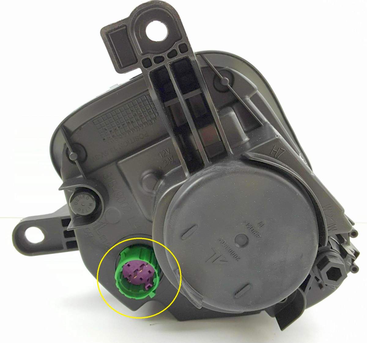

Hello guys,
can anybody here help me with the pin assignment if the DRL/hig beam's connector? So in my opinion the little thicker green one, close to the black one ist for the high beam, black is common ground. But I´m not sure with the thinner green one and the yellow one, which is for DRL and which for position light??

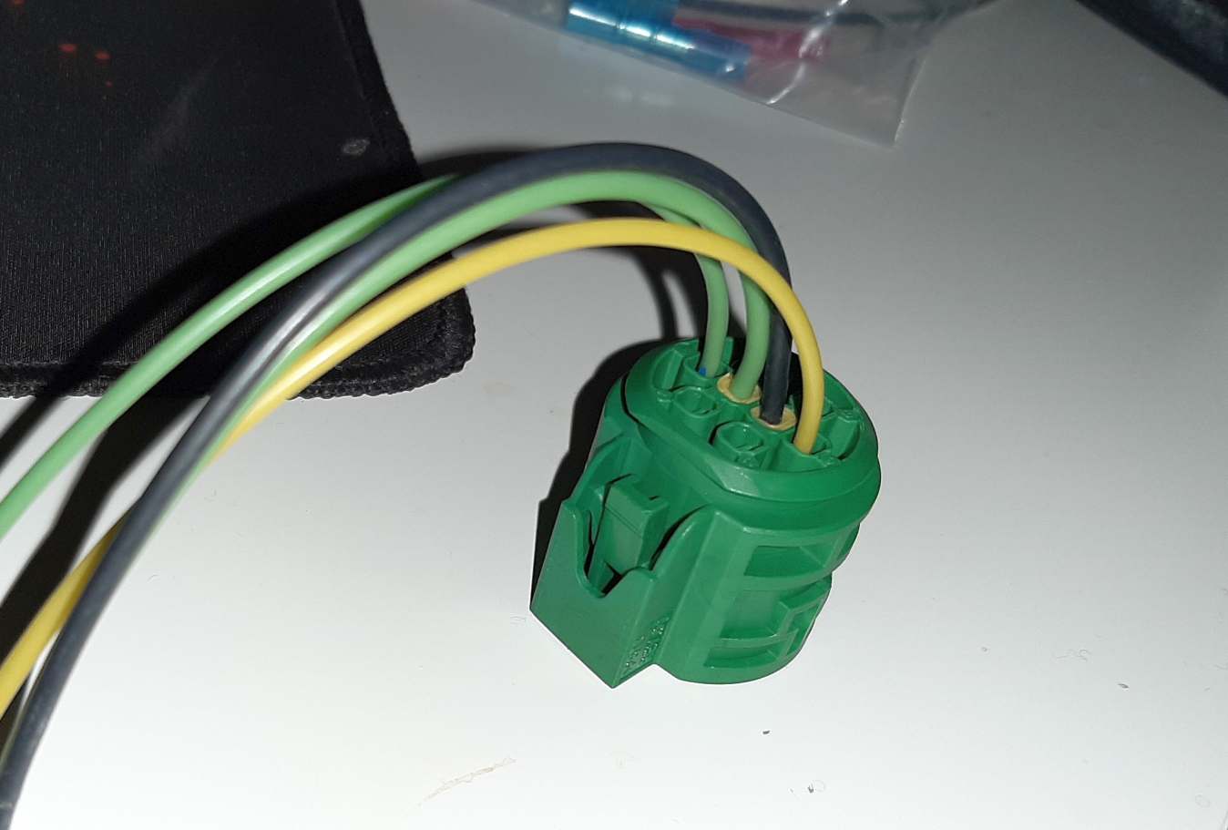

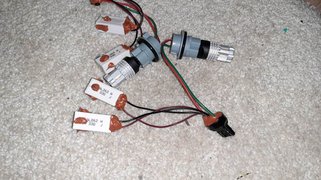

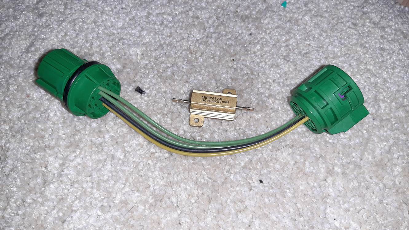

Yes I want fit LEDs for DRL, but I want to be able to remove everything without remains. So no mods to the original wiring harness. First I was trying fit everything inside the beam, but there is not so much space left, as the high beams are already also LED and the resistors became quite hot and I also didn´t wont to cut the rubber cap to keep then outside. In addition the aftermarket 7440 sockets didn´t fit good in the beam...so I went for this solution.

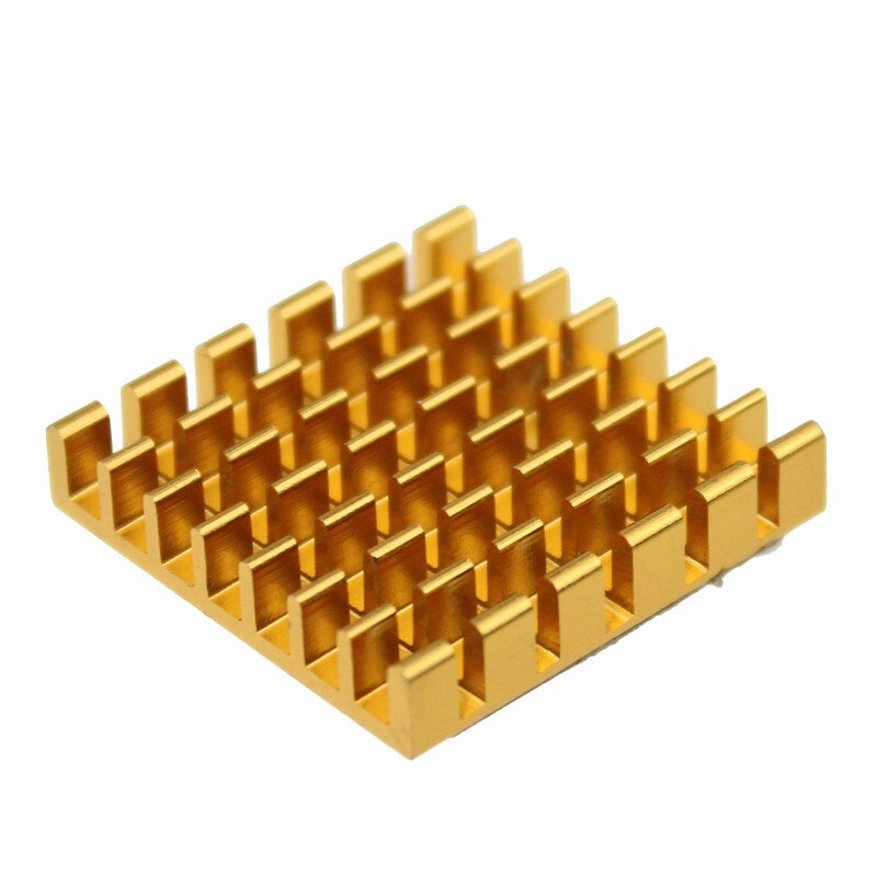

If you use several resistors in parallel then they will not get as hot and are smaller but you have more of them ?
For the "inside solution" I used two 33Ohm / 10W ceramic resistors in parallel. For the adapter cable I will assemble now, one 15Ohm / 25W resistor with metallic housing that is able to handle 12,5W @ 25°C beeing mounted free air.
https://www.vishay.com/docs/30201/rhnh.pdf
Should be enough, but to be on the safe side I will attach a small additional heat sink to it.

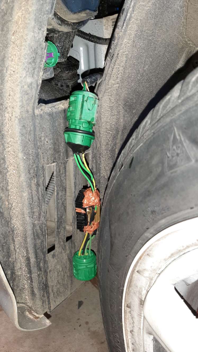

So since today I know, that the Haynes manual is not valid for my car. Is it due to the fact it´s a face lift vehicle (year 2020)? Or is the plan in Haynes manual only for US models? So my colours are different, gren-yellow is DRL, thick green is high beam black ground, and yellow is position light.
But in the end it worked without an error message in the dash.
