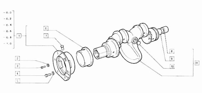

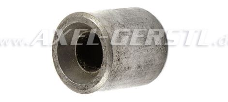

is it possible to post a picture to see what are you talking about?
Here are two pictures. Item 8 is the bushing and it is pressed into the end of the crankshaft. The end of the transmission input shaft runs in this bushing. Both the end of the input shaft and the bushing need to be measured to make sure they are still within spec when you rebuild the engine.
John

When I replaced my modern car clutch recently (I don't recommend that job to anyone!), the kit came with a very small pack of high-temperature grease which was to be smeared along the input shaft. The bushes as above may be sintered steel capable of absorbing oil, but there appears to be a liner of stainless steel. So I think that a tiny bit of lubricant should be applied. Although the bush was well worn on mine, the shaft was fine.
Hi Peter,
There is no SS liner in the pictured bushing or in the one on my car. That is just a machining mark that makes it look that way.
When using the grease packing method you really need to hit the drift hard to create an impact wrench kind of force. This breaks the bond and subsequent blows will slowly work the bushing out. Maybe you could try on a spare crank you might have. I clamped the crank in my bench vise, clamping onto the counter weight.
John[/QUOTE
Thanks for the picture.
