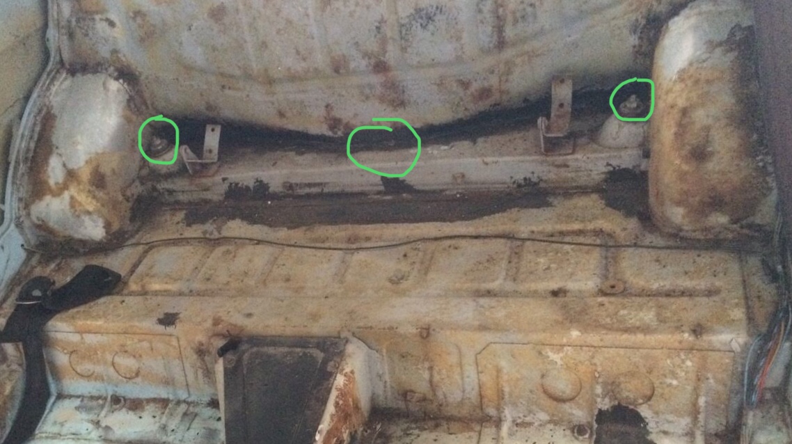

I think I am correct in saying that the square flanges on the underside
should be welded in position.
I tried fitting inertia reel front belts but they seemed to intrude to far into the rear passenger footwell creating problems getting in or out.
I think the factory installed plates are spot-welded in position but this may simply to keep them in position if e.g. the seat belt bolt is removed?
When I fitted seat belts to cars without factory mounting points, (back in the good ol' days
), I typically used either a kit from Britax or (later on) Securon which came with fitting instructions or else followed a similar procedure using made-up or available brackets (as I said, people who do this kind of work tend to accumulate 'spare' brackets/mounting/backing plates).
I never saw any mention of it being necessary to weld the plates in position. But I would agree, it's probably better to weld the backing/load-spreading plates in position, even a tack weld at each corner would make for a more secure installation. Problem is not everyone has access to welding equipment, most probably just want to drill a few holes and bolt the seat belts in position.
Re:- the inertia reel units intruding into the rear passenger footwell?
I've seen some cars which house the inertia reel units behind the trim panels that are behind the 'B' pillars and at each side of the rear seat. I suspect there would be insufficient room to do this on the 500 and it would likely require welding in addition metal to provide mounting locations. Such installations typically used a shaped trim panel to allow the belt to move in/out easily and a cover over the belt slot to prevent chafing of the belt material.
