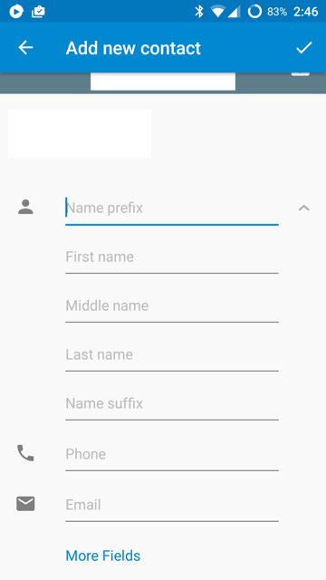

I did a test with a contact I created specifically to test this:
the contact is
A = Name prefix
B = First Name
C = Middle Name
D = Last Name
E = Name Suffix
Display of the Contact as
A = Name Prefix
D = Last Name
B = First Name
C = Middle Name
E = Name Suffix
