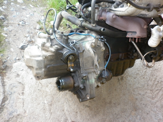

Punto ELX90 also has a 514 box (same as all Puntos) but with bellhousing to mate with 1581 sohc engine, which is related to 128-type Uno engines. And surely the 1581 and derivatives went into many later Fiats, with 514 box, not just Punto GT? I have a good ELX90 one spare, c/w nearly new clutch, which I might be persuaded to part with (Devon).
You'd use mount bracket(s) and driveshafts from a mk.2 FIRE engined Uno.

Im looking for something gearbox wise that will mate up, but not change the driveshaft length at all due to it not being in a uno, and currently having expensive custom driveshafts. It looks like my car had a top bar selector set up (which on mine has been converted to use cables).
Im really struggling to find boxes that are externally the same as the UT mk2.
Can I ask why you need to change the driveshafts if using the elx90, is it a case of just the inner cv's or is it down to a length issue? Mounts and brackets can be custom made so that's not a prob, its just the shaft issue.

For sure the Punto ELX90 does have the 514 mated to 128/Uno-type 1581 block, but maybe that's unique. What about 1581s in later Fiats - did they have Fire-type 514, or Uno-type 510 boxes?
because the ELX90's is a 514 box, requiring mount brackets and driveshafts from a Fire-engine/514-box Uno - your 510-box brackets and driveshafts won't fit the 514.

Think im going down the route of a PGT box now as I can get a cable selector version, and should only need to change the hydraulic fork & arm to a cable one (using parts from my box)..

Checked http://www.automobile-catalog.com and the Stillo at least has the Fire-type 514 box mated to its 1596 128/Uno-type block. So the Punto ELX90 isn't unique.
