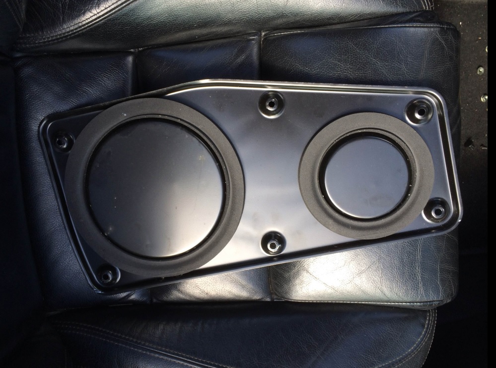

2 weeks ago i rolled the seats up in front, took away the plate behind the seats so i could see the fuel tank.
The main fuel pipe into the tank had a loose clip. Removed it and replaced it with a jubilee clip and the smell is gone.

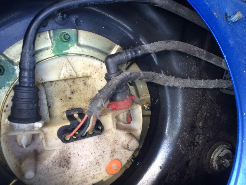

Hi from Ontario,Canada. I just got my B on the road(import from Japan) It shows 21K which seems low for a '98 but it runs mint.I had just filled it with high test to take her for her first decent ride but the cabin gas smell was horrible so out came the seats and back panel.1 hour later I see and feel raw gas lying on top of the tank in the well around the fuel pump housing.Tomorrow the pump comes out and the best Permatex sealant will be used to solve the problem.I was happy to see everything looks to be in good shape, all hoses and clamps seem to be fine. However seals tend to dry out, especially when under used so I'm not supprised.I put silicone grease on the gas cap seal to keep it fresh. Let's hope the smell is gone.
