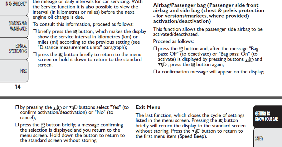

Hi there.
I am hoping that someone can tell me how to deactivate the passenger airbag on my 2013 reg Panda please?
I've scoured the handbook but can't find the answer!
Many thanks
Hi there, I've attached a screen-shot of the page in your handbook that shows how to do this
Thank you all so much. I'd totally missed those pages in the manual!
Panic probably!!!!!!!
I'lltry and sort it at the weekend as Ihave to carry 3 young children next week!
