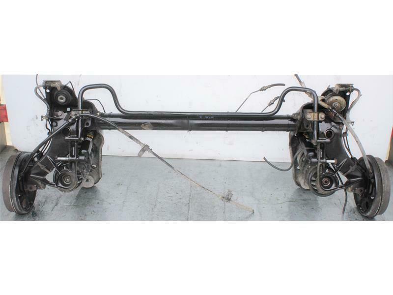

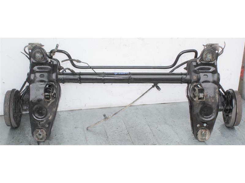

Thanks chaps. Appreciate your help. Didn't realise the mk1 and nose job subframes were the same. On the mot from last year the axle mounts were badly corroded and my garage told me the subframe wouldn't pass this year. Also the axle is corroded
too so thought it wpuld be best just to get the complete assembly. I recieved a reply through firstchoicespares who have sourced one in Germany, 300 quid with three months warranty. They need to confirm it with the chassis number so we'll see
