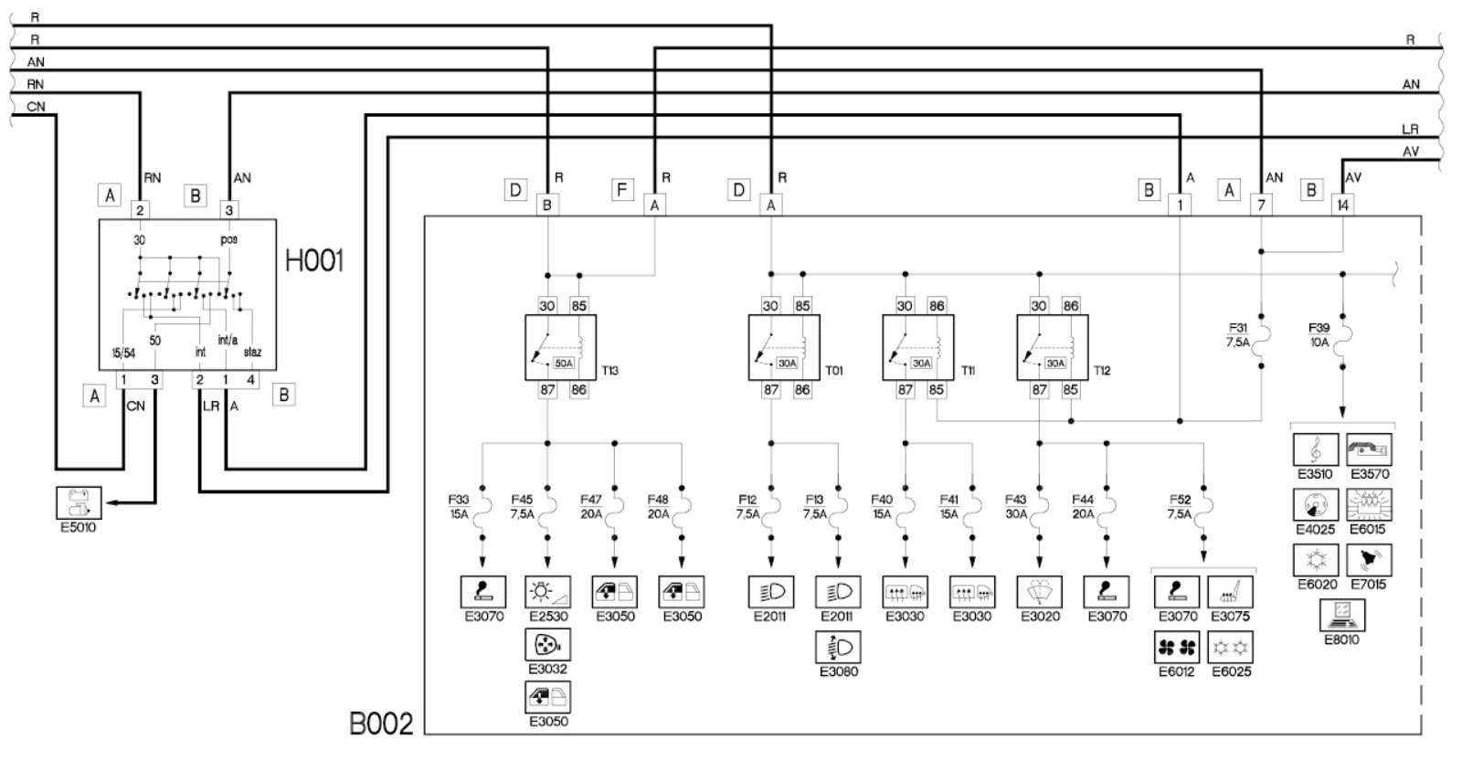

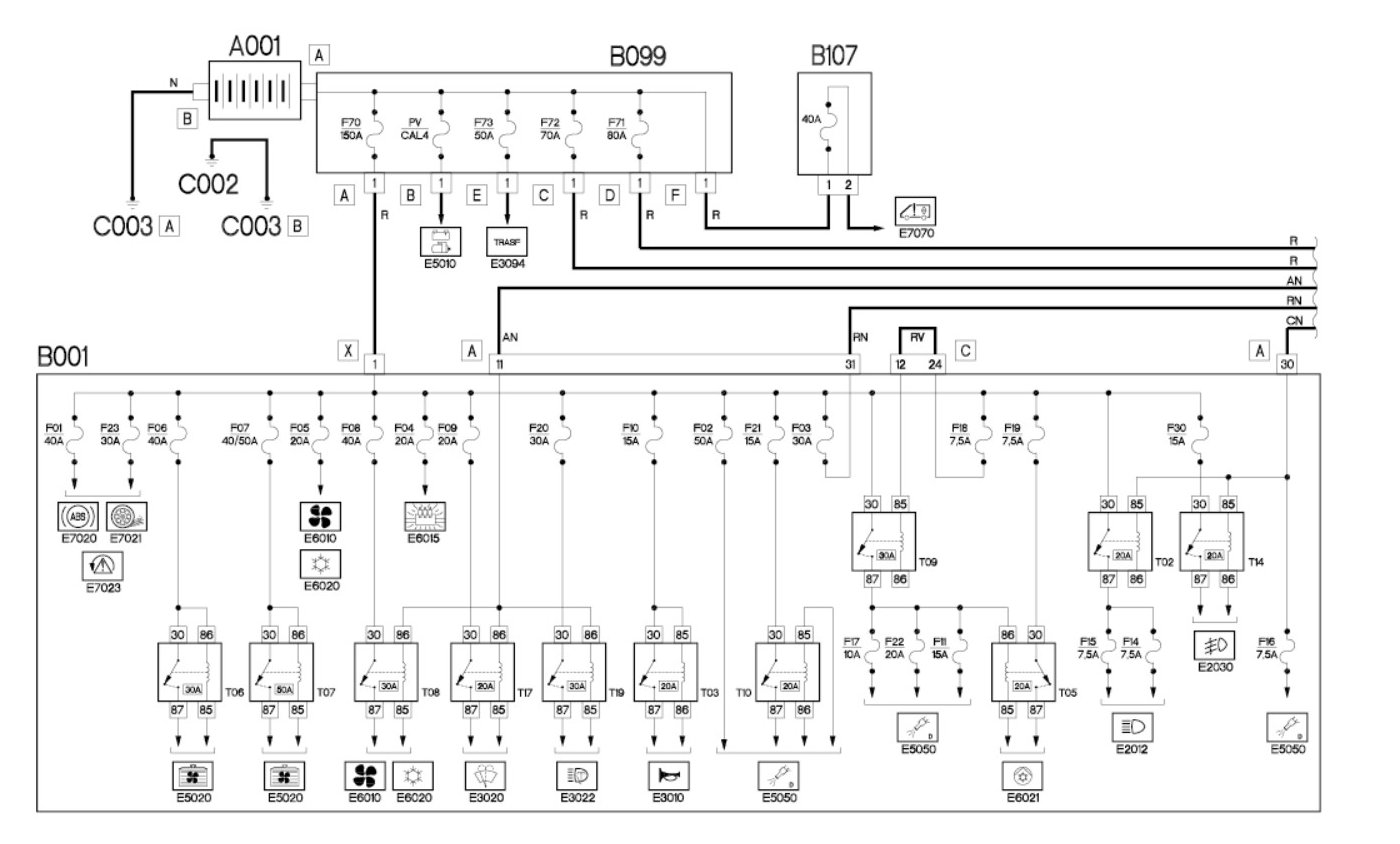

Hi joelew
I have attached a circuit for the X250 main power feeds, it's spread over two pages. The 70 amp fuse near the battery terminal is F72. It supplies power via Relay T13 to four other fuses in the dashboard fuse panel:
F33 for the rear 12 volt socket
F45 for the Power windows controller in the driver's door, the door mirrors and the Instrument Lighting System
F47 for the Driver's window
F48 for the Passenger's window
Relay T13 is only supposed to have its coil energised (i.e. its contacts closed) when the ignition is switched on. You could pull out Relay T13 and see if the current drain stops.
Please bear in mind that electrics are an area where Fiat couldn't resist tinkering over the years, so your vehicle may be slightly different !

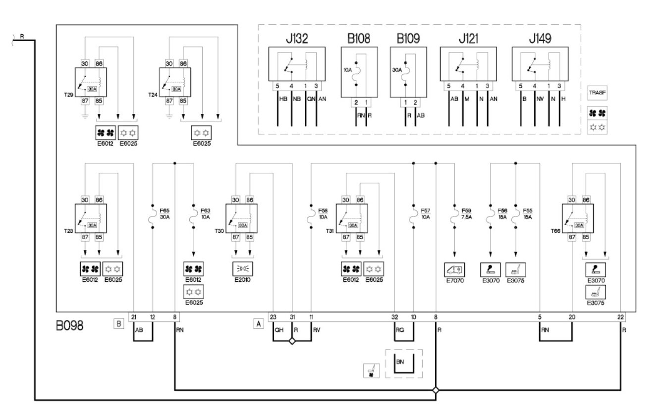

Just to update, Page 4 of the circuit reveals that the Red (R) cable from F72 also feeds:
Relay T30 / Fuse F58 Sidelights
Relay T31 / Fuse F57 Under seat heater
Fuse F59 Self Levelling Suspension
Relay T66 / Fuse F55 and F56 Heated Seats and Rear Passenger Current Outlet
F63 and F65 Passenger Additional Heater
Apart from the sidelights, the other items are options not often fitted to UK vehicles so you may find that the relays and fuses are not fitted.
Just wondering if your vehicle has been modified, and someone has used one of these spare Fuse/Relay positions to "pick up" power for an accessory ?
