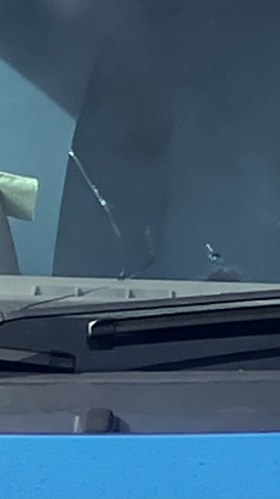

Hi guys, and sorry for the thread resurrection.
We have a 2004 Mk3 Panda that our daughter bought brand new. It's done 111,000 miles now and is a dream to own and drive. We bought it from her in March 2023 at 106,000 miles as a second car.
However there is a crack developing in the front windscreen on the passenger side. I put a dab of felt pen on the inside at the top end of the crack(s) some few weeks ago, and another couple a week or so later ........ and the crack is spreading upwards. The cracks are some six or eight inches up fom the front scuttle at the moment, and no doubt will continue to migrate.
The car is insured TPFT.
No doubt the windscreen isn't included in the cover.
Having been a long-time Mini owner (had lots of them!) and later a Peugeot 205 owner, the 'screens can be done fairly easily DIY.
It seems to me that a 'modern' car has a bonded 'screen rather than one you can pull/push out and refit DIY.
What is the best way to replace the screen?
Can it be done DIY at all?
Thanks,
Mick.

Have to say I'd not attempt a bonded screen myself. These guys make it look so simple - it's not!

You have to grind partway through the windscreen top laminated sheet if glass
Then gently hit with a center punch to create a bulls eye, the crack will stop here
Then you drop some very thin UV resin in and press from the inside to spread the crack move along and compillary action will draw the resin in
It's good but not 100% at certain angles you can still see it
Knowing how deep to grind and how hard to hit takes experience, and you have one shot at it,
Being on the passenger side it should still pass an MOT
A decent windscreen repair should be able to do for a reasonable amount, others only do chips
You can cut them out yourself with a bit of piano wire and a couple of sticks for handles, I cut a glass sunroof out myself to swap to another car as nobody was willing to risk doing it for me
Having said that the proper tools aren't that expensive these days especially on aliexpress
You can save labour by doing some of it yourself and finding a second hand screen, but still probably cheaper to get a mobile fitter to fit rather than buying bond, primer, activator

I do lots of DIY work on my car and think this is one I would leave to a professional. I had mine replaced on the drive a few years ago (on my FC insurance).
The main points for me is that it is a fiddly job and the parts will cost you a good portion of a professional replacement cost.
The saving does not feel worth the hassle, I would focus on finding a good deal to have it replaced instead.
Hi guys,
I called in at or local garage yesterday afternoon and asked them if they replaced windscreens.
Sadly, it was "no" and they suggested I contacted our insurance company.
Just checking our terms and conditions, we aren't covered for windscreen replacement under TPFT, though Fully Comp we would be.
We renewed only in late Mach. They would smell a rat if we re-negotiated for FC and then claimed for a new windscreen.
