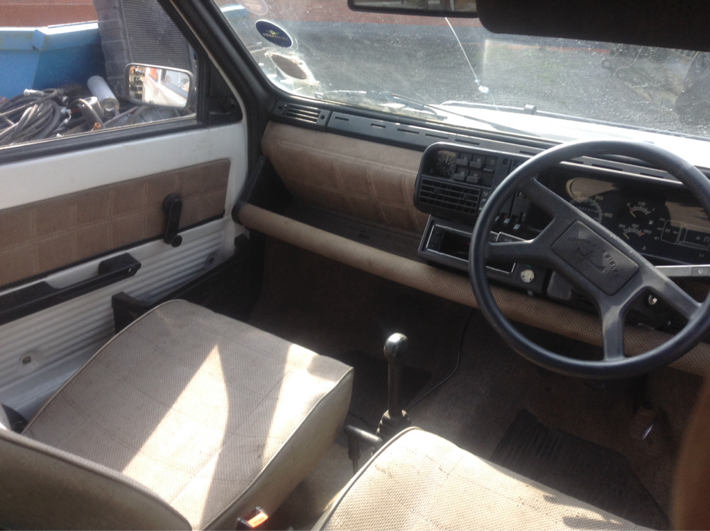

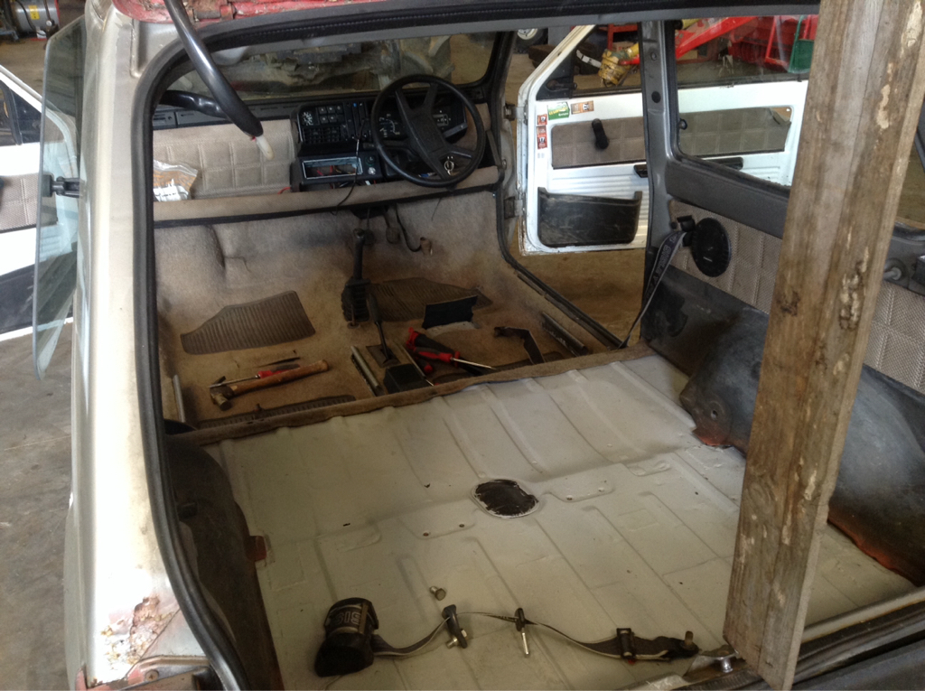

This is my first ever project and hopefully my first car !
ImageUploadedByFIAT Forum1433093706.394014.jpgImageUploadedByFIAT Forum1433093783.398516.jpgImageUploadedByFIAT Forum1433093824.655665.jpgImageUploadedByFIAT Forum1433095196.219468.jpgImageUploadedByFIAT Forum1433095328.891840.jpgImageUploadedByFIAT Forum1433095431.809229.jpg
That was just some of the rust, well enough for my first attempt at welding.
