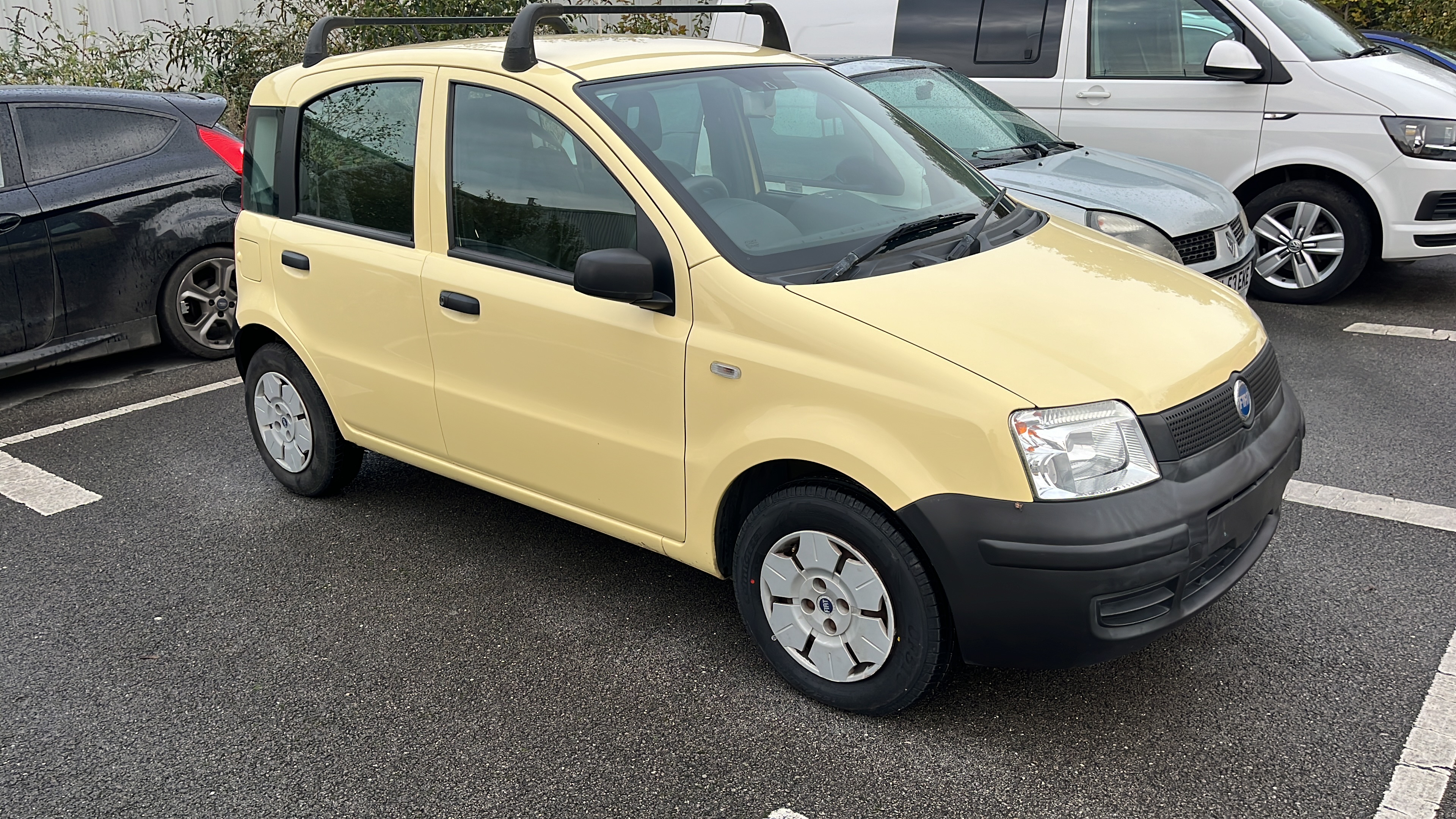

Evening everyone,
Just bought my first Fiat for a daily workhorse/track project hopefully, worked for Audi and Vw for twenty years so instinctively owned German cars. Always had a thing for small Italian and French cars and finally picked up my first non German car, a panda called “pete”
£450 with no mot, just needed a small patch of welding by the Osr sill and 2 tyres
Looking for ideas on potential engine swaps

Hi and welcome :) Pete looks like a smart Mk3 ;) (don't worry - it confuses everyone!)
If rust had got into the sills, I'd also recommend checking the following rust spots:
  • rear axle spring pans
  • rear bump stop turrets
  • shock absorbers & springs
  • mud trap behind front springs
  • brakes (build-up of rust on sliding surfaces of front calipers & inside of rear drums)
  • coolant return pipe across front of engine
  • engine sump pan
  • exhaust bracket below cat
The main body is galvanised, so hopefully rust shouldn't be too much of a concern.
Check the 'duckbill' scuttle drains below the wipers are clear - they block easily.
Monitor tyre wear - Pandas can be surprisingly heavy on tyres.
Might be worth cleaning the negative terminal and earth strap connection on body under battery - weak earth can cause all kinds of issues, especially in winter.
Other than that, they're great little cars, tough, capable and reliable. I hope you enjoy it:)
