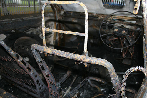

I'm surprised that it is possible to take it off...
I spent all day and I coundn't :)
