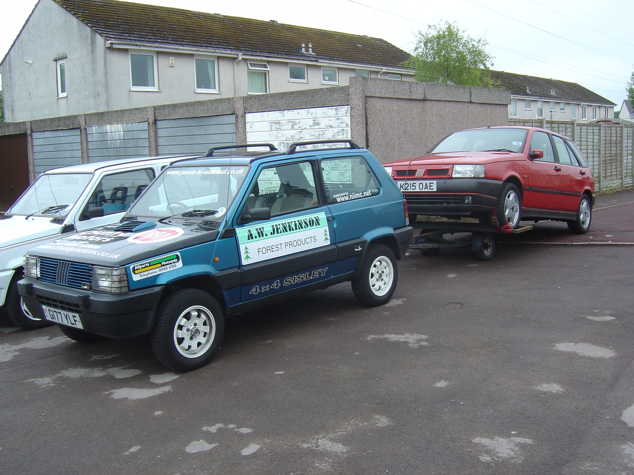

Alan has the info for you...
https://www.fiatforum.com/panda-classic/144931-what-can-tow.html?p=1524466
Think if you can strip that weight down you'd be legal with a braked dolly.
